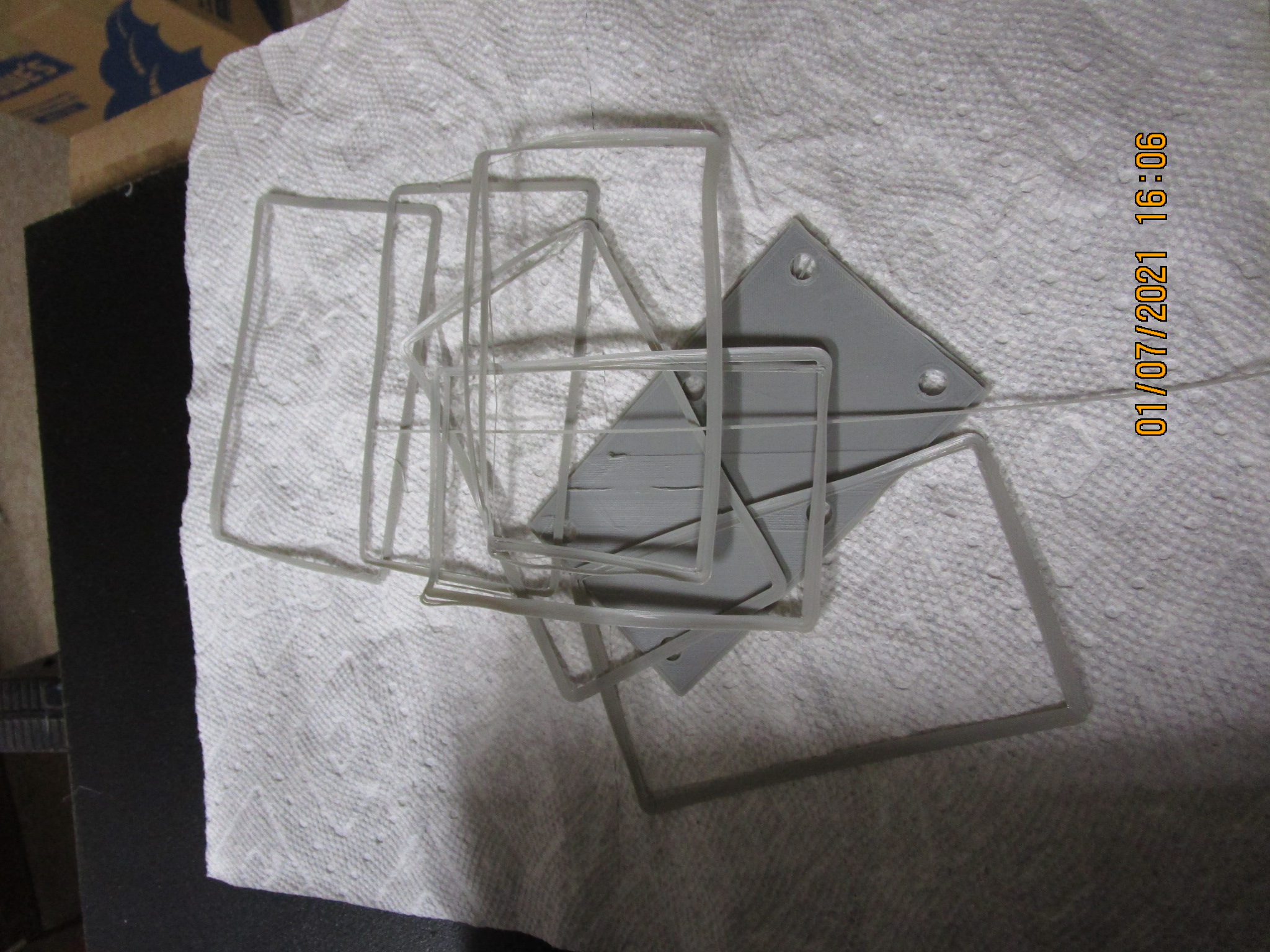

I am using the grey Sovol 1.75mm filament I bought with the printer. I have had real tough time getting it to print all all today.
I have made 5-6 attempts at printing the same part I have printed successfully 5 times before. I am getting no surface adhesion
on the first layer and more stringiness than before. I ended up raising the bed temp 5C and increasing the Z offset which I have
not had to change since new? Waiting to see what attempt 6 looks like?

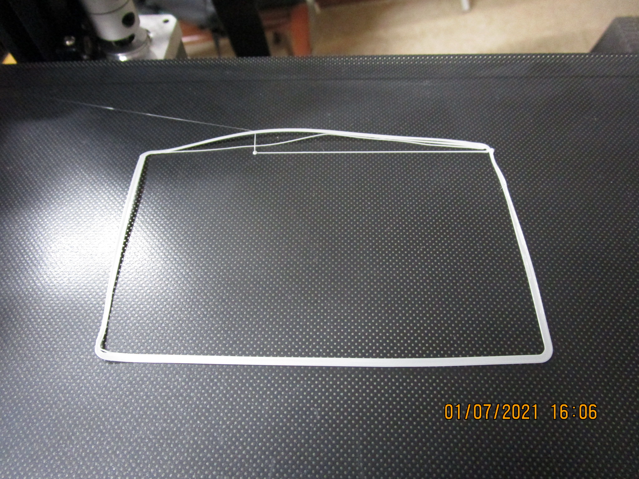

Re: Need help with surface finish on a mold piece
Here is my day in a nut shell. 6 attempts at printing the same part. No first layer adhesion with a brim, or not. What gives?
There are many things that can cause problems with first layer adhesion
Let me name off a few..
Bed not clean (use rubbing alcohol)
Bed not level/nozzle too close/too far. There are many tutorials out there but remember you want the material to go on slightly rounded and not totally flattened out.
Wrong material temperature. If you do some temperature towers, those will demonstrate the best print range for your particular filament. People tend to downplay this and just give it a go at their best guess. I've started doing this a few months ago and it has been very enlightening. Even different colors of the same material can have vastly different results.
Flow Rate/ Extrusion multiplier There are many tutorials on this but after you know the sweet spot for your material temperature, I run one of these. After measuring and doing a few of these, I know my flow is right.
If you get wavy ripples on your first layer, it can indicate you are either too close, too warm or both.
I know this might sound wasteful but I usually chuck the included filament included in the inexpensive printers. I suggest using good, brand name stuff versus the "absolute cheapest I could find online". You wouldn't put cheap gas in a Lamborghini! If you want good results , versus dozens of attempts, use good filament. I like Zyltech, Colorfabb, Hatchbox and PrintedSolid has their Uncle Jessy brand that they make in house.
