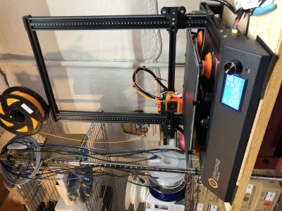

The machine came from Amazon and it’s print volume is what we are all used to, with CR-10 clones. 300 x 300 x 400. It’s got the usual Bowden extruder setup and generic hot end. What really peaked my interest was my friend shared they come with Trinamic 2208 stepper drivers. It should be a pretty silent machine.
Setup was fairly simple. The instructions were a little vague in the details but if this is you second...or in my case...8th printer...you kinda figure it out.
The power supply is separate of the machine, with the controller built into the printer. This setup had me wondering when I saw the photos. But now that it is here and set up, it makes fitting the printer into a smaller spot so easy.

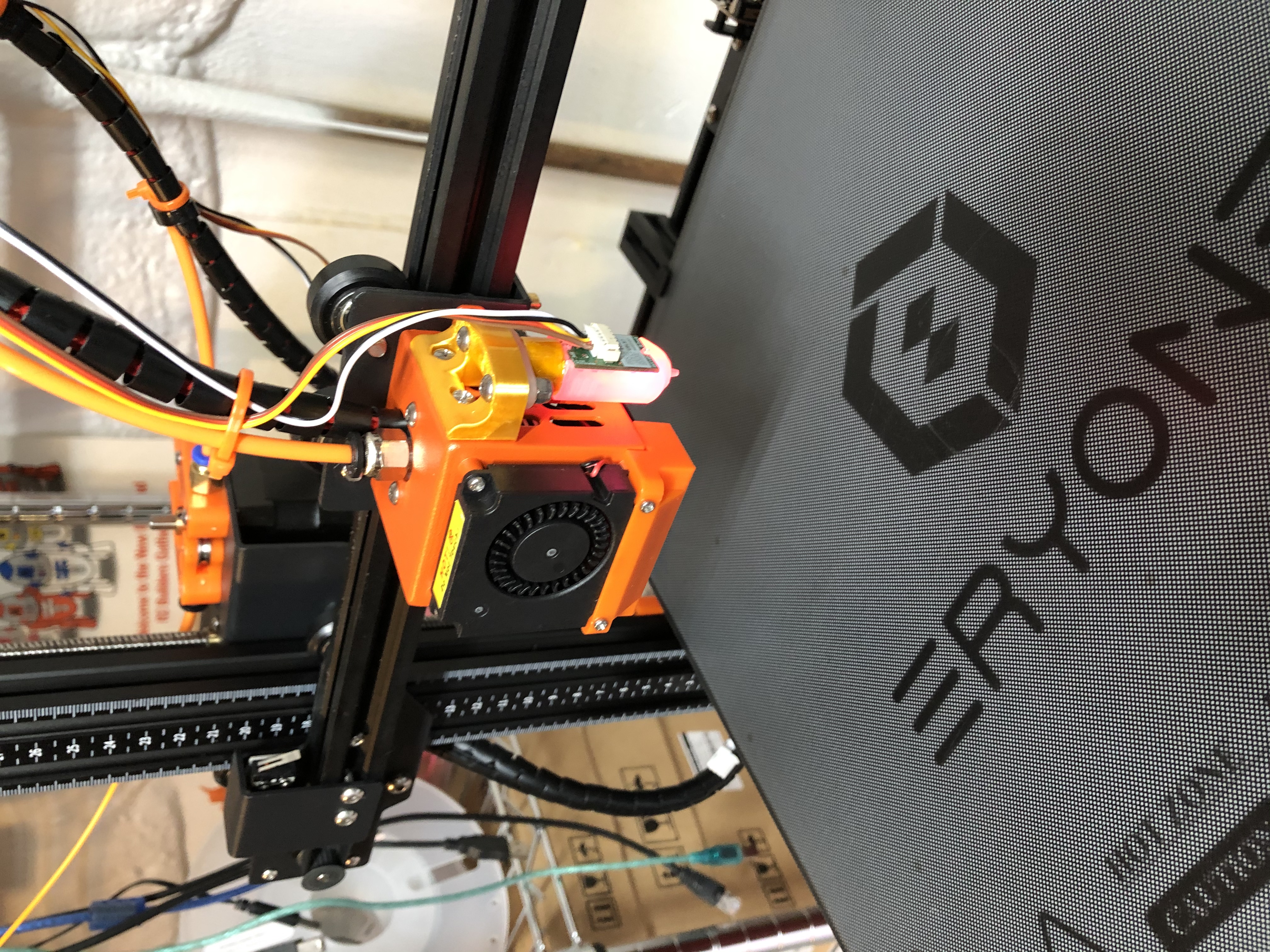

Another neat perk is near the extruder motor mount, they have a pre wired jack for a BL touch to plug into. I installed one and after figuring out which pins I had to move on my BL Connector, it was super easy to setup.

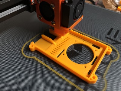

Print quality is very good. No salmon skin! And the only thing you hear is the whisper of the hot end fan. It’s almost too good to be true.
