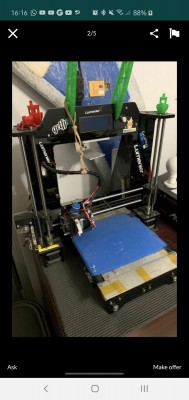

I recently purchased an used 3D printer. I do not know much about 3DP and I am excited but struggling to make sense of everything.

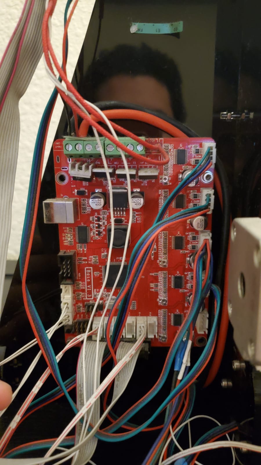

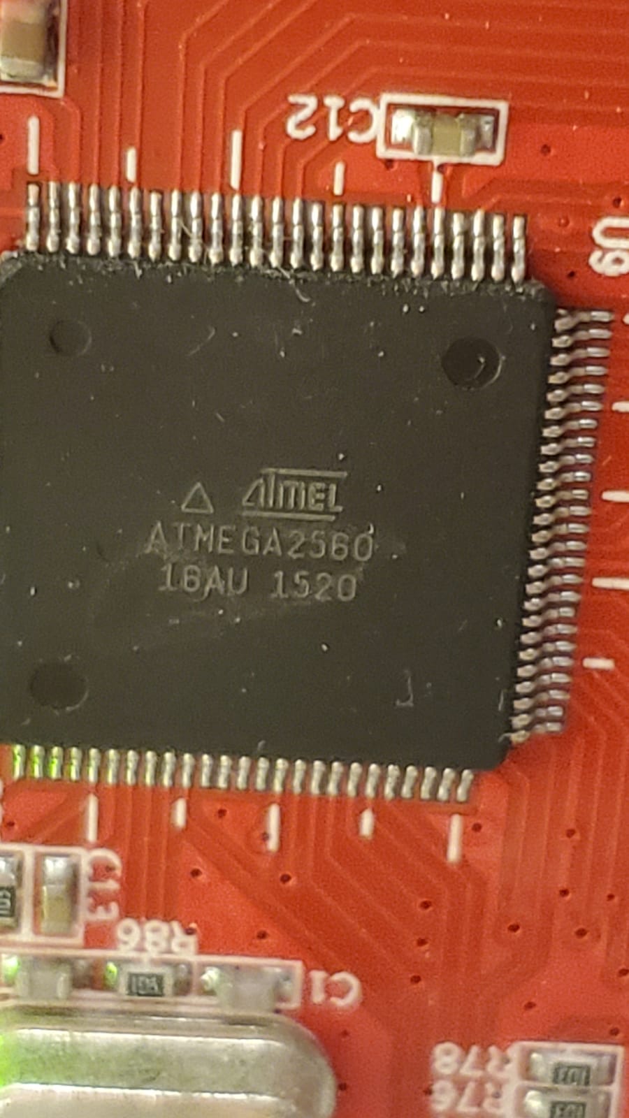

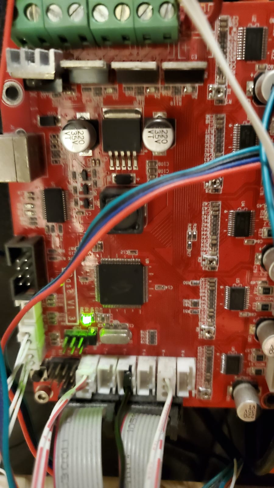

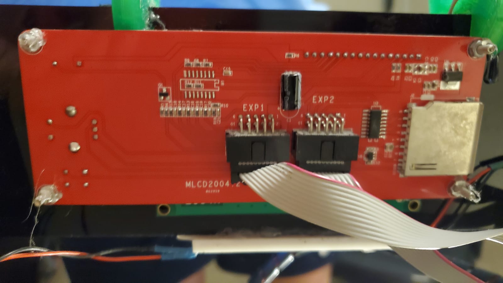

My first issue is with identifying the printer, the person who sold this to me told me it was a Hictop Prusa i3, but he was not sure.... Doing a little digging I believe this is true. I will attach pictures of the boards for confirmation.

I do not know what firmware to download and the ones I have tried do not allow me to control the LCD and I have encountered so far the following:
  • I have run into 2 lines of squares
  • The whole LCD full of squares
  • Only the back light
  • Stuck on the main screen with Hictop Website
  • Stuck on the main screen with rep rap
  • Black screen with continues beeping sound
  • Back light with beeping sound after pressing encoder
  • And the latest problem I faced is a strange one.. the back light its lit, when I rotate the encoder, the main screen comes on and then back to only the back light on an endless loop

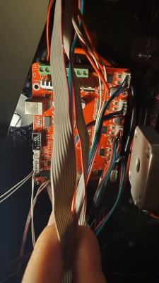

Some pictures of the whole printer for reference as well.

Looks like a Hictop 3DP-18, I think. Very similar to my 3DP-17, except using the acrylic frame instead of the 2020 aluminum (was a cost savings measure I think). @Roberts_Clif is the local expert on Hictop and Marlin firmware. He would be the best one to get the latest firmware from. You might poke around here a bit, I believe he has posted versions before.

It appears that you have a Hictop Prusa i3 3DP08 or 3DP18 acrylic. With 3D Printed Filament Spool Supports.
When you select the 3DP18 Manual the 3DP08 Manual is shown.
Firmware located Here
Users Manual located here

By the dimensons it looks like its the 3DP08. I was able to load the firmware into the printer, now I am facing a problem with the auto home setting.. When I select auto home in the LCD menu, it starts the process, but sometimes, not always, when the X axis hits the limit switch, it gets stuck and the printer starts to shake and make loud noises. Some of the times it happens on the X axis some other times on the Y axis.. Any ideas why this would happen ?
