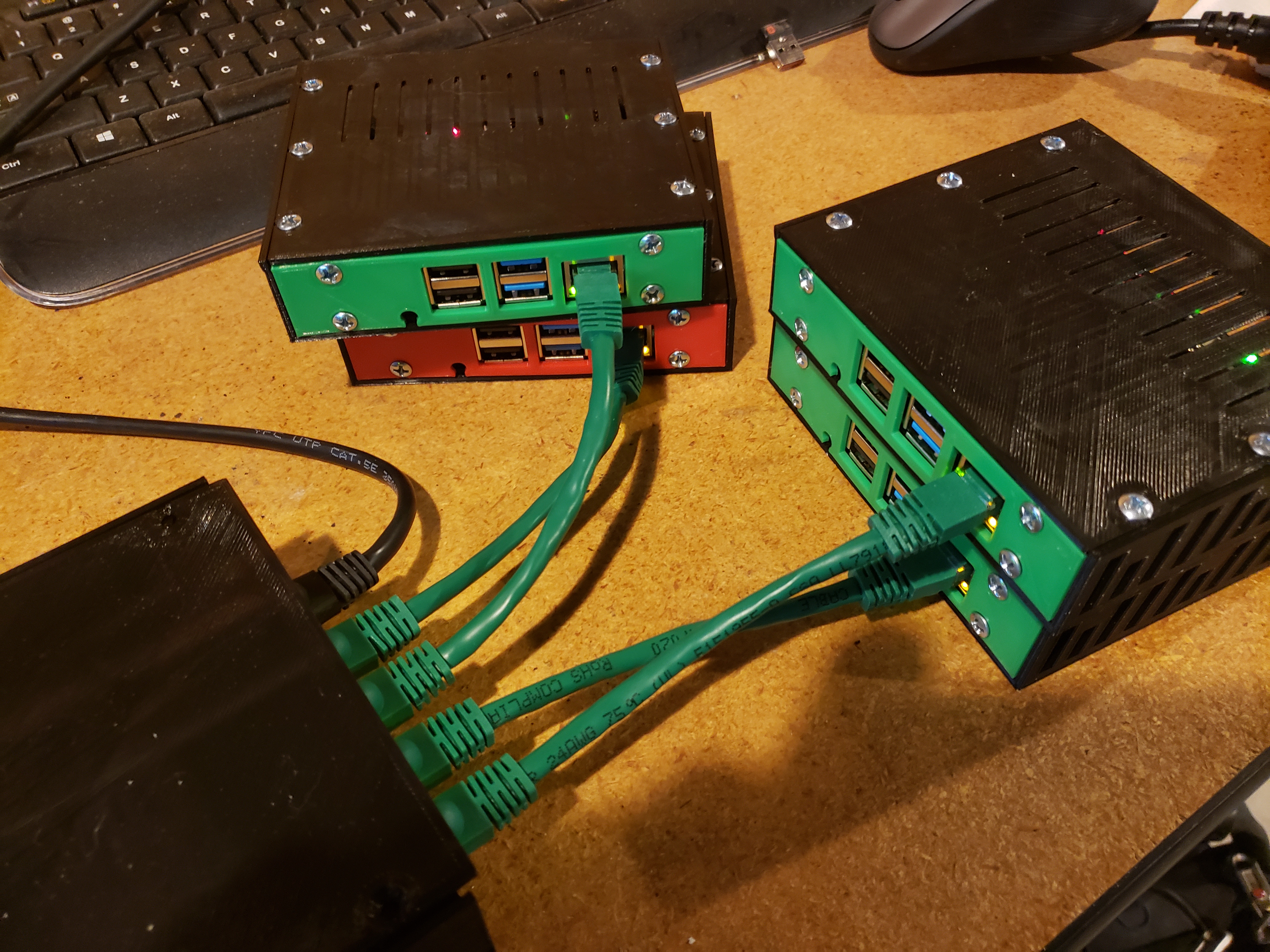

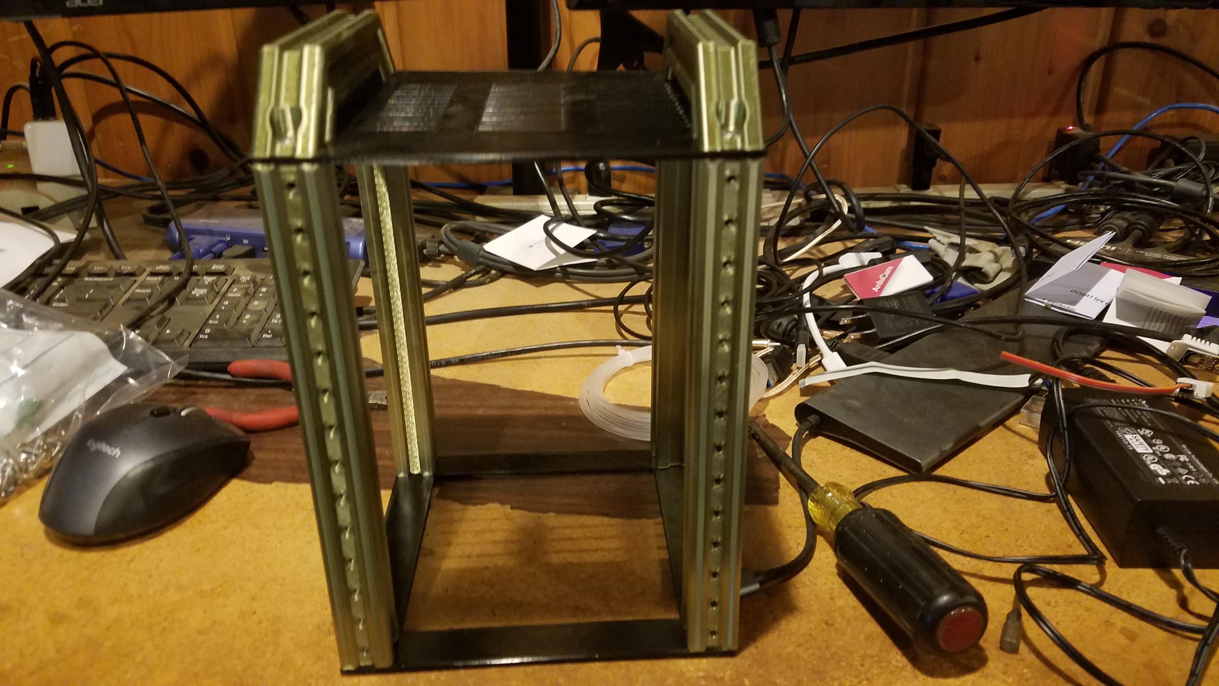

So, I have a RPI Kubernetes cluster now. Built as a learning tool for work. 4 systems, using Raspberry PI 4B 2G systems, Power Over Ethernet (POE) Hats for each, and a 5 port 1G POE switch. All cases and the rack they're going in were 3D printed over a few days on my CR-10S.
I'm still working out a cooling solution. I currently have a USB desk fan blowing over them, which keeps them at 33C, but with only passive heatsinks, they will run between 75C-79C. I need to design a housing for a 20mm fan, then come up with a power solution for the fans. I have a few ideas, though.

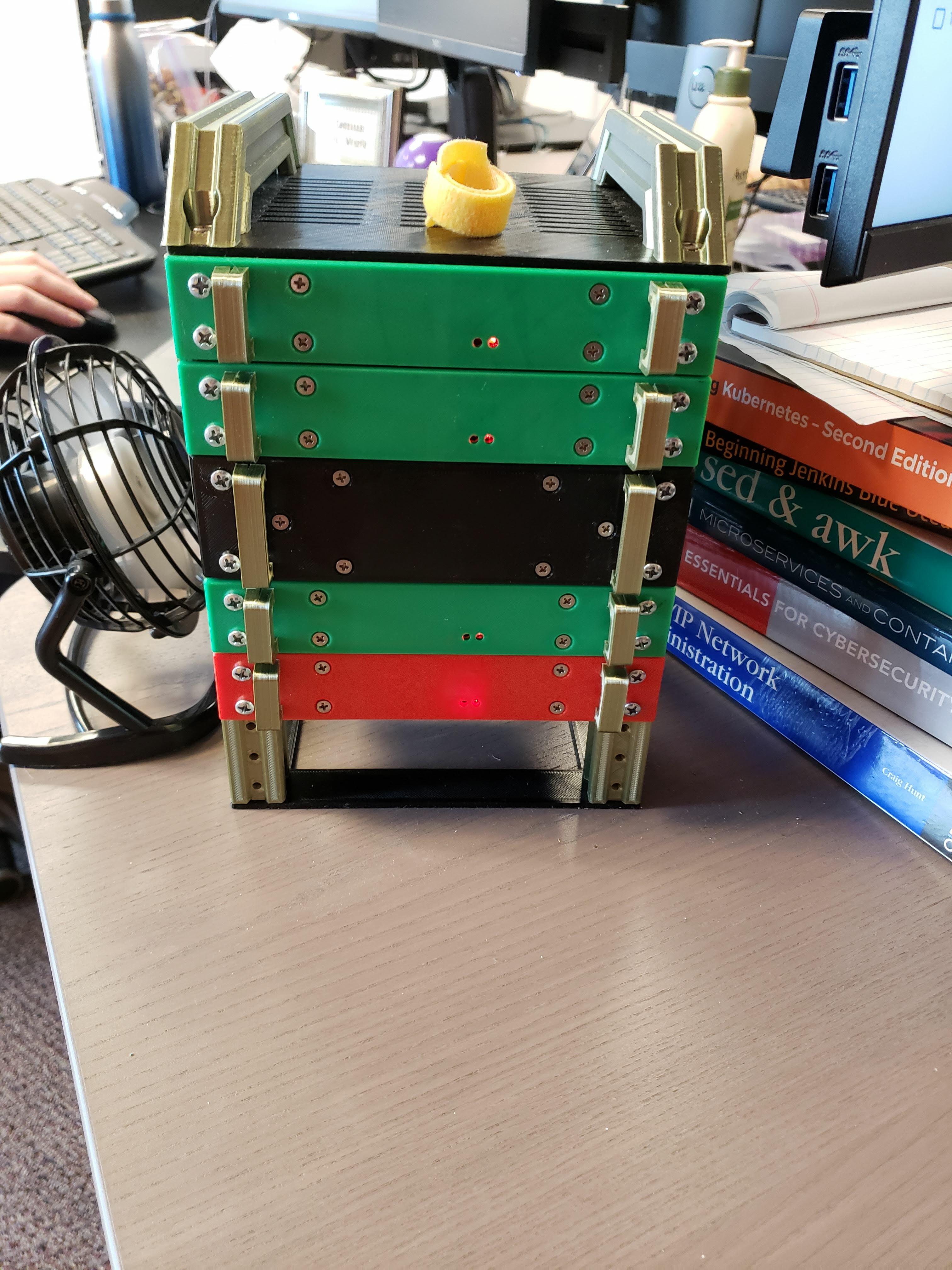

The red box is the cluster master, the green boxes are the slaves (or whatever is PC these days), and the black box is the 5 port POE switch. The fan is a USB powered desk fan and it keeps the entire rack cool enough.
