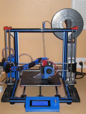

I remember back when my 3D Printers looked just like that.
I have two of the same, well almost I have a 3DP11 and a 3DP12 that have been modified from original threw
most Marlin 1.1.x and have them on Marlin 2.0.x
I have Added color and changed the LCD mounting placing the LCD off the front T-Slot.
I have changed the proximity Sensor SN04 to a low profile TL-W3MC2.
Other than these simple changes they are still Hictop 3DP11/12 machines.
Then moving filament spool off 3D Printer and onto the back panel of the environmental chamber.
Need any help with any just post your questions? we will be here to help you with your 3D Printer.

- Posts: 74
Re: Where Do I Start?
They do you credit love the colour schemes!

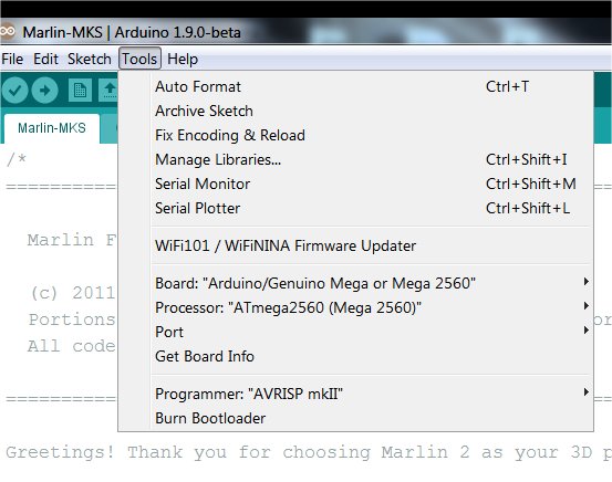

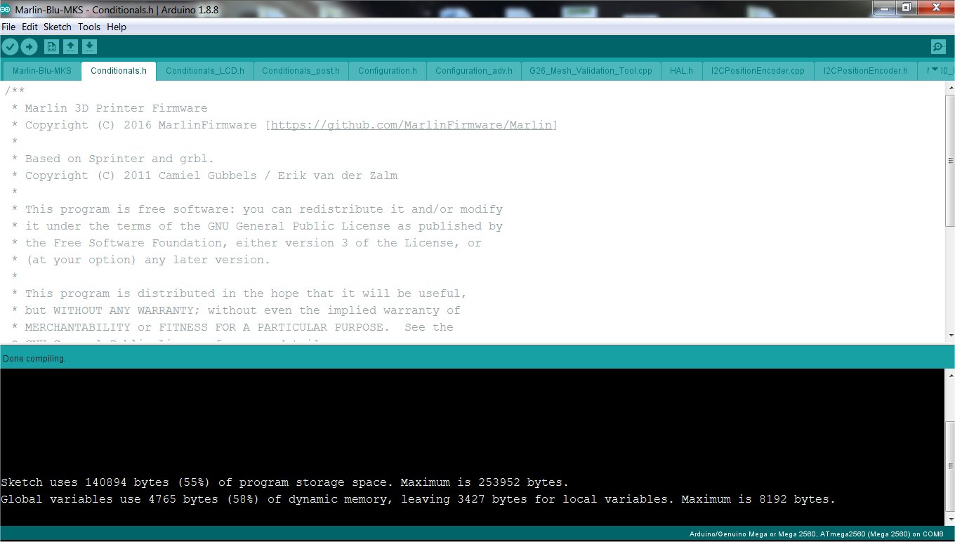

- Posts: 1381
A picture is worth a thousand words.
Using Arduino 1.6.8 or higher (" Was showing the lowest version of Arduino to successfully Compile ") load Marlin.
Setup as per image below
" Board: Arduino/Genuino Mega or Mega 2560 "
" Processor:ATmega2560(Mega2560) "
Compile with no errors
Plug 3D Printer into Computer
Select Port of 3D Printer and upload. Firmware
This will take a few minutes so be patient, When upload is complete 3D Printer will reboot.
Load Cura enter terminal mode
Send M502 ;Reload Factory
Send M500 ;Save Settings
You should be set.
However do not like to take shortcuts, Watch the Video
Do not take flashing any device lightly. most mistakes can be forgiving and correctly re-flashed.
Remember that this needs to be done correctly, major mistakes can disable or even kill your controller.
A major mistake can be as simple as a power failure during a flash, always use a laptop computer or
A computer on a UPS battery Backup system with sufficient backup time to finish the flash.
