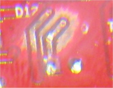

I had a defective trace which was easy to troubleshoot, but harder to find the actual defective trace.
It required looking at the trace under a magnifying glass until seeing a tiny wave in the silk screen then erasing the silkscreen material revealing the broken trace.
