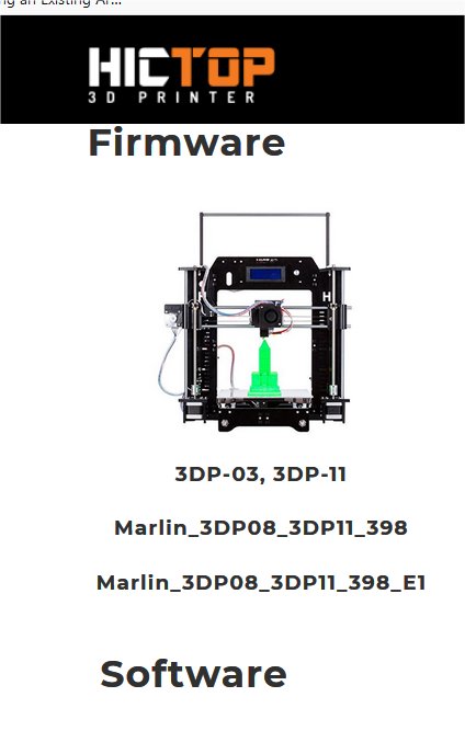

- Posts: 1382
Re: Firmware for Hictop 3DP08
You miss understood.
Marlin_3DP08_3DP11_398___E1 Is not a hex file Contents of file.
This is Hictop web Link
https://www.hic3dprinter.com/pages/firmware
Select bottom download

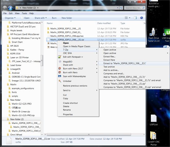

OK, by watching the video my Arduino screen looks just like the one in the video. But I still can't find the .ino file to open.
I only get and .rar file when I download the Marlin firmware.
- Posts: 1382
You have never opened a RAR or ZIP file
Download Rar Extractor 7-Zip Install program right click RAR file extract to Folder.

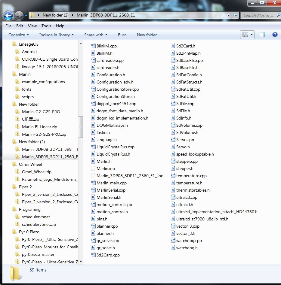

Well I think I'm making some progress.
I have the file opened in Arduino. But, I don't have the tabs across the top.
I only have 2 tabs across the top: sketch_apr13b and Marlin_3DP08_3DP11_398_E1_
Any suggestions?
Thanks for your patience with me. As you can tell by now, I've never done any of this before.
Any suggestions?
- Posts: 1382
This is OK We all have to learn.
An we learn sometimes from sources that we would have never thought possible...
OK. Question did it give you an error when loading the Marlin_3DP08_3DP11_398___E1_.ino
Is the .ino file in a directory that look like this " Marlin_3DP08_3DP11_398___E1_\Marlin_3DP08_3DP11_398___E1_.ino "
If the directory name has been changed or the filename has been changed it will not open it correctly...
