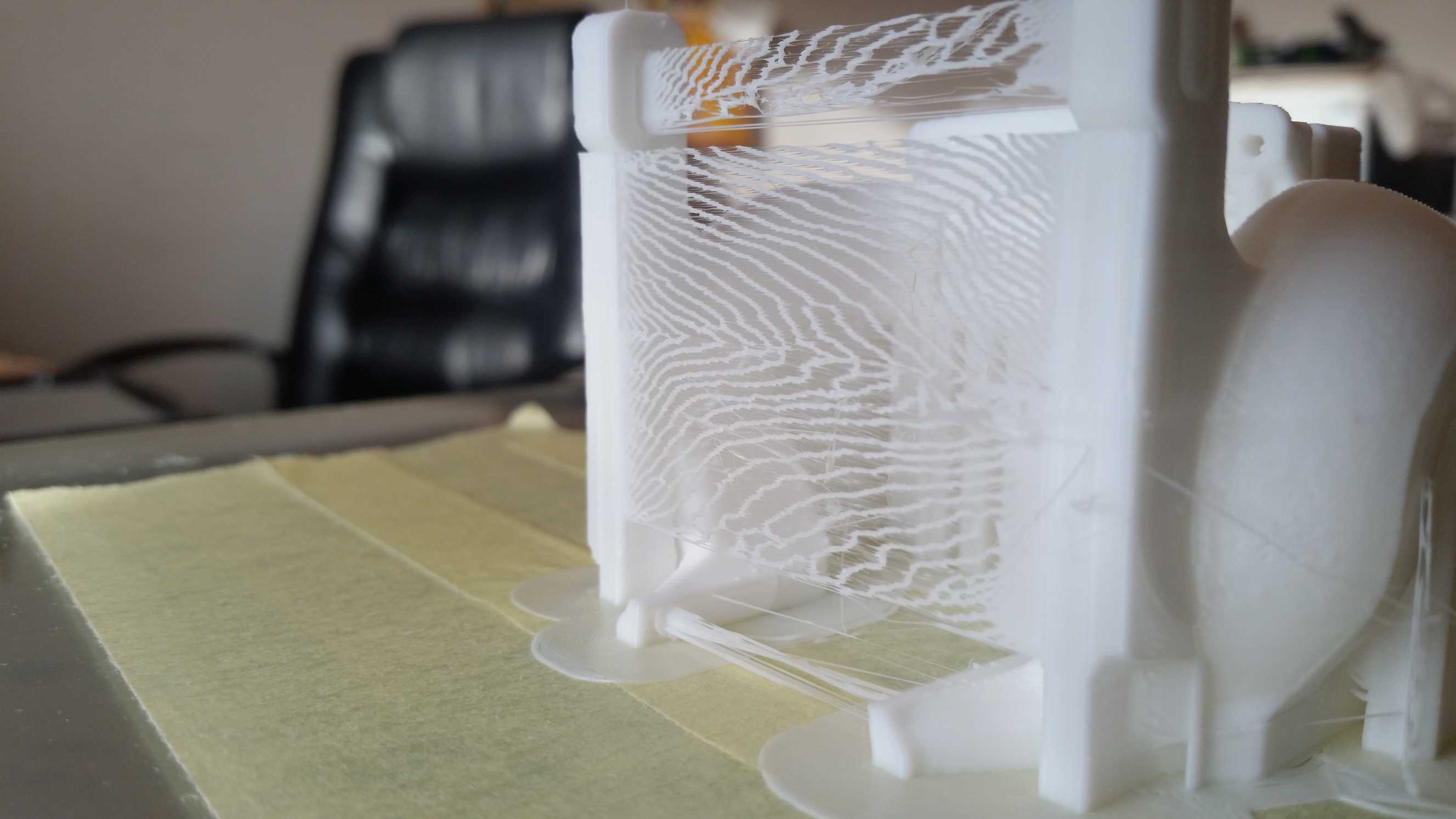

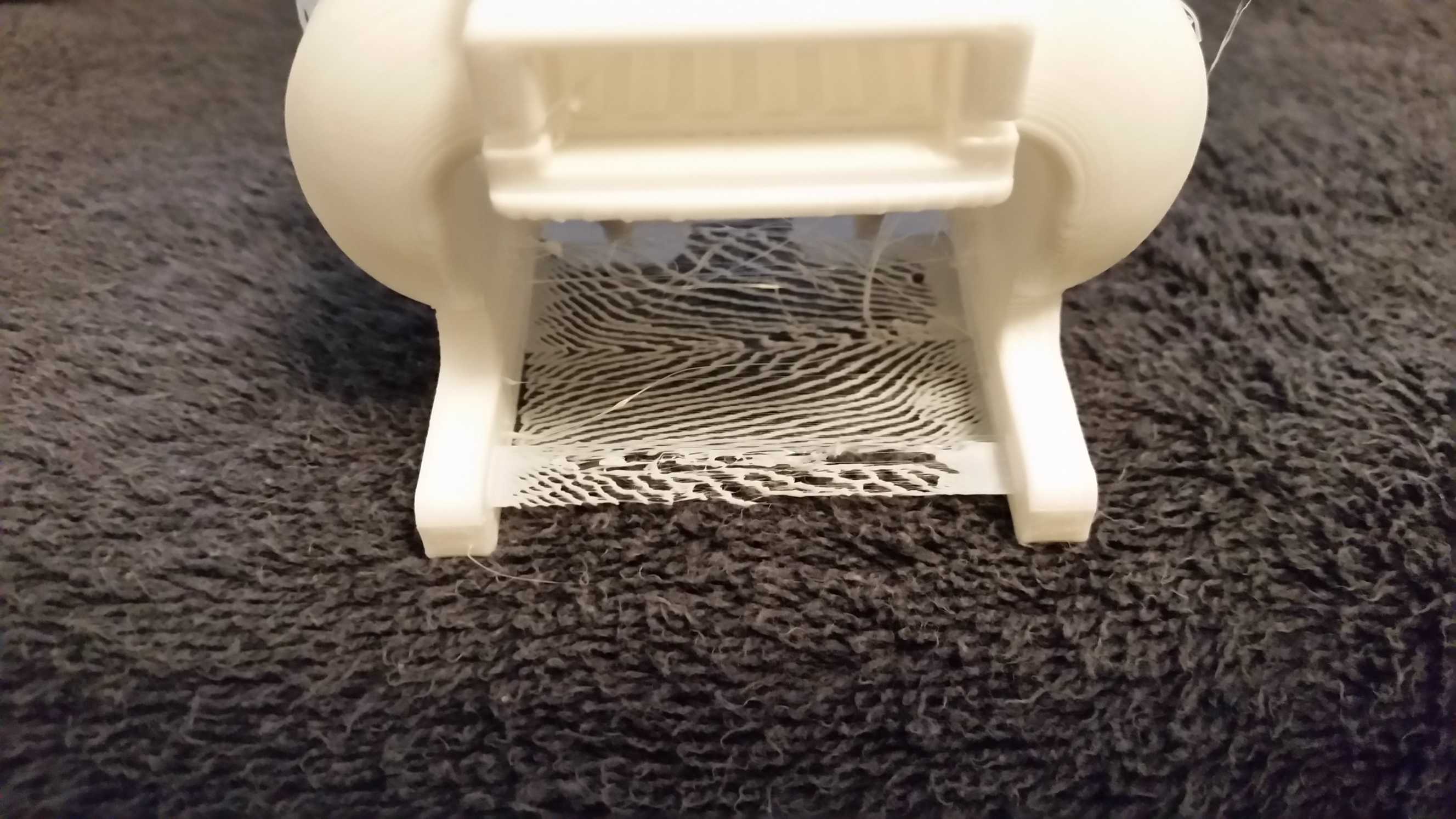

I've recently started printing with a CR-10S, and in general the prints come out well and after a little cleanup they look fine.
Still, I'm seeing some stringing and I'm wondering what the best way to minimize or eliminate it is. I've attached a few example pictures to show the problem. Again, the prints are coming out okay for the most part, but I'd like to get rid of the stringing.

What are the typical causes of stringing, and what steps can I take to reduce or eliminate it?

First, if you havent already, do a PID autotune
Stringing is going to be one of two things...or a little of both...temperature or retraction.

You may also need to do this test on a variety of different filaments. Most basic filaments from the same brand (different colors from Hatchbox for example) will use the same or close to the same settings, but other filaments (like Hatchbox wood filament) will need very different settings. I recently printed a Groot pencil holder to hold wooden stir sticks next to the Keureg at our work. When it was done, it looked like he was in a cobweb. Easy enough to clean up, but ...
Re: Print issues: stringing
Yeah wood filaments are notoriously stringy
As is PETG
Each filament does require some fine tuning.
As is PETG

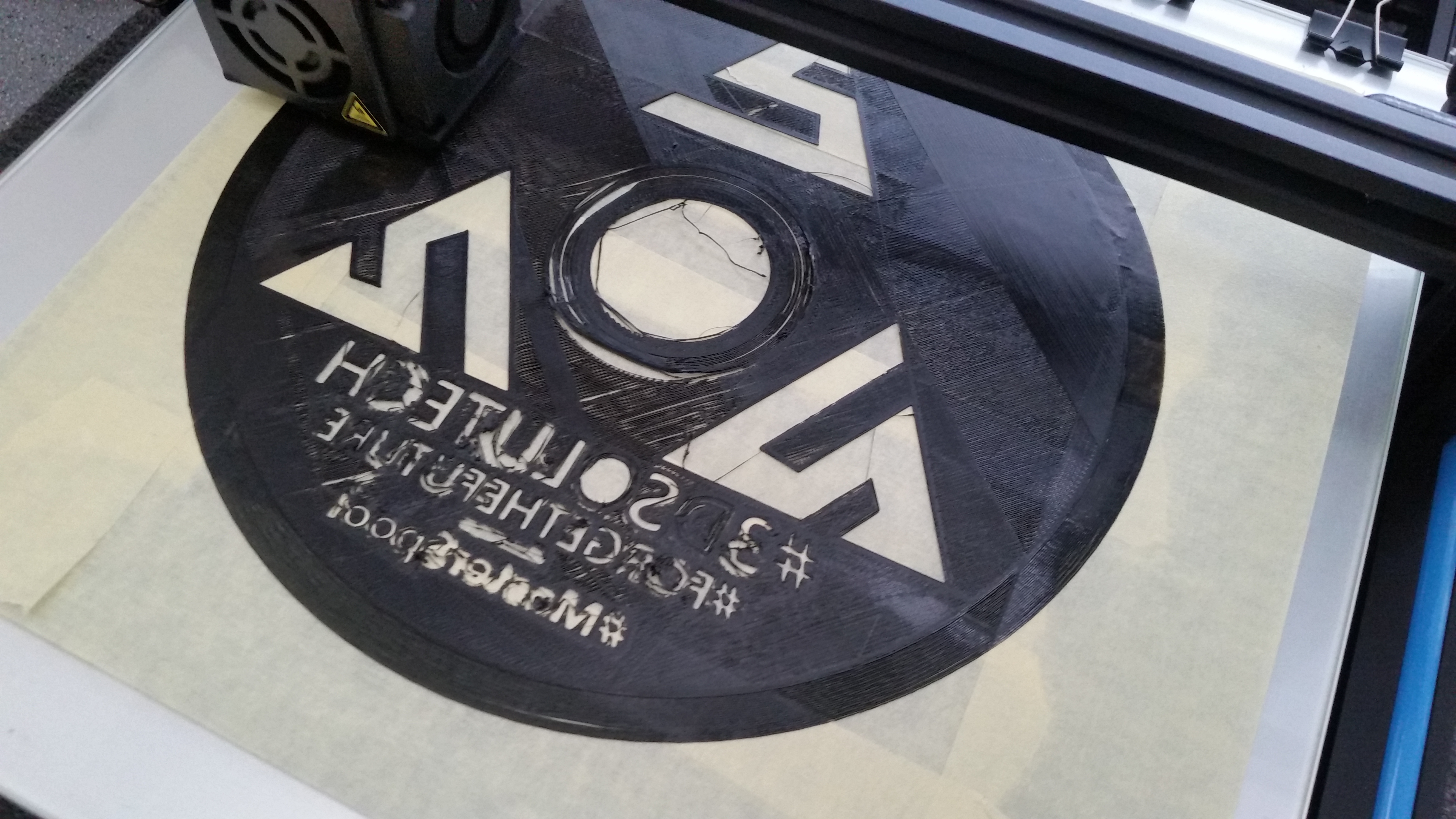

I'm trying to print a master spool file provided by Solutech (3dsolutech.com/portfolio/project/3d-solutech-master-spool).
The filament is 3D Solutech Real Grey PLA (amazon.com/gp/product/B07G27L498/)
The nozzle is set to 200 degrees and the bed is at 60 degrees.
Here's what I'm seeing- some odd build up of plastic, and some areas where it looks like it's pulling away or shrinking.
Is this a bed adhesion issue, or? Straight areas print beautifully but smaller shapes produce a kind of build up, and some areas seem to be shrinking (like in the picture- see the center circle where it looks like the nozzle took a shortcut or the filament shrunk).
The bed is level; the first thing it drew was a large circle, and it made a perfect print- a nice even bead, good adhesion, looked perfect. But when it got to the area where they've stamped their name, it starts to produce the build up. It doesn't really look like stringing but maybe it's a bunch of strings getting all clumped together?

Well that was disappointing.
It looked like it had managed to correct itself and the print was coming out looking pretty good...and then about 6 hours into it it just started spewing filament here and there and everywhere. Ugh. Booooo.
Still no idea what's causing the defects shown in the image.
