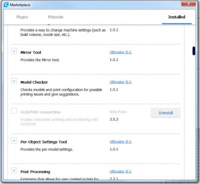

Installed Cura 4.0.0
When you Click on the marketplace you only have one plugin available for install at present.
So I tried to manually install, the plugin does show up in marketplace though does not operate.
The only option available is uninstall. As both printers are in another room, my only connection to them is OctoPrint.
Ultimaker Community is aware of the problems and expect Cura 4.0 beta 2 to have a fix
There are some plugins that work here
