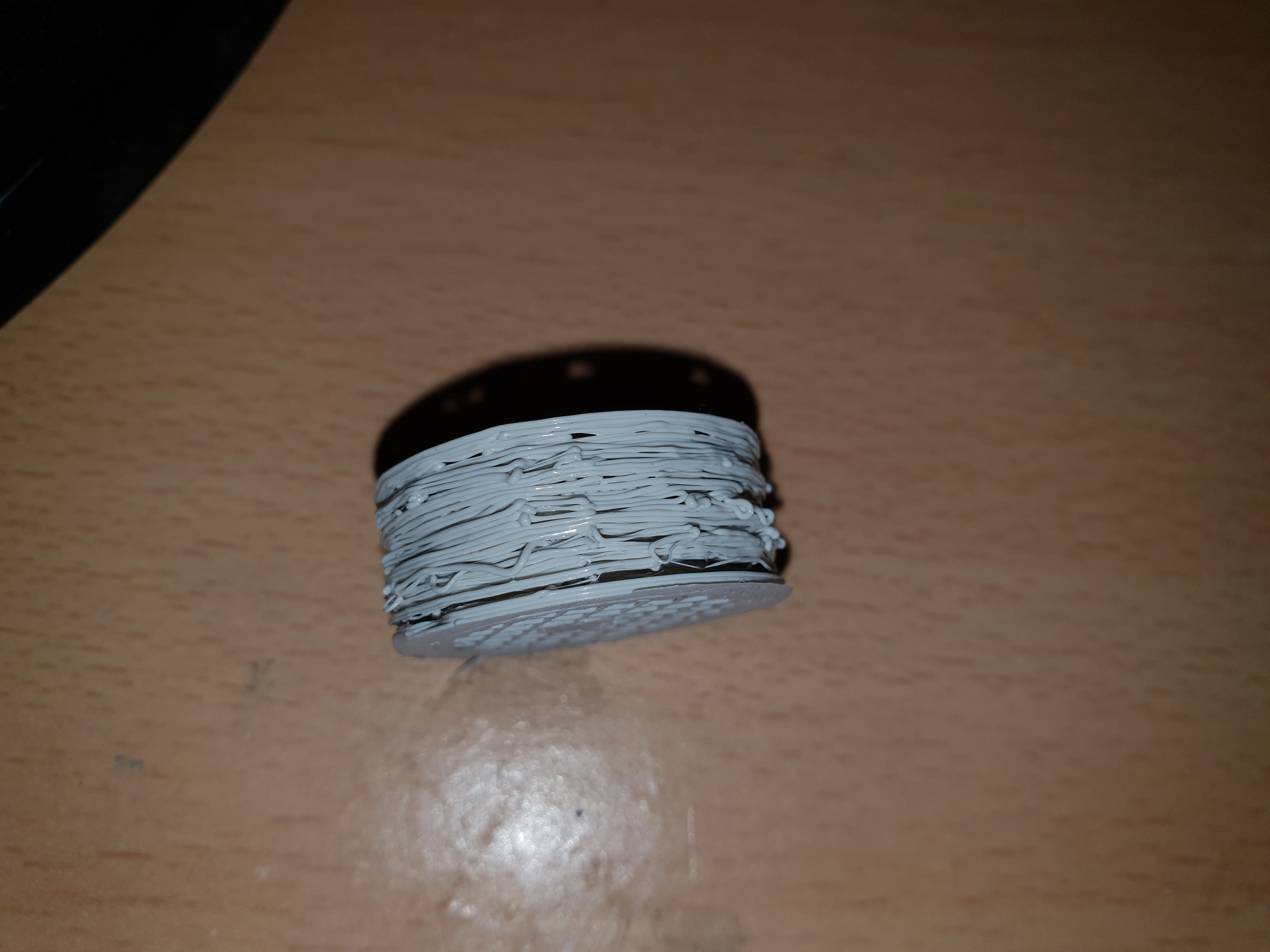

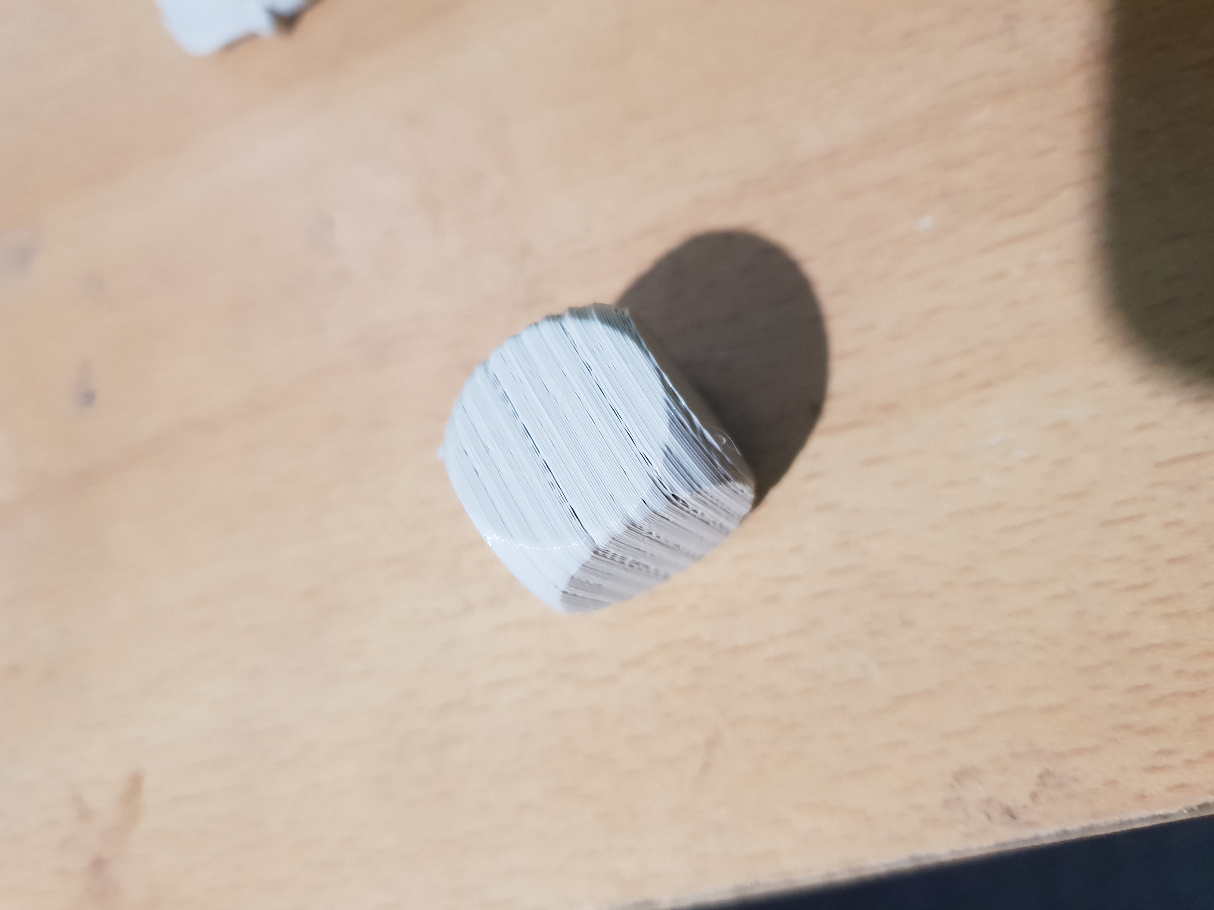

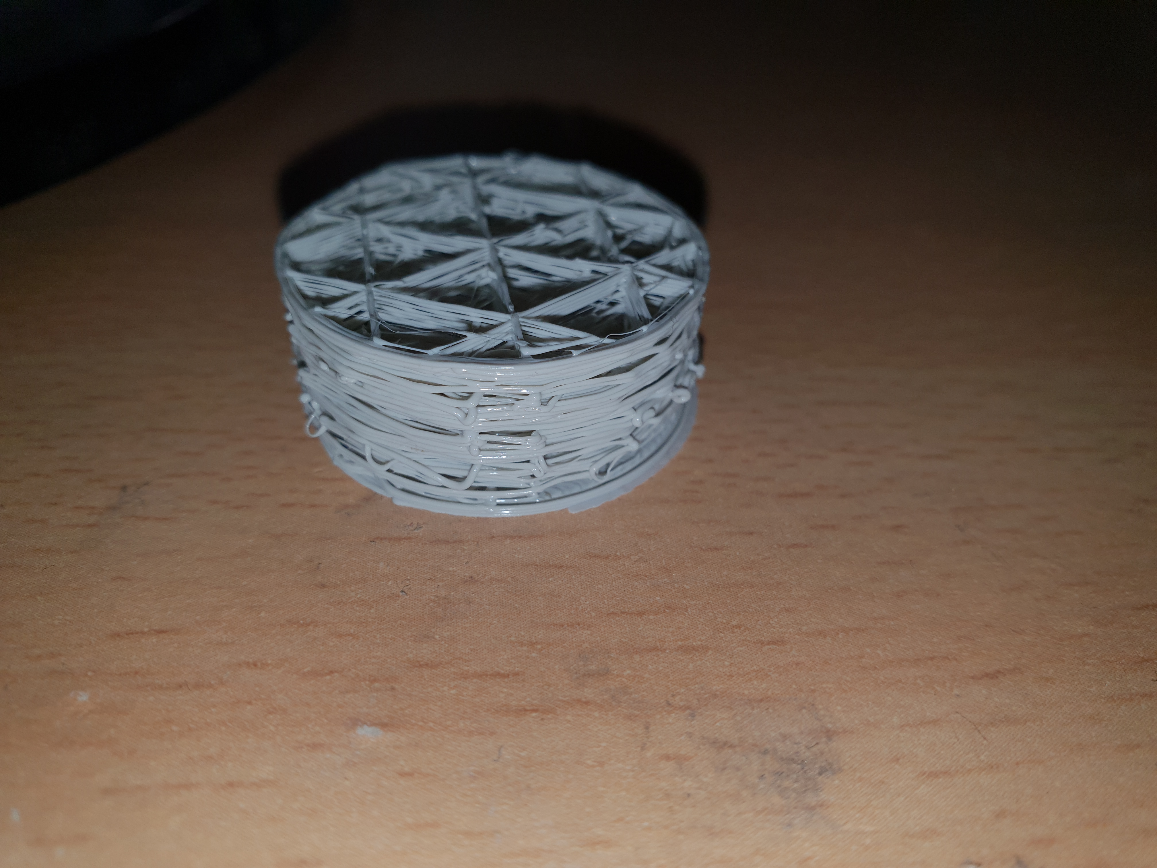

I have bought a new PLA filament ( Spectrum brand ) but i have issues with printing. It's not sticking, or not melting? I do not know.
Crealiy cr-10
Slicer: cura
Already tried:
-Lowered the cooling fan speed down to 40%
-Multiple nozzle size ( 0,2 and 0,4 )
-print with 180C° - 230C°
Link for my settings:
https://imgur.com/a/5YAECeh
Temperature problems?
Re: Temperature problems?
That's some serious underextrusion going on.

Im just tried another PLA filament which is worked well. So i guess something bad with the another PLA filament.
- Posts: 1494
I see you found your filament could have been the most likely cause, good for you. Filament problems can be a hard problem to diagnose.
