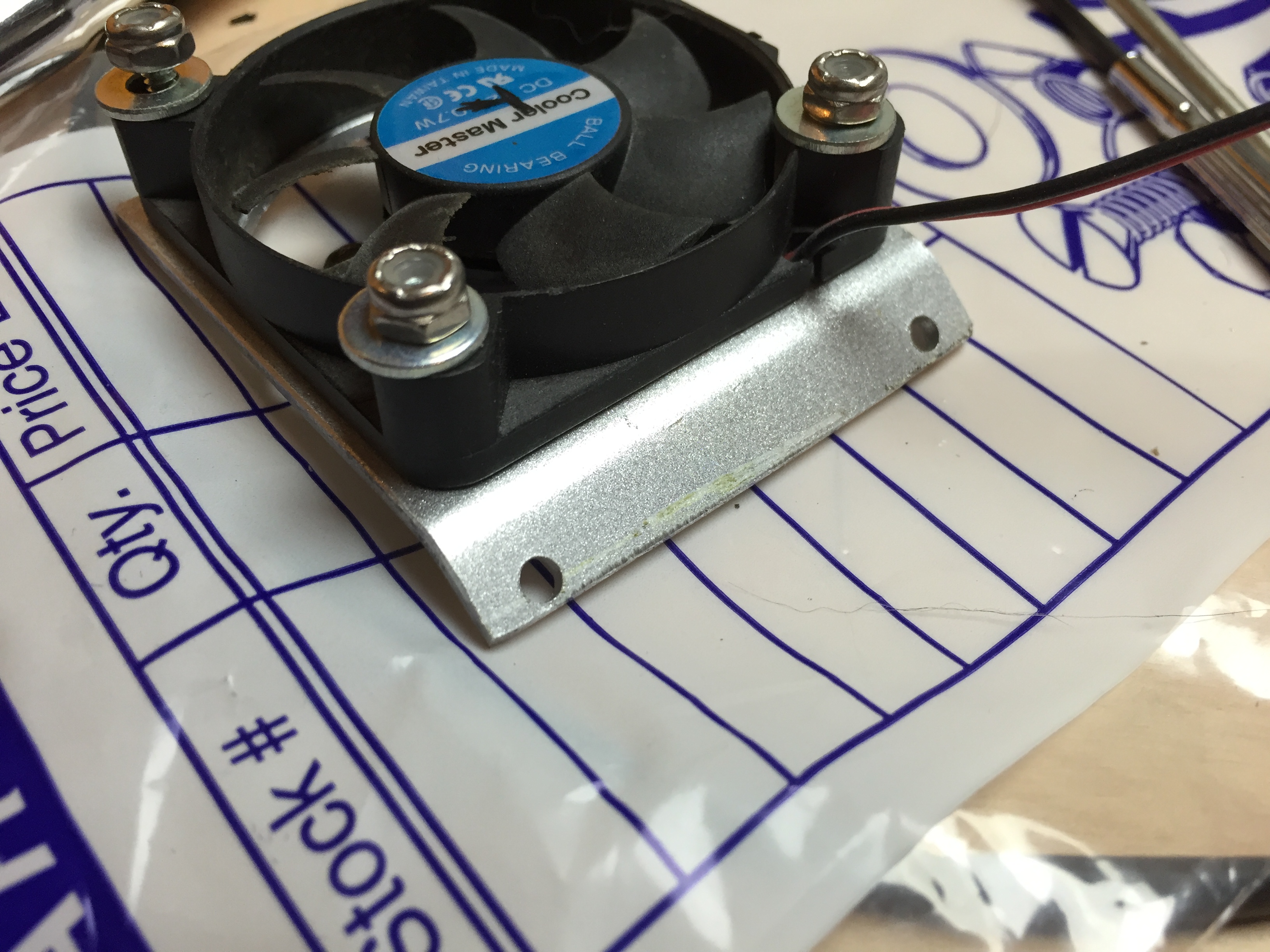

Using the rubber mounts that come with servo motors between the fan mount and screws. Wondering if rubber will deal with the print head heat or get a metal spacer?

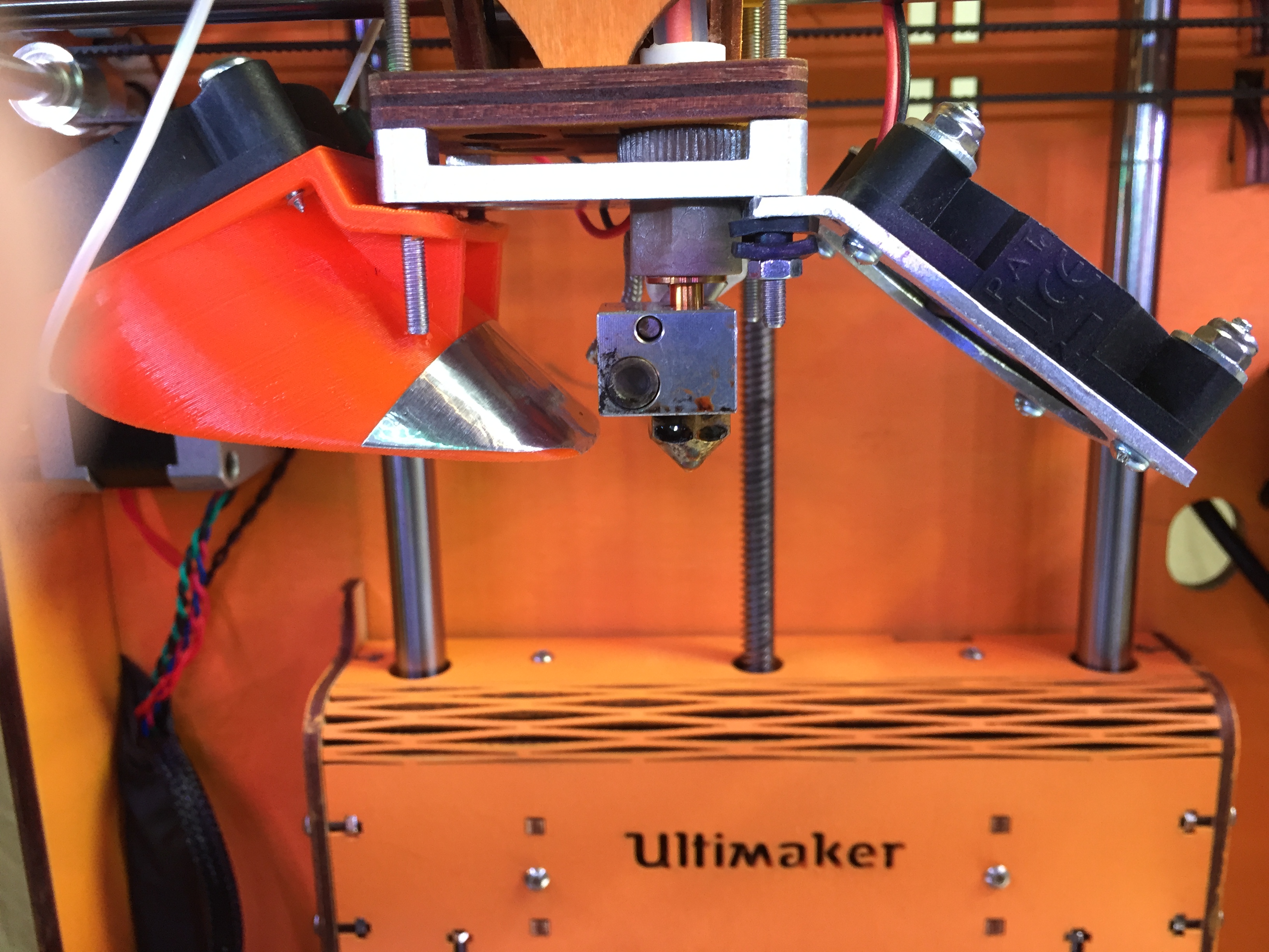

Re: Fan shroud upgrade
The tapir one looks nice, but it melts against your heater, unless you isolate it
I had some really nice fans shrouds printed from I believe Chopmeister? but my fans are to weak to actually push air through them xD So I'm using a metal sheet folded UMO+ shroud now. Which makes the machine pretty safe for children etc, but a pain in the ass to change nozzles.
Indeed I think isolating the alu block it's a must to avoid two issues. a) Air on block makes constant & stable heat a issue and b) The air bouncing on bed and hitting the block also makes fluctuations on heat.
The main issue to design a umo fan I think also it's that (for good or bad) the users can install the cables on the hotend on almost 4-5 different and working ways.
Also the other issue it's that you can only go 2-3mm bellow the alu block to shoot air, because if any fan cap it's a bit too low it might hit the hotbed clamps (if tou plan to use e3d nozzles).
It's a path full of issues.

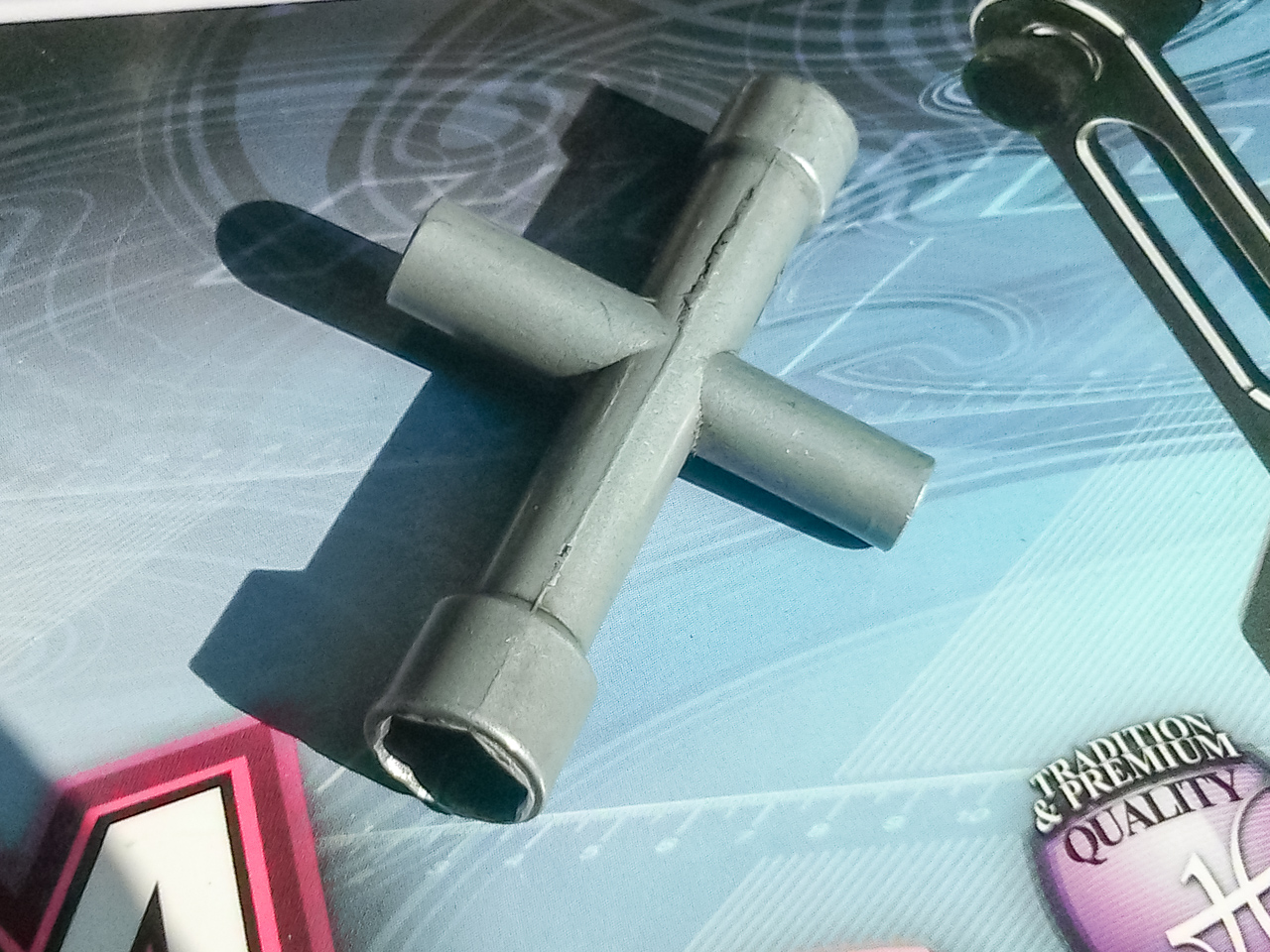

I use an RC socket wrench. It is very convenient when you use the metal fan...Titus wrote:So I'm using a metal sheet folded UMO+ shroud now. Which makes the machine pretty safe for children etc, but a pain in the ass to change nozzles.

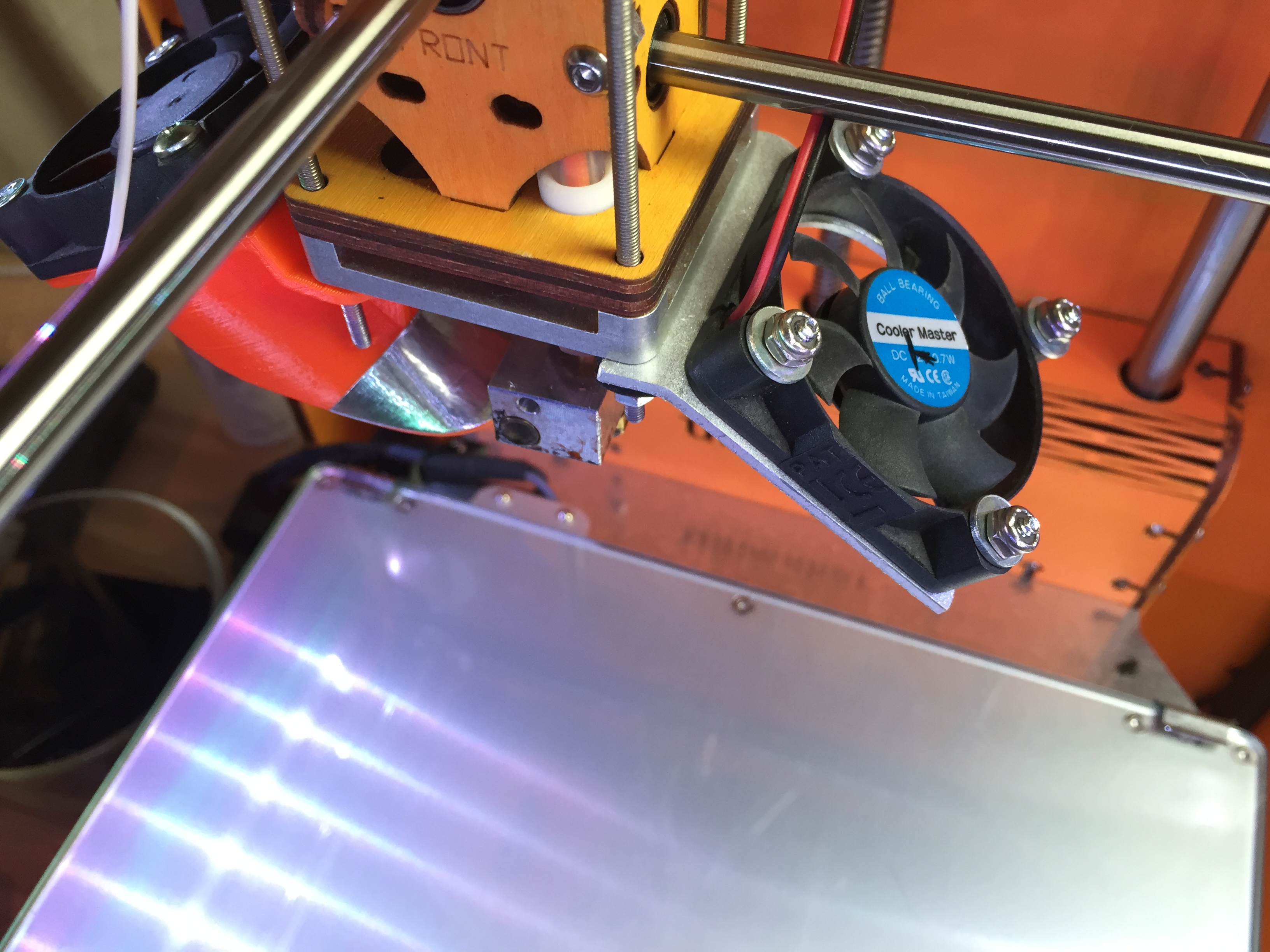

That doesn't help my 50mm fans!
I understand the fan blowing up on the heater block thought but, doesn't any airflow bounce up? Even the new UM2+ pushes air down and will hit the block, right?
As you saw with my right side overhangs, I just need airflow for starters on that side!
On UM2 you have a steel 0.5mm cap with only a small circle for the nozzle to pop out, so the air bounce it's minimal.
50mm dual fans could be installed on my mod, but would requiere some redesign. I just tested the first assembly and they rock. I need to fix a 1mm problem with the sideblock but minimal.
The problem with airbouncing it's that without a good cap, you can't shoot 100% fans to kill the overhangs at low height. But ofc that depends on what you use to print.
