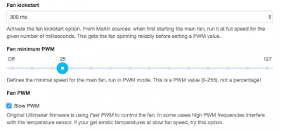

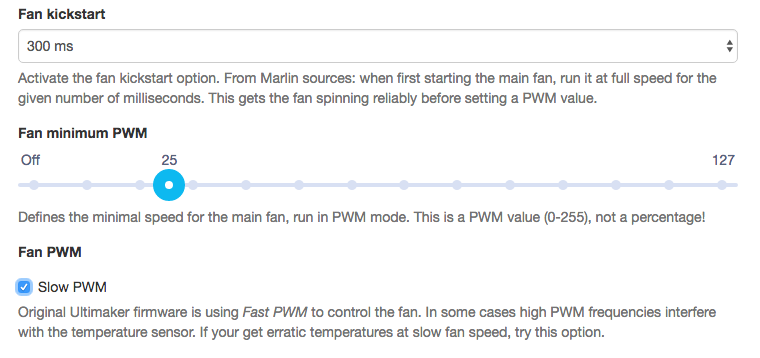

16.05-RC3 is out (in Experimental) and I think you will like it
I was tired to play with the Cura Fan parameters to get my fan(s) starting at the right time when I used low fan percentage...
... so I backported the FAN_MIN_PWM from latest Marlin
How does this work?
It remaps you fan percentage to the usable area of your fan(s).
By default 0-100% fan is mapped to 0-255 PWM value. With this feature, if your fan does not run under e.g. 25 PWM, it will map 1-100% to 25-255 PWM (0% is still 0 PWM of course).
Note that FAN_MIN_PWM is not the PWM at which you fan can start, but the minimum at which it still can run once started.
So to find the FAN_MIN_PWM, from the controller increase the fan PWM until it spins, the decrease until it stops and add a small margin: this is your FAN_MIN_PWM.
If the fan does not start at FAN_MIN_PWM (and it probably won't), then also use the 'Fan Kickstart' option from the builder, it will 'help' the fan to start.
Also note note that the 'Fan Slow PWM' option has an impact on the minimum speed, so when you determine your FAN_MIN_PWM, you need to do it with the 'right' PWM speed -- E.g. on my old UMO, in Fast PWM min PWM is 35, in Slow PWM, min PWM is 25.
It is really nice to have a fan which is active in the full 0-100% range!

DUDE I LOV YOU!Amedee wrote:16.05-RC3 is out (in Experimental) and I think you will like it
... so I backported the FAN_MIN_PWM from latest Marlin![]()
How does this work?
