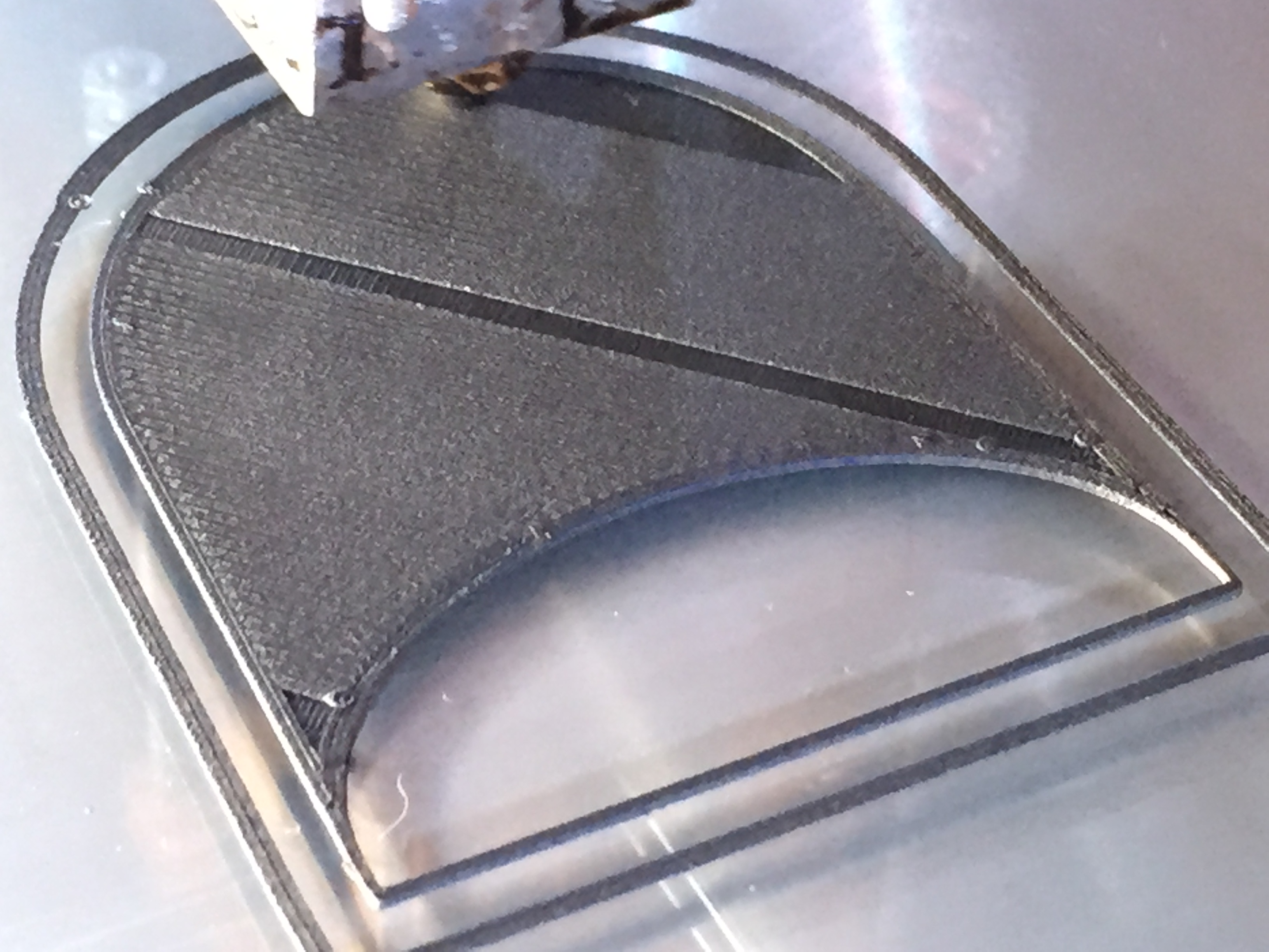

Using your setting suggestions...first few layers look really good so far on this fan shroud

So I asked ColorFabb about the results of some prints. I sent them the GCODE and here's his ideas...I thought I would share with others in case they opt to try too...
First, let's make the parts a bit more beautiful:
- There's quite a bit of Oozing on your print. This is the liquid material that sits in your hot end after an retraction and extrudes slowly during travel moves. We need do change the retraction settings to challenge those. Try a retraction speed of 40mm/s and a distance of 4.5mm. If that won't work, go for 5mm retraction distance.
- What you can also do about that is to increase the travel speed. Go for 250mm/s, so there's less time for the plastic to come out.
- I also see some blobbing on the print which is caused by over-extrusion. Go for 3% less flow, so there will be less of those small plastic bubbles on the surface of the print.
- I see some holes in the part, one is where a mount broke off, but also in the middle of the part. Go for 100% infill to prevent those. This will also make the thing a lot stronger.
If you have designed this part, always add a chamfer or a fillet around such mounts. This increases toughness and durability a lot.
Please let me know if that fixes your issues or not.
thanks,
Stephan

Re: ColorFabb XT-CF20 Carbon Fiber Filament
Indeed increasing retract will work, also increases the chances of breaking the filament. And 5mm distance sure will work, but also increases the chances of a clog. It's worth the try but don't be angry if clogs or breaks.
I still really really think that your coupler it's dead. Umo feeder can make it work in exchange of print quality. Users think that a coupler it's dead when underextrude bit before that the quality suffers.
