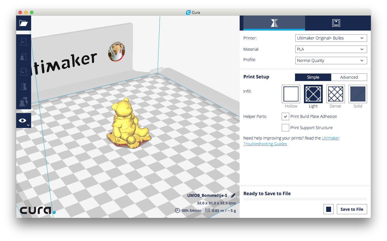

I also decided to go for 2.3...
I Installed the 2.3 Beta some time ago, but never used it -- I went back on the old legacy Cura as I just had things to print and didn't want to explore
It seems that Ultimaker eventually decided to sign Cura on Mac as a didn't had to change my security settings anymore -- good thing!
Now I am really impressed by the speed improvement. I liked 2.1, but on my old machine loading and slicing was significantly slower in 2.1 compared to legacy Cura. I haven't made scientific tests, but we now have almost parity. Loading seems to be a bit slower in 2.3, and slicing a bit faster.
All in all loading and slicing mini-bommeltje takes around 11 secs in Legacy Cura and about 12 in 2.3. Latest version of my ShowLayer plugin also works fine, so I think I am ready to go!
