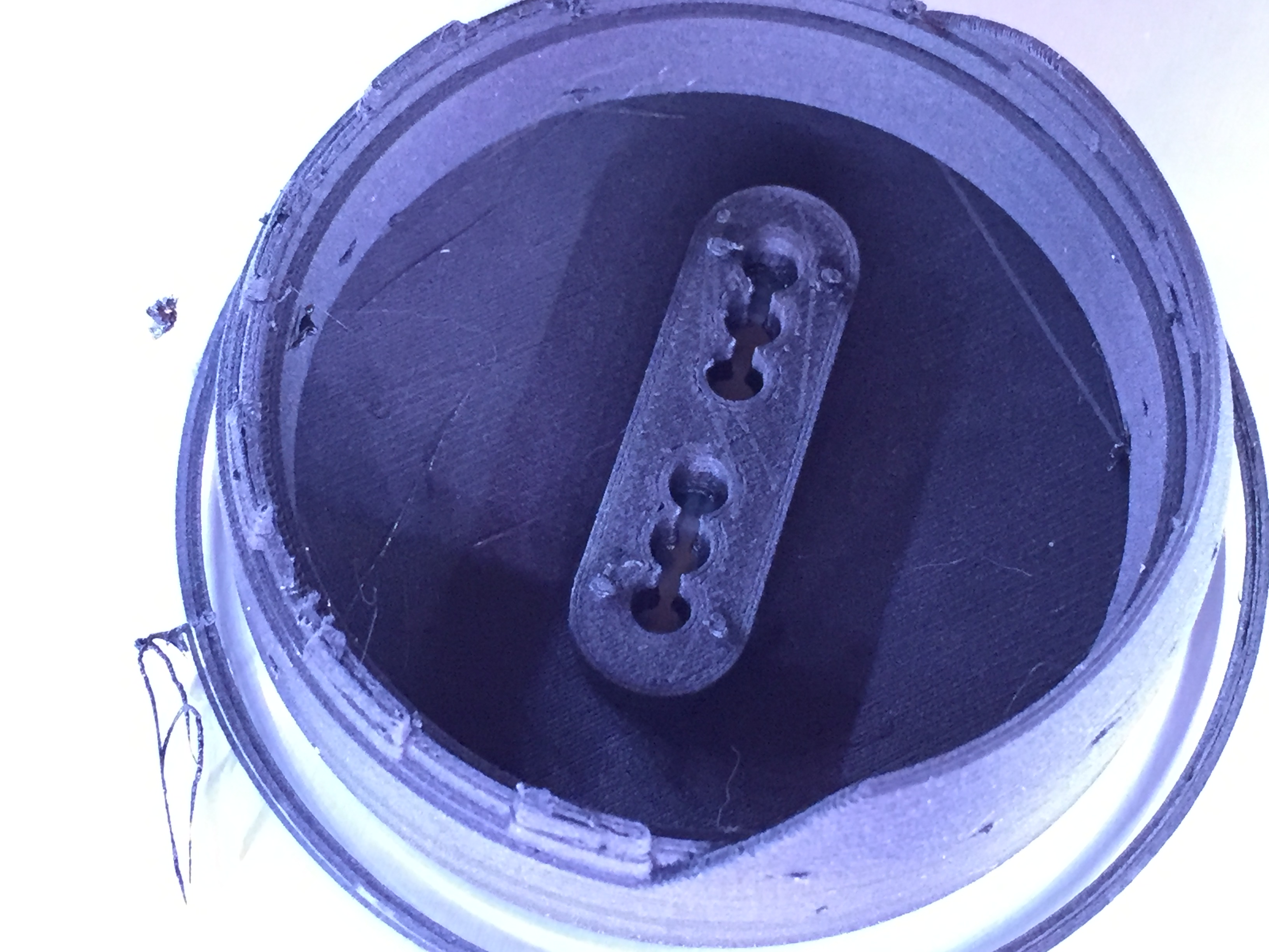

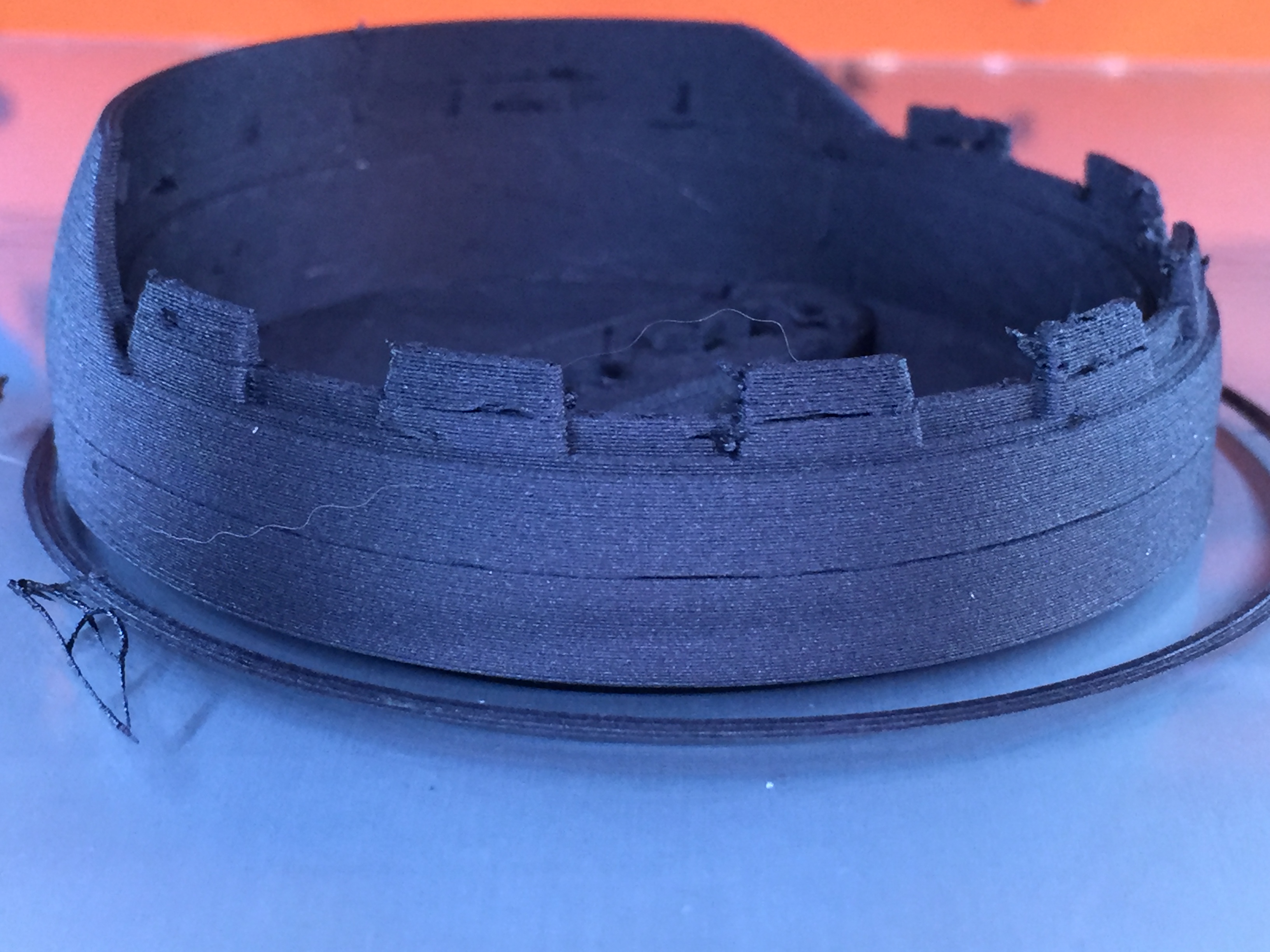

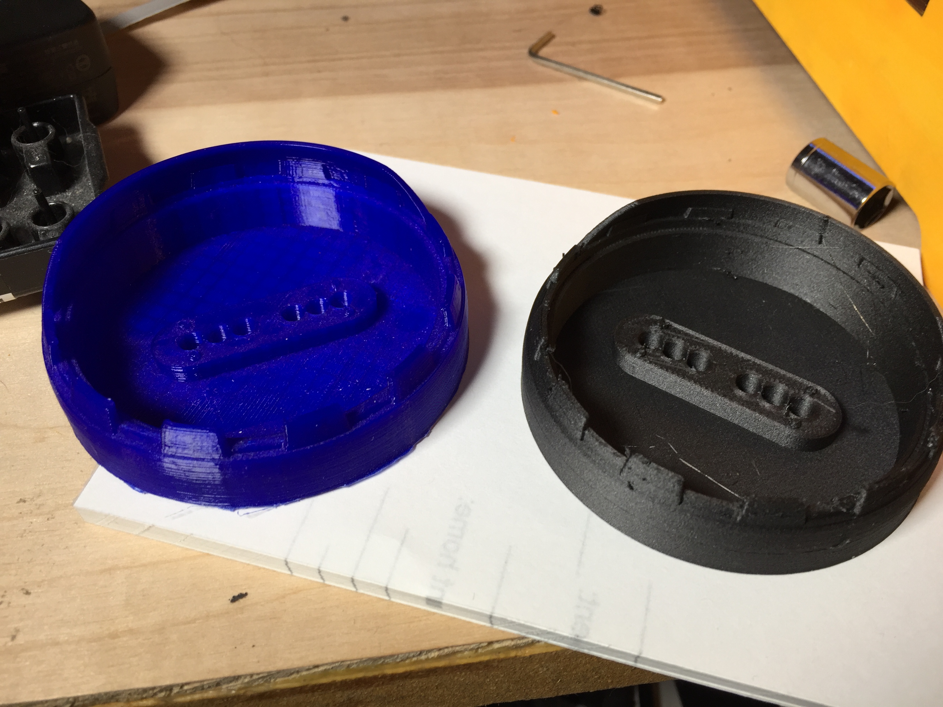

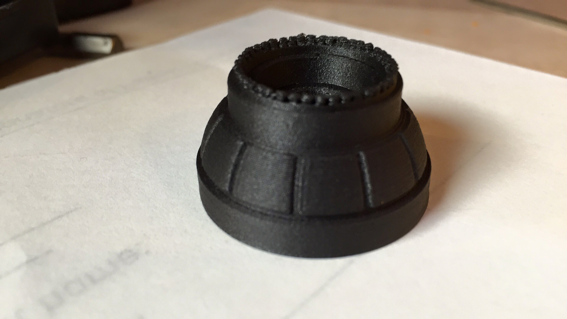

250 went well but I still have a few minor blobs that appeared. I made two test parts, BB-8's holographic projector and the surround for his "eye" piece.
The details need some work on the holographic projector (top especially)
The bigger piece has those blobs that cleaned up easy and some minor stringing. Pics next

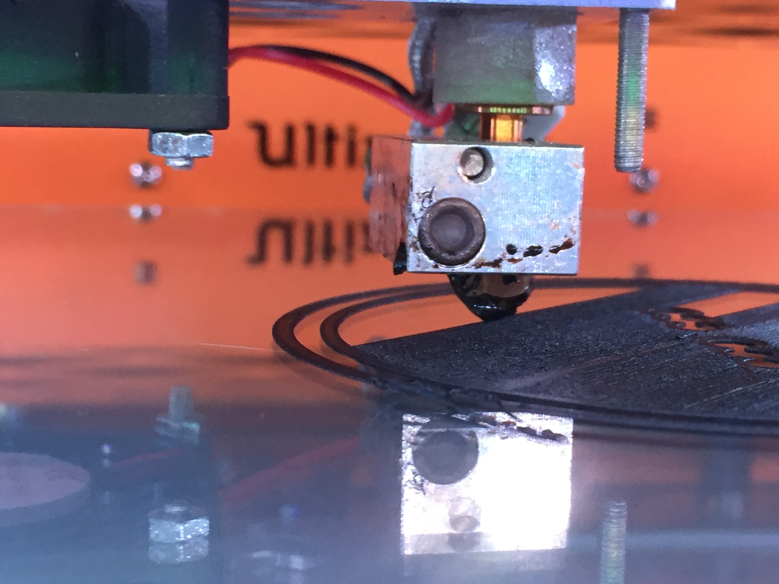

The filament curls a lot in the ruby nozzle and generates that blob early on. I try to snag it while it is doing the skirt

That close-up. Are you sure the coupler it's in good condition? If you check it, look if there's brown-sticky goo between the coupler/peek/barrel.
Best way to check a coupler it's to insert it on a filament piece and spin it. If it woobles weird the coupler might lost it's center due use/preassure.

A ptfe coupler can die in 50h use... YOU NEVER CHANGED IT??... ok... 200h print time.. Normal life of a coupler it's 100h, the rest of the time it's just the umo gear extruder it's really really strong and can overcome most of the problems. Ok, your coupler it's dead =)
Btw one of the bad thinks of a bad coupler, it's that it might leave a gap between the barrel/ptfe coupler, there the GOO deposits, and if you change colors you will have color contamination (unless you do an atomic pull without the coupler and all dismanted in the air like I did to my monthly maintenance routine). So, if you print a BB8 white and shinny, if you ever see dark spots on the print remember the GOOOOO (scary voice here) XD
No, for real, your coupler it's dead dead.

Ok, but where do you see that occurring in my photos?
Re: ColorFabb XT-CF20 Carbon Fiber Filament
On the underextrusion between the islands. That looks like preassure fluctuations that doesn't allow the filament to land correctly. Do they break by hand easy?
