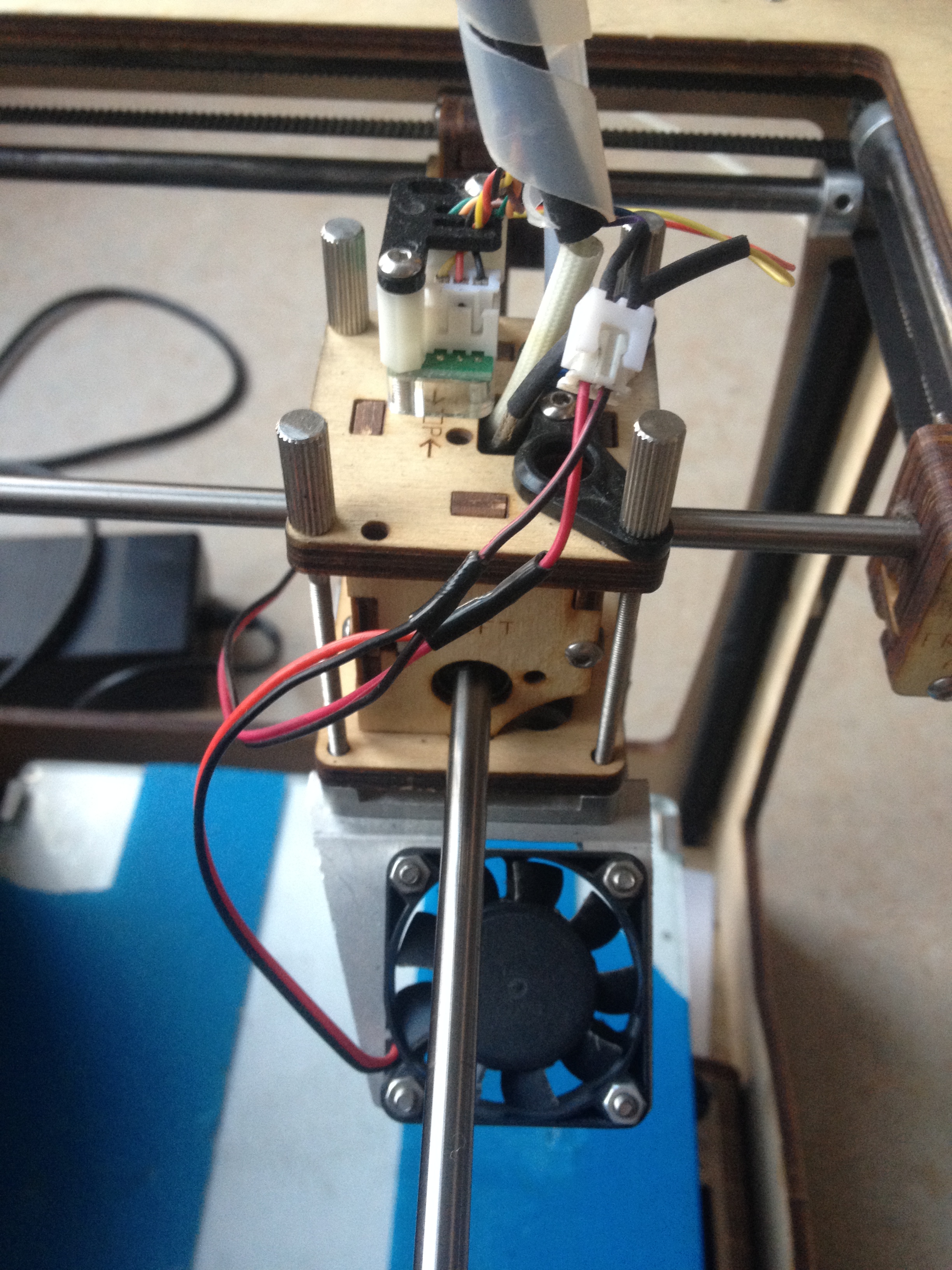

I ordered these: http://www.ebay.nl/itm/-/301473854304?
and soldered them red to red, black to black (series is this?)
Don't know much about electronics but it works.

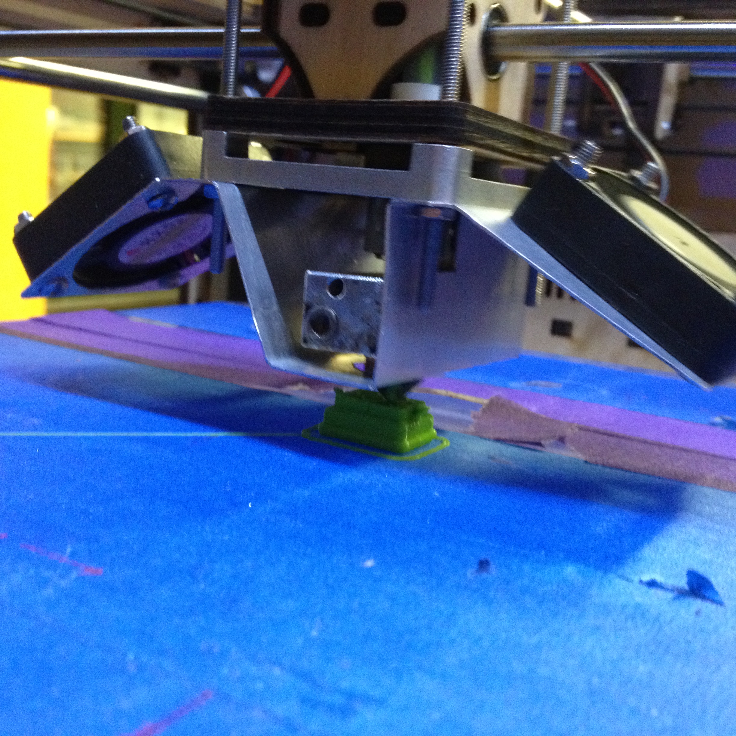

Made an aluminum bent shroud for it, protecting the nozzle from the wind flow. For me this was more importent then directing the airflow. And the choice for metal instead of a plastic shroud.

Yes, and about the same power specifications as the Delta fans I have been looking at
Yes in series...did yours come with the connector? Or solder into the existing?

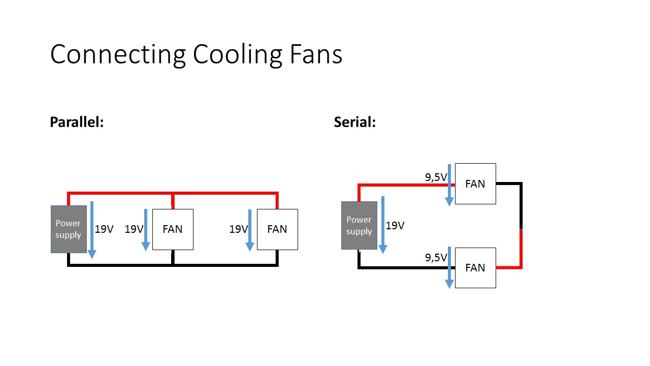

No, red on red and black on black is parallel!
I think I will make a picture...

always get confused with the series/paralel thing....., thanks for the explanation!
I choose smaller fans because I could shift them both a little out of the center, so the left one is a little to the front and the right a little to the back.
So the air would not 'clash' in the middle. Nothing calculated, nothing tested, just rational thinking, and I am happy with the setup.
