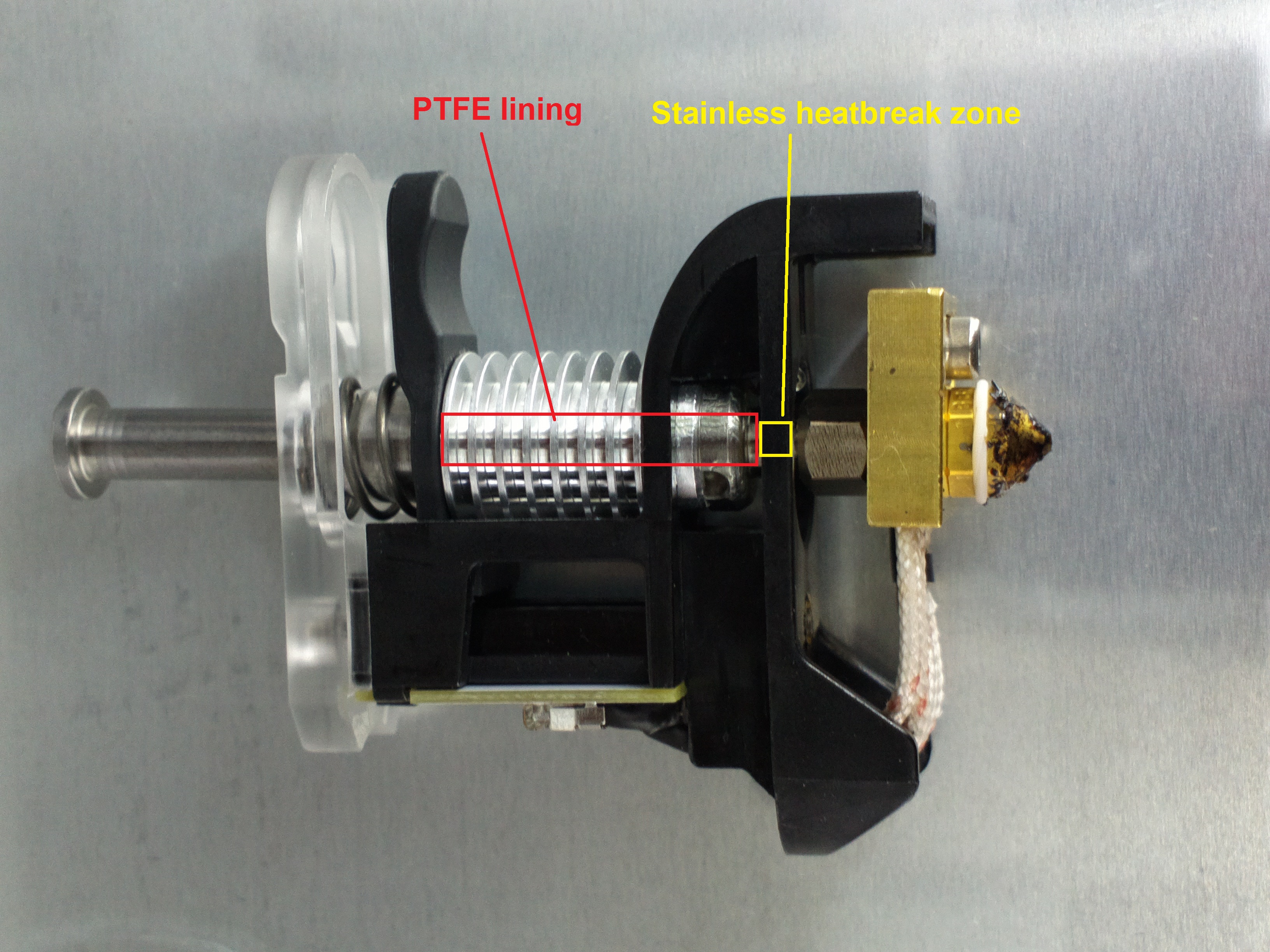

So, as I promised earlier, now when the Ultimaker 3 is official.
The Ultimaker 3 approach is PTFE lining which has proper cooling and then a very short and efficient heat break zone.
I should not share accurate drawing of it, but here is approximately how it looks: It is basically the same concept as the I2K-washer, but with proper cooling for the PTFE.
Or one can describe it as a properly engineered version of the E3D hotends, like version 10 or something..

the nozzles is still made of brass... really a poor choice IMOAnders Olsson wrote:So, as I promised earlier, now when the Ultimaker 3 is official.
and the white sealing washer on the nozzle... hummm... allumina? PTFE/TFM/PI?? withstand up to 280°C? so it's not PTFM/TFM...
contacts for heat cartridge power made on sliding contacts? at the first speck of dust will give a lot of problems (
especially when it considers that flows a constant current of 1.5 A)... without talk about the thermal sensor! the worst choice ever for it...
The shape of the metal hot end (the brass part I mean), finally have a decent design, at least the heat cartridge is on the side of the nozzle!!
But that heatsink along the "PTFE lining" with the rear part obstructed by the mounting itself... cannot be seen! really this hot end is nice to view... but is not engineered well, not at all...
without talking about that the PTFE is a thermal isolator, so, putting a heatsink along it will not affect the internal heat that someone here in the forum say climbing along the filament...
at this point they could use the hotend of E3D.. instead of bring life to this abort LOL! (ok too much sarcastic?... but come on! who thinks it's a good design or fails to predict how an object will behave in the real world or is just a bit naive... (or just trying to sell something claiming to be innovative or better letting the potential customers get blinded by an object worthy of note at first sight...)
no, really... this is the innovation? so sad about it... and disappointed!

Thanky for explaination...
In short, to check if I got it correctly:
- there is a thin tube of PTFE (Teflon) which sits in an alu housing with lot of cooling rips to make sure it will kept below ~200°C.
- this is supported by a very thin stainless tube which acts as a heat break - small/thin area for heat transition so less heat will end at the PTFE
similar to this: http://i.stack.imgur.com/WiRIv.jpg
The rest I can roughly imagine... Maybe there is a way to port the main concept to UMO
The only thing I´m a bit struggling is, how the nozzle/heater/stainless tube is crewed together? it shall be tight fit to prevent leaking... ??

I guess there is a risk this becomes a UM3 print core thread now, but anyway..
Anyway, regarding the lifting mechanism, the circuit board is stationary and the cables between circuit board and heater/sensor are flexing, so the contact surfaces are not going to wear much.
When I say well engineered I don't mean that the design is the most simplistic possible.
I mean that Ultimaker actually made something that prints well, which is not what I can say about E3D hotends
(I can not tell you how much I dislike the E3D-design after spending way too much time fixing it at our delta printer. I have a hard time understanding how something that primitive, inconvenient and unreliable can be that popular)
The PTFE lined E3D hotends either have a too long or a too short distance between the PTFE and the hot part, which means they don't take advantage of the benefits with a metal heat break zone.
The metal zone has to be short enough for the plastic to be properly melted but long enough for the PTFE not to overheat, which is exactly what Ultimaker did on the UM3.
The UM3 hotends prints everything from PLA up to polycarbonate without feeding issues and will need no regular maintenance, which is something rare (or even previously unheard of) among 3D printers in this price range.
That said though, things can still be improved, for example by fitting a ruby nozzle to the print core

This suggests that Ultimaker may in thermodynamic modeling, in contrast to the colleagues from Albion XD

Well engineered doesn't mean, for me at least, that the design is the most simplistic possible... for example a DELL or HP workstation have both well engineered internal design (but they are anything but simple IMO)
I never bought a hotend from E3D for the simple reason that I never thought that an interchangeable nozzle as proposed by E3D could work without leaks...besides the fact that achieve the precise connections between the steel part and the aluminum side and the nozzle side of so reduced size, it would result in a high precision mechanical processing. and from the proposed price I highly doubt that this is the case
For the same reason I never purchased an Olsson block, no offense, but I really don't like your solution, which more than anything else is a compromise to have an interchangeable nozzle
I not even take into account the ruby nozzle ... in the printing of thermoplastics I do not see the use of nozzles Sapphire / Ruby, and certainly not for the cost since the synthetic rubies cost nothing (more than anything else could be costly one initial investment to get a custom made ruby) nor for the dimension or anything else ...
So all I see behind the use of the nozzle with ruby is unconvincingly ...
Instead, it would be helpful to draw experience from what already exists in the field of injection molding... don't you guys?

I spent a long time looking at the new print head with Siert explaining all the testing that went into it.
If Meduza can find the video that shows the exploded view, that will explain a lot.
When I asked about changing nozzles, I'm not sure I got an answer I completely understood....I also still wonder what the white ring is around the nozzle?

After viewing some pictures and taking into account a sentence somebody wrote abount 300°C with core and a "silicon seal" I assume this white ring is something like a seperator between the nozzle and the front fan bottom cap/closure...drayson wrote:.. that question (white ring) also came into my mind...
To be verified... Nallath?? Daid?? Meduza??

And, just because you (rightly) mention the heat diffusion, you should agree that using a piece of brass in contact with the heat cartridge bring a loss of heat power... but we still see hot end made of cheap brass on a serious (at least for the price) machine like UM!
Always to be clear the thermal conductivity of Ruby is 36W/mK (and will drop as low as 20 when temperature is 300°C), Steel (generic, but can be 45 on nichel alloy or manganese and some alloy increase when temperature increase)17W/mK, Brass(generic) 100-150W/mK, Titanium 21,9W/mK
and so on.. but this is only literature already known from the ancient of molding LOL
So, I have doubt about that "serious 3D printer designers" are looking at consolidated experiences in other application fields
Kindly regards
Claudio
