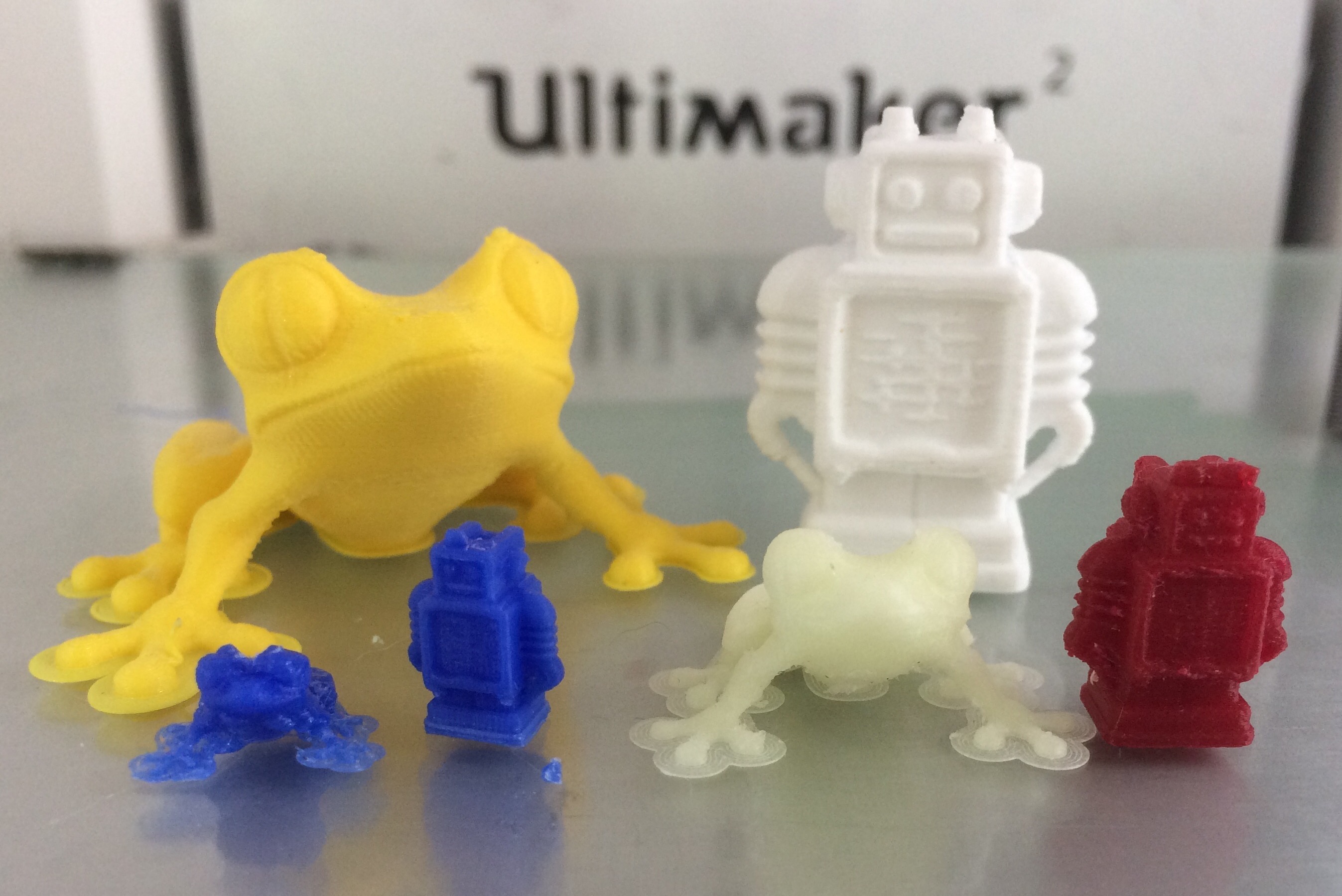

So yesterday evening I decided to try out a 0.15mm nozzle, I just rescaled the standard robot and the tree-frog as I had previously done with the 0.25mm nozzle.
The middle ones are the 0.25mm nozzle
And the small ones are the 0.15mm nozzle, the robot is 13mm tall, the frog is 6.7mm tall.
I've not got the retractions set, so you can see the bridging between elements, but not bad for 1st test. Although on the 1st build the nozzle blocked, I think too much pressure, and took nearly an hour of atomic pulls to fully clean the head. But reduced the speed a lot, the temperature a little and bingo.
The large ones are the standard size printed with the 0.4mmThe middle ones are the 0.25mm nozzle

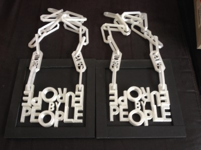

Tomorrow is the official opening of FabCity / Europe by People http://europebypeople.nl/fabcity-2/ where I will be working for the next 11 weeks. Already printing a lot for this: the Mayor of Amsterdam and the Minister of Education, Culture and Science are receiving a chain of office, printed in recycled PET (Refil).
Printed halve of the links flat, solo and the other halve on the side with a pause. In the pause 2 links were added and a printed 'bridge' to fill the gap. A bit of tape on top of the bridge releases the freshly printed upper part of the link.
Printed with 3 printers in 3 days, print time about 32 hours.

That's such a cool idea of doing the chains.
Going to have to see that I remember that if I ever want to print some.

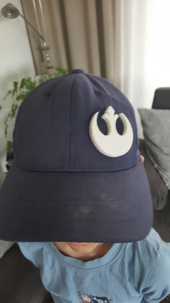

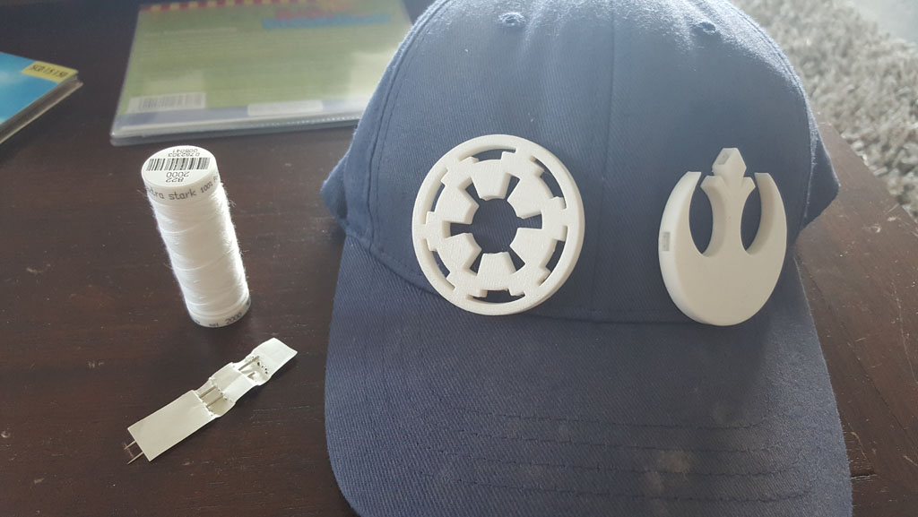

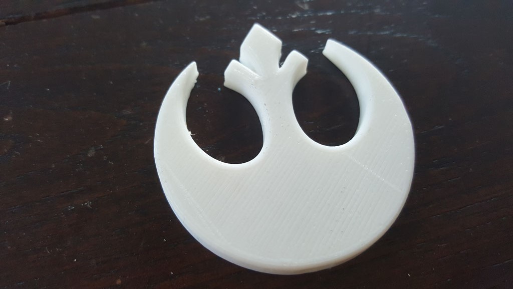

A little cap modification (my son wanted a logo on his plain cap). So I modeled and printed two so he could choose one (some of you might even recognise the "brand"
). I modeled them in F360 and printed on my UMO with Ninjaflex, they turned out fantastic (bondtech QR3!!). After he chose the Logo, I stiched it on with needle and thread.
Wish you all a great Sunday!

@martin-bienz: Nice, but your son has to decide which side he wants to be on...
Or did he as one image suggests?

Hehe... yes, he simply can't, it's imperial today, rebels tomorrow... the today's kidsDim3nsioneer wrote:@martin-bienz: Nice, but your son has to decide which side he wants to be on...Or did he as one image suggests?

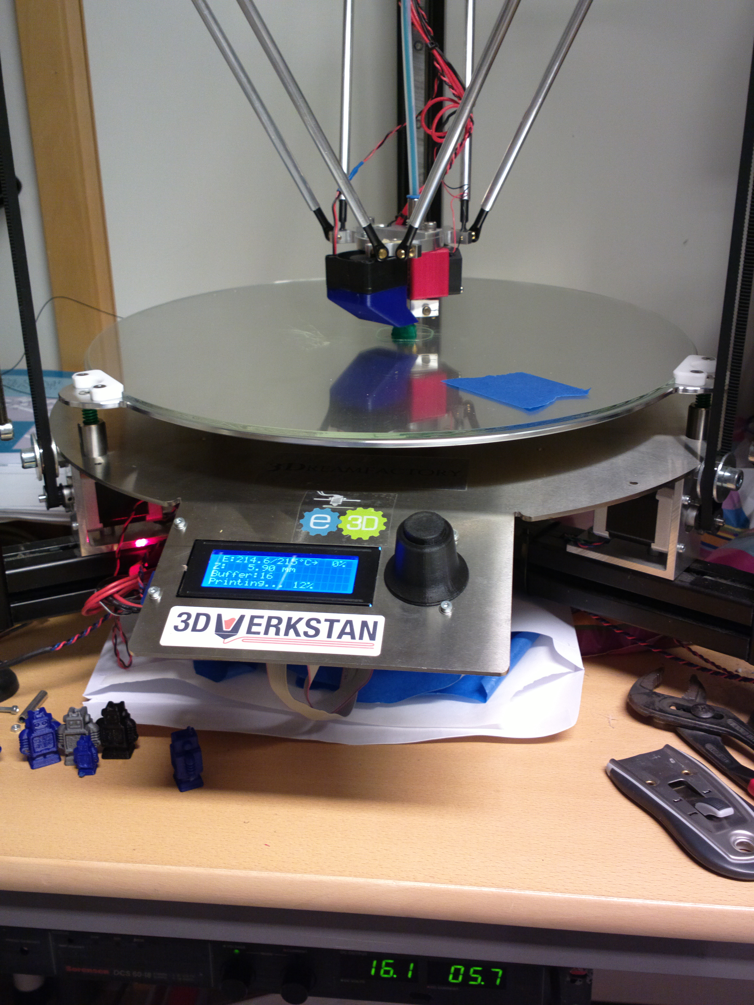

Not so much about the print this time, but about the printer
Finally got the parts from the workshop yesterday for out Delta Tower heated bed upgrade.
I could not resist stopping by work this afternoon to test it
It is not temperature controlled yet, had to run it of a power supply and play a bit with the voltage to adjust the temperature. As you can see I took a chance to test one of the ruby nozzles while testing the printer. The piece of blue tape was used to get a more reliable reading with the thermal camera since smooth surfaces tends to give false readings. If we get this working smoothly with the firmware it will be a HUGE upgrade in usability and user friendliness.
I can not tell you how much I hate blue tape by now, in particular when trying to print large objects, I hope I never have to use tape again with 3D-printers.
I will try to make a separate thread about this upgrade once it is working properly
