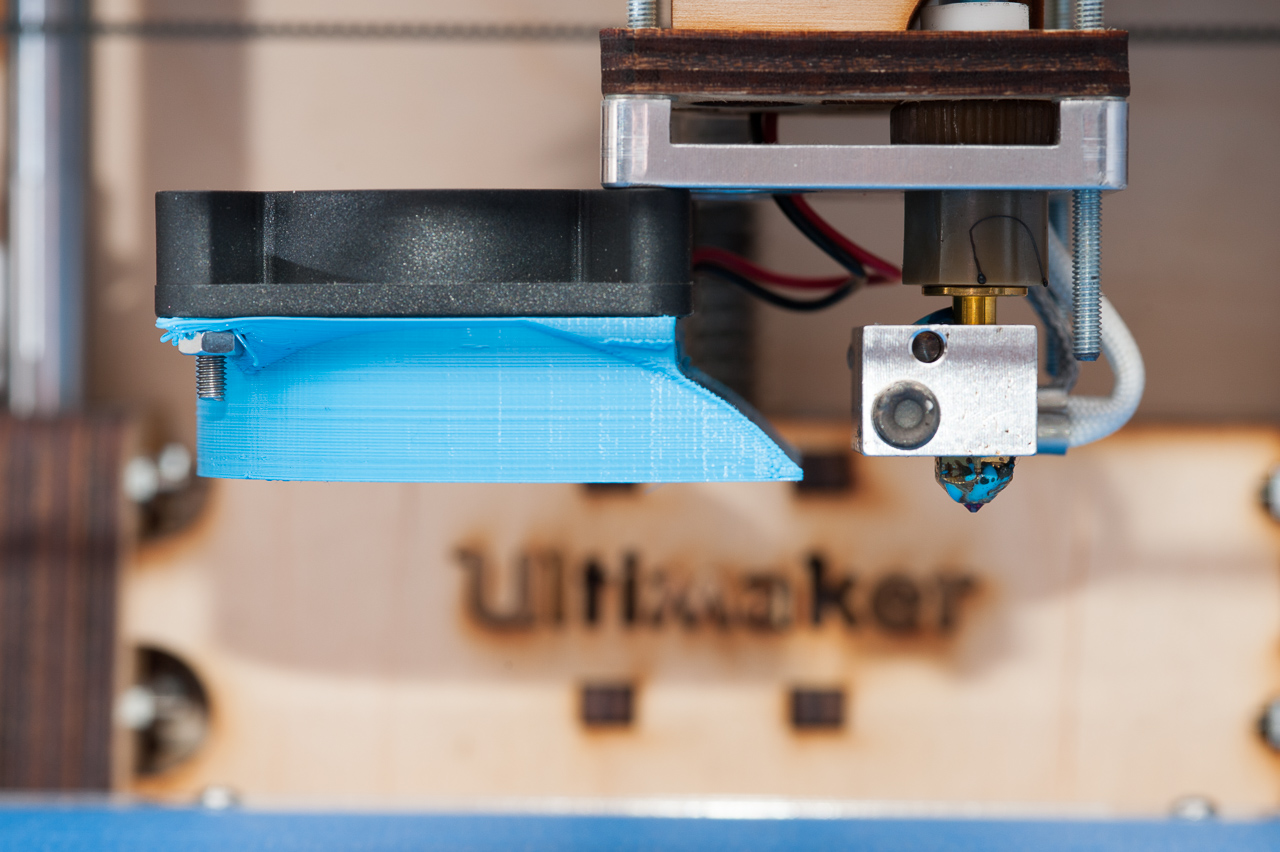

LePaul wrote:I'm not sure I understand the gap you guys are commenting on? A few months when I adjusted it and the new ruby nozzle, everyone said it was perfect?
I said perfect to this photo
viewtopic.php?f=9&t=4&start=240#p3329
But on that photo I didn't saw the upper side. That should look like this
viewtopic.php?f=9&t=4&start=225#p3314
The gap between the alublock & peek on your photos it's too small. That affects the hot/cold zone making weird stuff like blops or inconsistent printflow. Also, the hole of the fancap it's too big allowing air to hot the alucap.

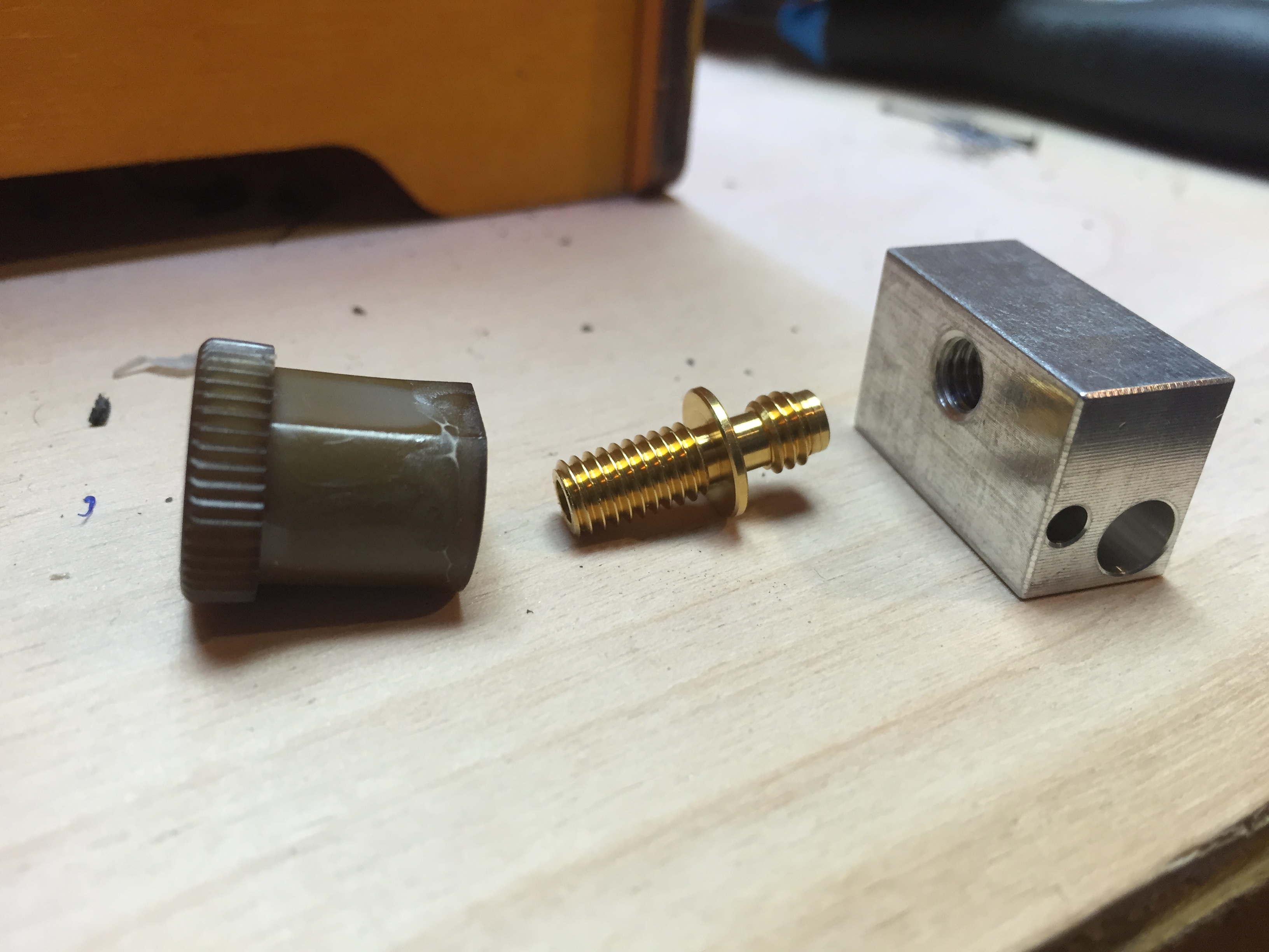

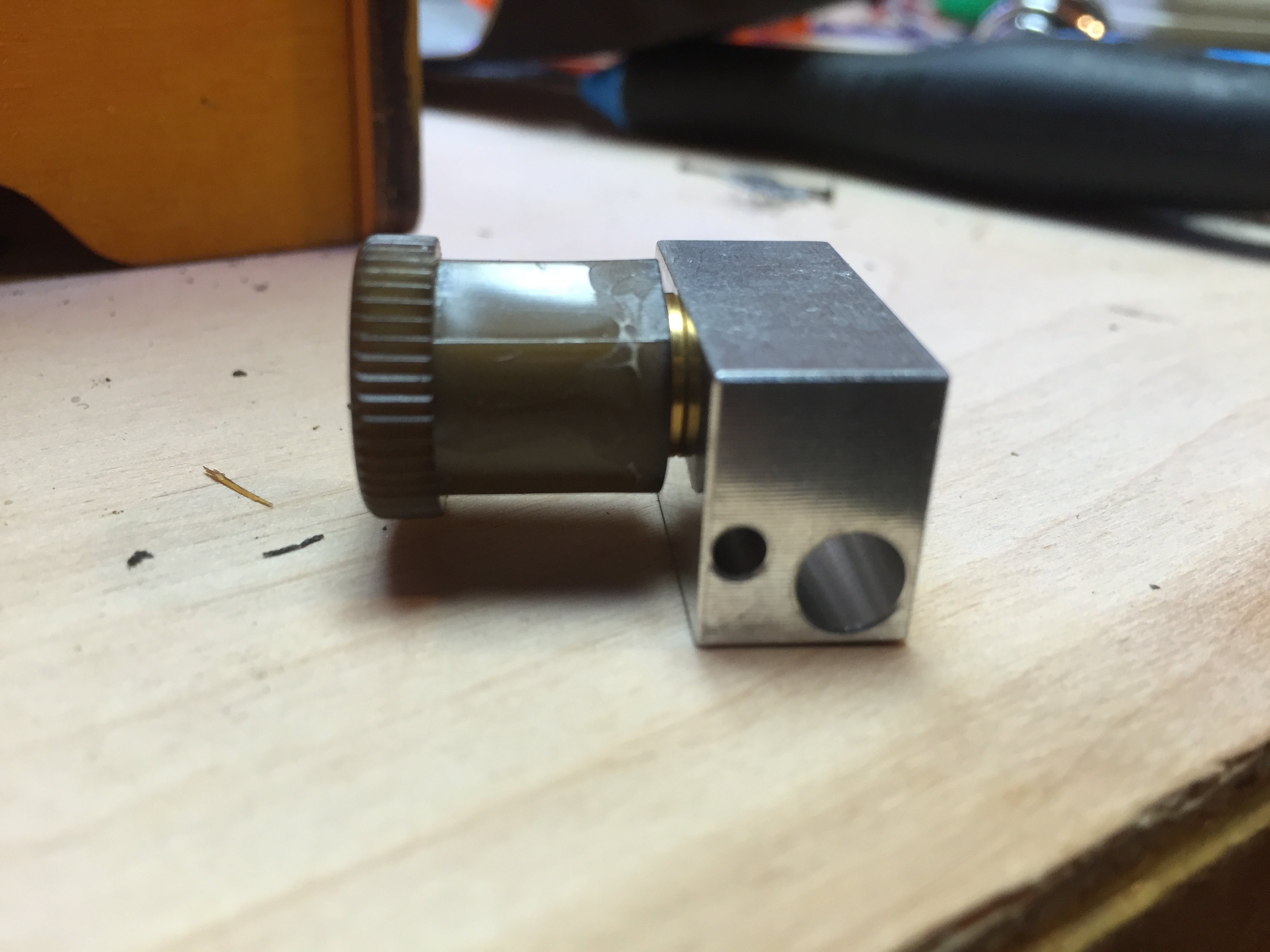

Okay I'm looking at the gap you say I should have there.
Now my brass pipe is fully threaded in as it should be
To compare I have a spare hot end kit. Apart and assembled are just like what I have installed....

Example of how it should look like from amedee img
download/file.php?id=487&mode=view
Wiki explained very well how to assemble it

LePaul wrote:Okay I'm looking at the gap you say I should have there.
Hi LePaul
My 2 cents if that can help !
your pic shown the Peek screwed fully in the alu heat block,for getting the good position,
does that to be screwed after the nozzle in place on the heat block :?:
I made a virtualy assembly from the Ultimaker UMO+ step files, so it reveals an inconsistent point compare with some part sizes done
May be it would be have to check the deep of the 6.3mm hole Peek :!: :?:

Nice one gudo. The ptfe coupler it's 5.1 length not 5. And indeed there's a 0.2-0.1 gap on the design that on the reality isn't there (no clue why)
Lepaul if you try to take out the sensor/heater the only way to do it it's by hammering the oposite side to push it (specifically because you had some leaks in the past and material will be there). If your prints are ok leave it for now.
