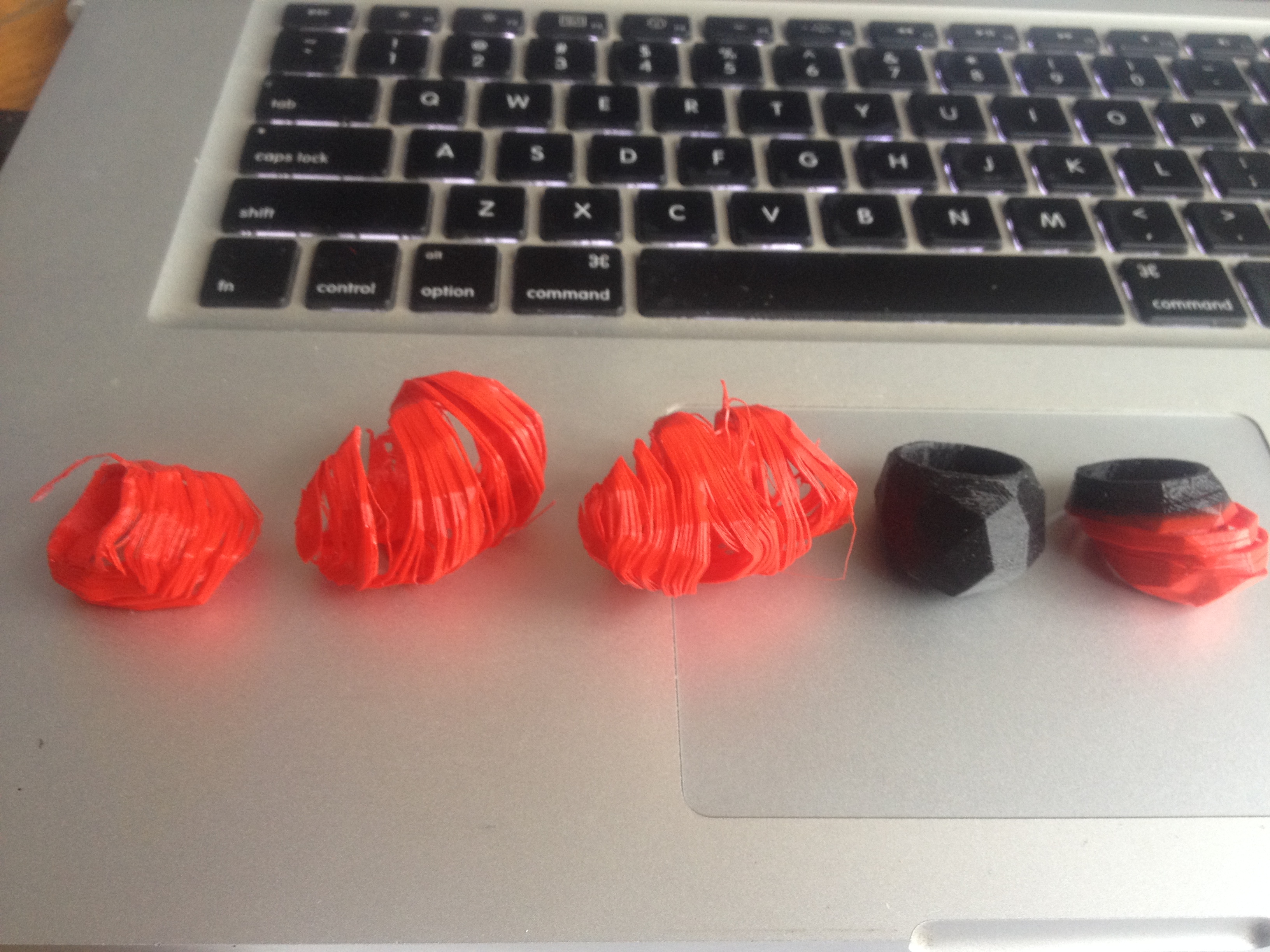

Izzy wrote:Looks a tad dirty, what adhesion are you using?
And what camera are you using?
Picture from my iPhone 6
I'm heating the bed to 80C. Using glue stick as well

I had a weird first layer today. Maybe the glass needs a thorough cleaning?
Tidal waves on first layer usually means that your. Ozzle is slightly tiny bit too close to the bed.

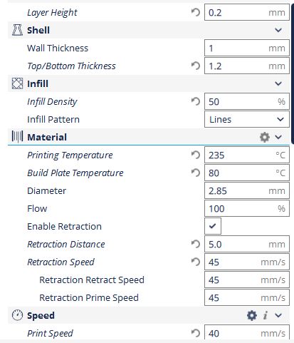

I'm trying nGen in the UMO and after messing with the right retraction settings and and upping the temp for the ruby nozzle a bit ....I got some good LOOKING prints but they come apart like styrofoam
Here's what I'm using in Cura 2.3.1
Fan is set to 50% (best guess really on that dual shroud)
Is my problem adhesion between layers to get a "styrofoam" type print?

With the ruby nozzle I would try another 5 or 10 degrees on the print temperature, the rest of the settings look good, so it is just a case of getting the inter layer adhersion right.

Just looked at the wall thickness, perhaps should be 1.2mm so 3 x the std nozzle thickness of 0.4, it could be that the two walls didn't quite join. Unless your printing with a0.5mm nozzle that is?
And for infill try grid not lines depending on the shape.
Re: nGen ?
Oooh good catch. Let me try that
