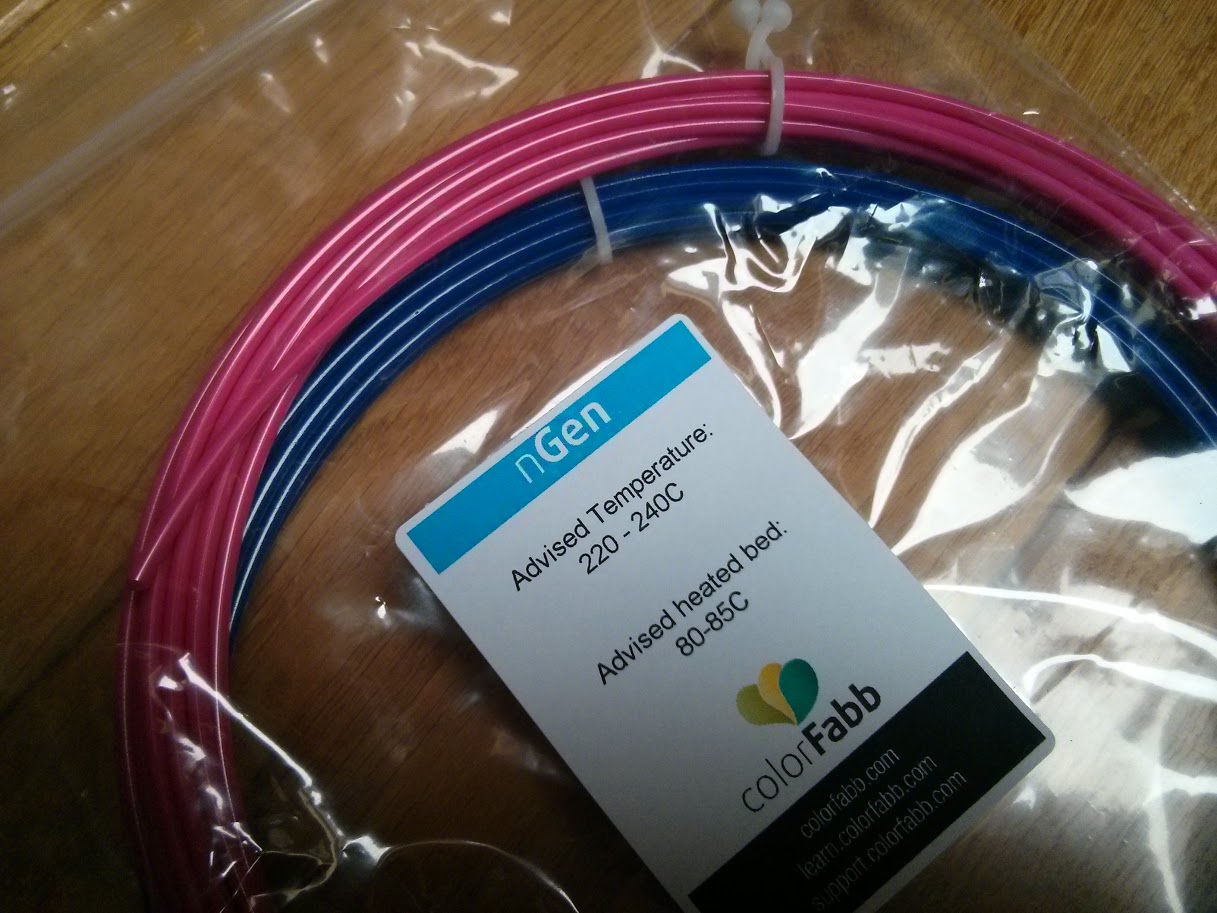

You mean like these ones?

And how it? Good filament, or some tricky?Amedee wrote:You mean like these ones?
These samples are still untouched, but my daughter used 2 spools of nGen grey in her "Gasometer" project.

So to come back to nGen...
If you need something which is more temperature resistant than PLA, don't hesitate go for it!
(For this particular project, I wish we had a direct extruder -- bowden is a pain for small vertical pillars...)
(There are also some pictures on Flicker)
The 2 RAL greys are nGen (the big gasometer structure, the internal staircase and bottom houses)
The choice of nGen was initially driven by the color requirement, as these greys are only available in nGen and XT, not in PLA/PHA.
Faberdashery would have been an alternative, but ColorFabb ships much faster and cheaper to Belgium (and the Euro is weak these days
- It prints very nicely at 230°C, good layer bonding, looks nice.
- Easy to print: aside the fact that you need to print at higher temperature it is as easy as PLA, but the glass transition temperature is much higher.
- In term of Tg we are in the same range as with XT, but in my view much easier to print (XT is 75°C, nGen is 85°C)
- Bridges well (see e.g. staircases in the video)
- It is also definitely less brittle than PLA (more flexible).
- In term of strength, no idea, I have not tested.
- Price tag is the same as their PLA/PHA
