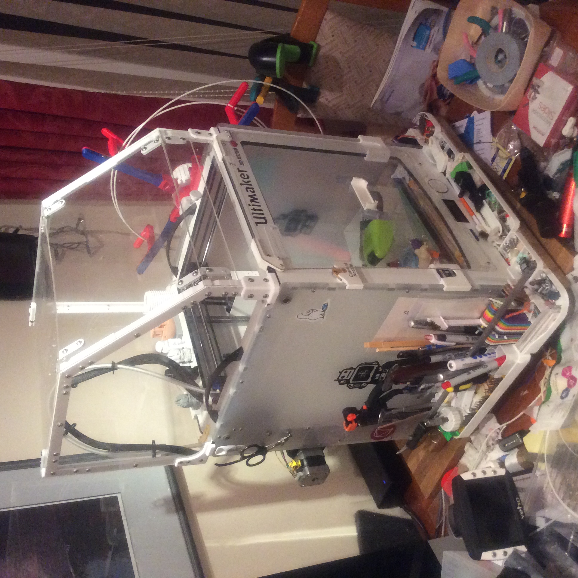

But I was quickly sorting out my printers hood, I've got to remake the top and sloping faces that open up giving access as they are from my initial prototype. The whole hood can be lifted off, and with the front door it creates a suitable environment for ABS printing, when I have redone the front lids I will publish the files for others to utilise.
All the parts can be printed on the bed, I deliberately made the parts small and simple, all the acrylic parts can be produced from a single 2mm sheet about 4ft X 2ft, all the parts are screwed together. Fully details will be published when complete
Please excuse the mess, the printer sits on a lazy Susan, and I have a tray assembly that fits the front and sides, the front centre piece has a tray that fits under the printer where I keep my scalpel safe and sound.

2Izzy: Do you need a hood on UM2 only for ABS, or it make benefits for PLA too?
gr5 was mentioning a hood is good for filaments like nGen too
With the door on it provides a stable environment, I designed the lid so that it can be propped open indifferent positions for ventilation too, and it also prevents my cats from getting too inquisitive and sticking paws where they may get hurt.
