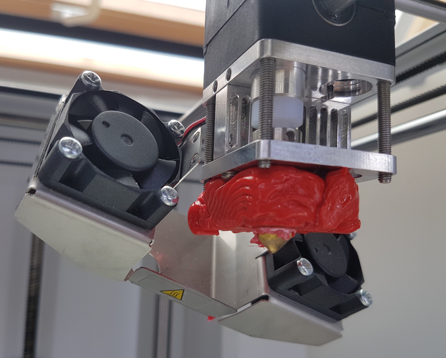

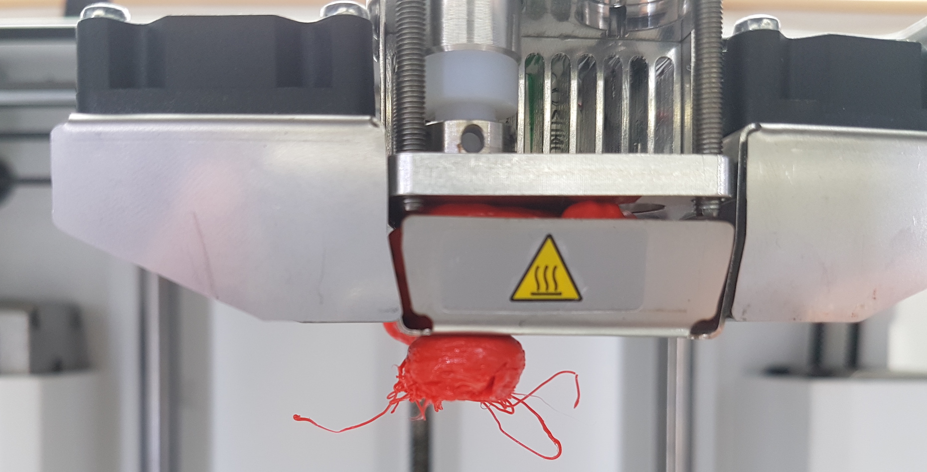

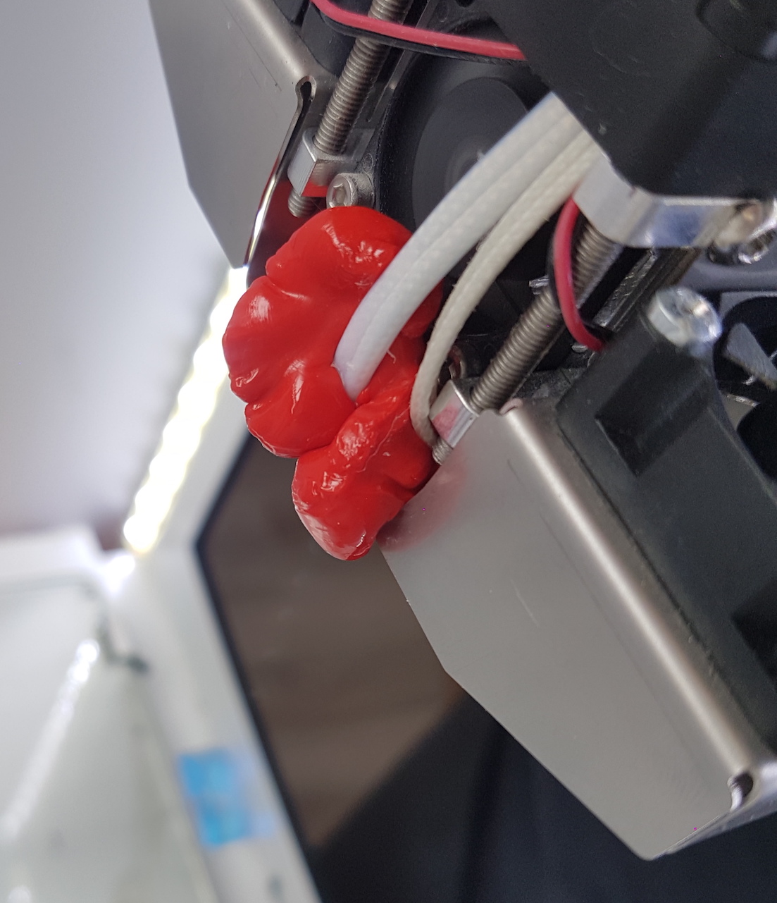

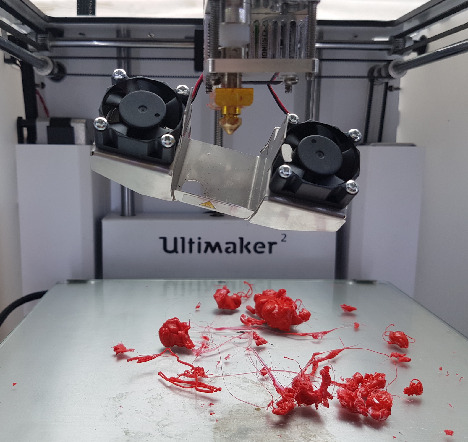

Soooo... And then this happened.

Heat to 110-120 for the big parts and then 90 for the parts near the nozzle/block
Do an atomic and check If the steel coupler it's fully in. Then you need to screw the 4 long screws using a guide of plastic that comes with the maintenance kit, or just tight them by eye (quite hard without knowing the correct distance) to keep all close and without future leaks.
https://ultimaker.com/en/resources/2218 ... fm-coupler
Check the step 2. The plastic peace it's like 2€ at ultimaker resellers.
Oh wow....and red, for the horror look
Or was just a print sticking to the nozzle??

Neotko wrote:Or was just a print sticking to the nozzle??
Started out that way yes :)
Left it alone for too long and then it started dumping the filament in the head instead of on the plate :)
And yes 110º is what I used to get most of the stuff off :)
Not perfect but it'll do.
So no leak? Just a print that turned evil?
