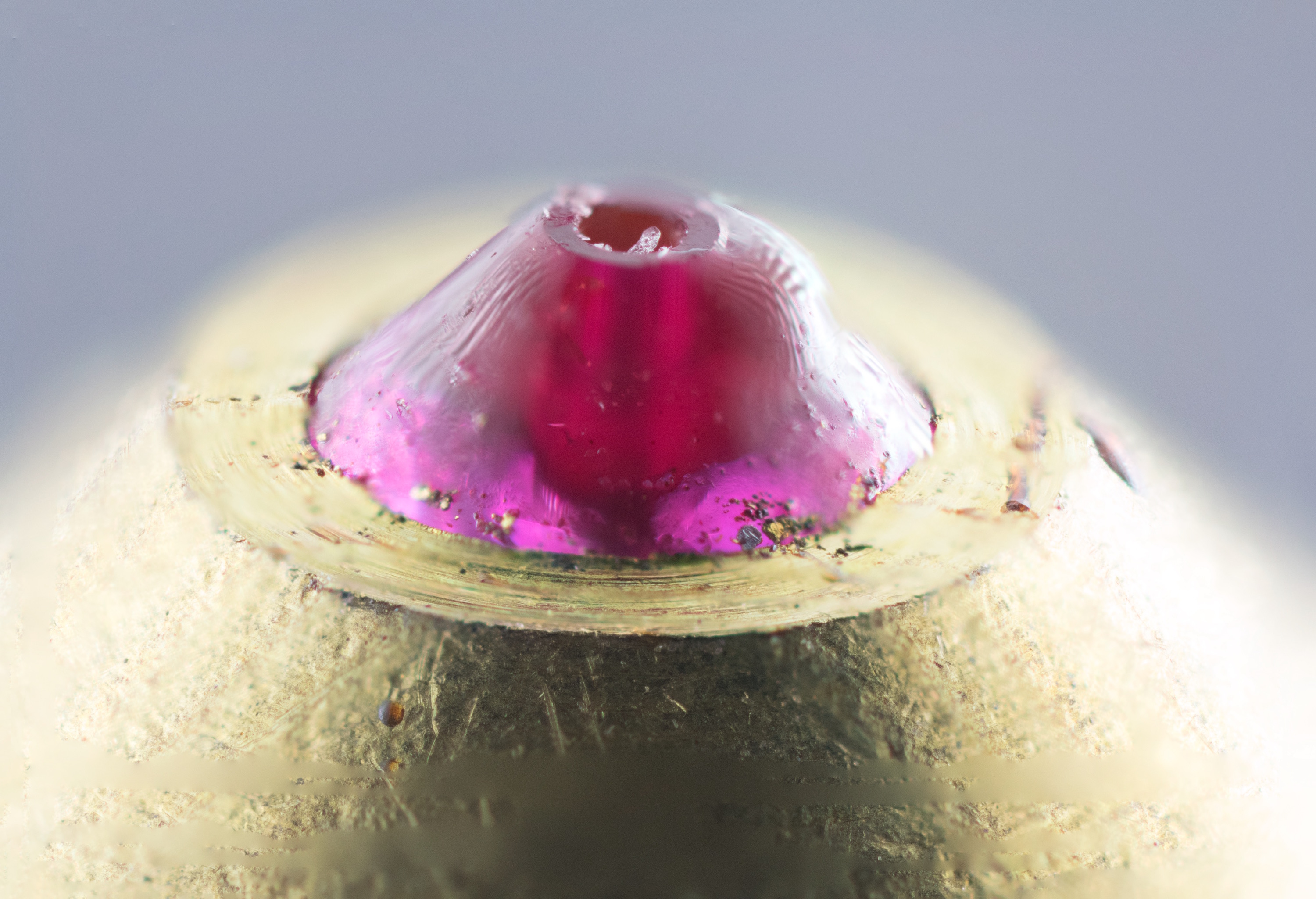

Thanks Anders for sending me a nozzle! (received it a couple days ago)
I ordered some XT-CF20 and can't wait to start experimenting.
A little bit of topic but still: Thought this was a perfect subject for my macro lens and a test in stack-focussing.
Unfortunately I don't have a rig so it's all by hand and far from perfect.
Still, it came out nice so I wanted to share it with you guys:

wow, that is a hell of a job! How do they stay in place?
- Blizz
- Posts: 224
- Location: Belgium
Very good glue i suppose
If it is the same as in clocks and watches, then the brass is soft enough for the Jewel (glass bearing) to be inserted and then the brass just pressed and deformed enough to secure it.

Blizz! That is so pretty!

Nice photo, I wish I knew you were going to take close ups, then I would have cleaned your nozzle properly before sending itBlizz wrote:Still, it came out nice so I wanted to share it with you guys:[/attachment]
Nope, did not find any glue suitable for the task yet.Blizz wrote:Very good glue i suppose
The first prototypes were made this way, but for various reasons I was not completely happy with that method, so the current batch has another way of fixing them.Izzy wrote:If it is the same as in clocks and watches, then the brass is soft enough for the Jewel (glass bearing) to be inserted and then the brass just pressed and deformed enough to secure it.

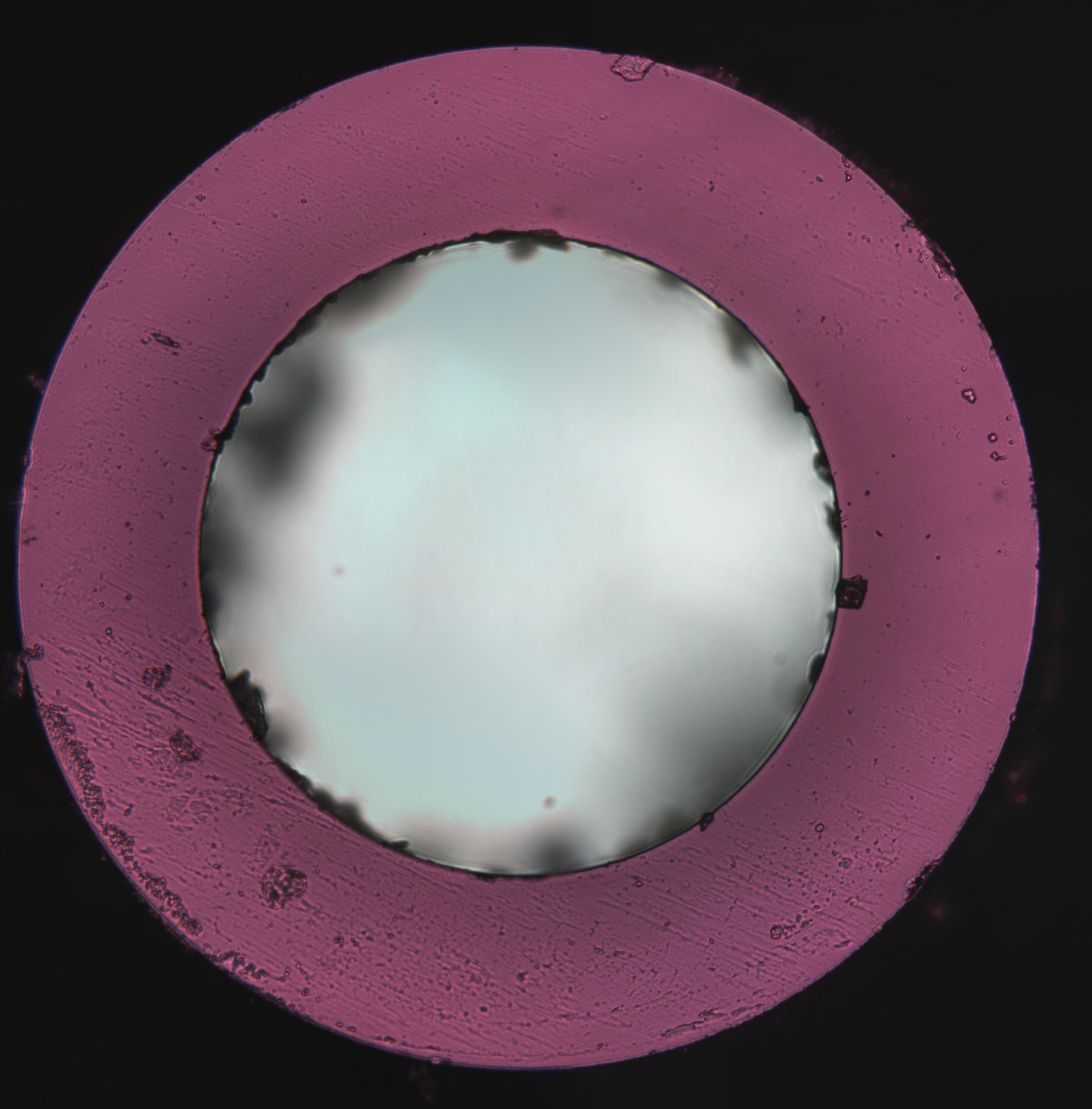

I just received the nozzle that Neotko printed 8 kg formfutura with and the scratches from the manufacturing of the ruby are still visible on the tip of the nozzle (!) So I think today's conclusion is that you are very unlikely to cause significant wear on it with carbonfill
Therefore, please feel free to test it with other materials!

So what was the hole diameter on those? A regular 0.4mm or is it 0.5?
