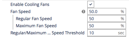

Re: Cura 2.1 open beta
Post by Amedee »
I am trying to cross the bridge and force myself to use the thing...
I am running into 2 annoying issues / bug...
1. Fan control: If the fan settings are not default, then even when enable cooling fan is unchecked, you get the fans running.
Non default setting
Non default setting
Fan unchecked, but fans are still used.
2. Object movement and redo buffer.
When you move an object (like orientation), it fills the redo buffer with intermediate moves, while I would expect to record only the start position.
E.g. I want to rotate my piece. I start the move, but then I realize I can't go where I want (*), so I release the mouse button, and I 'Undo'. My expectation is to go back where I was when I pressed the mouse button, but no, many positions were saved in the redo buffer, so you have to 'Undo' again and again until you think you are at your start point.
(*) this is another weirdness: depending on your initial view, there are rotation angles that the UI refuses to take. Once you know that, you just have to put yourself in a normal view relative to the rotation plane, but I never got that in legacy Cura.
