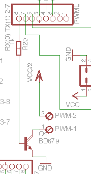

Neotko wrote:Amedee for load I mean the max amps, I remember to saw some posts about the umo 1.5 transistor going boom easily. (Same happens on umo+ if more than 200mA are in use)
From the 1.5.7 schematics, we have a BD679
Screen Shot 2016-02-23 at 16.20.12.png (1.23 MiB) Viewed 21138 times
So we should be good for 4A which is way more that what we need.
The BDxxx series also integrates a flyback diode
Edit: Note that with the 1K resistor we limit the current on the base to something like 2.5mA, so with the 750 gain of the BD679 we probably should not go beyond 1.5A to be sure we are at saturation. But still, plenty of room.
