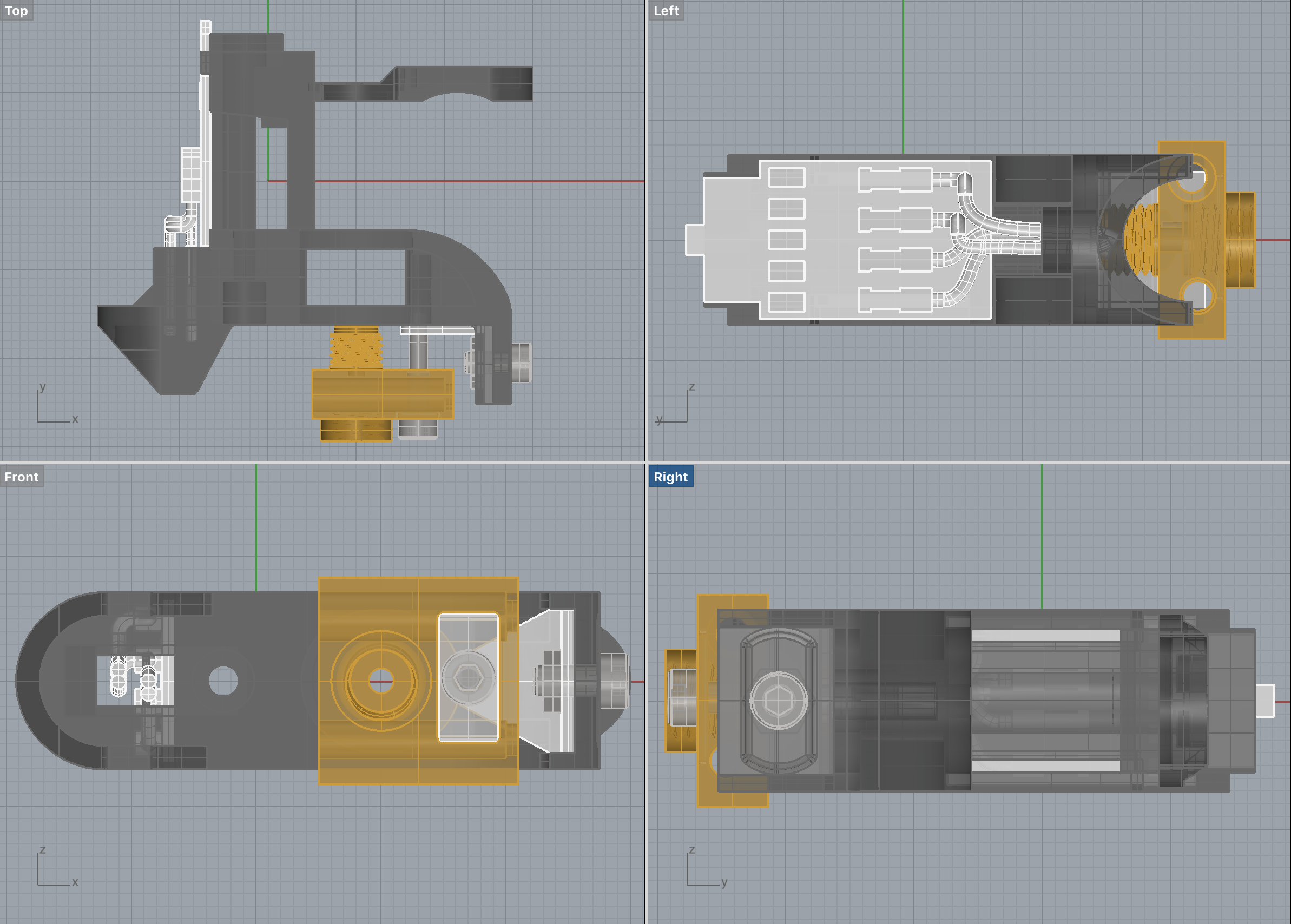

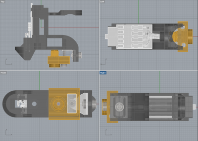

Gudo and I would like to share with all of you the changes done. We will publish the step files of the areas changed (no UM files or info where used to make it). This way we can share with the world the flexible fixed point solution, in hope that someday someone takes notices and pushes the quality a bit forward.

Clever of you to to use the Non Commercial Share Alike license!
That can potentially save you and gudo lots of trouble. :-)
One question regarding the design:
Is the bent metal piece really strong enough to absorb the torque when changing nozzle, yet flexible enough to allow the core to center in the seat in the print head in the down-position?
Or do you align the components somehow when assembling the core?
Or is there enough space inside the print head that the plastic frame can move in all directions to compensate for alignment issues?
Re: New heater block to fit standard nozzles on Ultimaker 3
Well the non commercial is the license I always use for anything I upload. Also we only published the modded prts even though we could have published the whole core, I think is only fair to share the parts of the mod since the other parts are UM made. Also as I told you from the beginning we are interested on improving the print quality not making $.
About how hard it is, you try, is a very easy mod to make and it can be removed quite fast leaving the core as it was (mind the new hole on the black peek so the screw can go in/out when flexing).
Also Gudo and I shared all this mods to UM and asked Sander for permission if was ok for us to share our findings.
