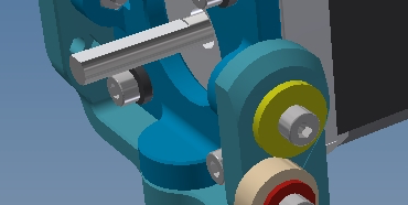

Umm maybe I didn't understood. Photo? I'm too sleepy
Posts: 438
Re: Zero Gravity Direct Drive Extruder
Post by nilrog »
No, it's the spacer between the "yaw" and the part where you screw the stepper into. I tried to reference them above by their name in the zip-file ;)

It's one of the parts named "FLEX" that is part of the Nema17 zip even though you need it for the Bondtech.

Can you check with the full stl assembly ? I don't get it. Sorry I'm really dense atm

Ok, I was probably a bit confused, i'm down with a flu this weekend :( (the "man-cold" version :lol: )
I was referring to this yellow piece where the screws to the motor holder goes through:
And I though that the "Motor support damper-FLEX.stl" from the NEMA17 zip was this one...but I now see that it is the one that will hold the NEMA17 motor instead.
So I guess that the yellow part is this one, "Motor tilt spacer support-MEDQ.stl"?

That yellow part is solid, not flex.
