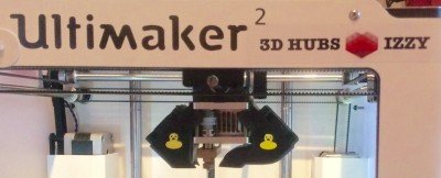

I like Gudo's designs for the fan ducts and if I wasn't very happy with my design I would give this a try, a quick question your Fans, what's the spec and where did you get them?
I've been testing different materials recently and as well as various PLAs I've also tried some ABS, and Igus, as well as others, what I have found is that even for materials where they say no fans I always run at low speed just to keep some cooling air flowing through the ducts preventing them getting too warm.

Hi Gudo's, cheers for the info.
I do have to dial down the fan sped for my new ducts, using the origional fans I measure 6m/s flow as the duct was designed to flow and then focus the air, these small fans can't handle back pressure, they will still turn but not push the air through, I found some duct designs would suffer from back pressure when close to a flat surface. That's why I designed them so that the vertical height can be altered, as well as the small notch that is close to the nozzle, it helps to prevent the back pressure.
