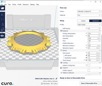

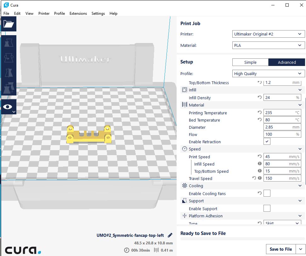

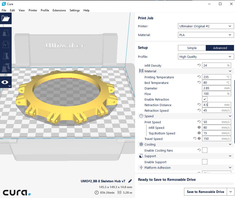

I have today off so I am experimenting with nGen and Cura 2.1.2
First thing I noticed is the fans turned on despite being checked off in Cura.

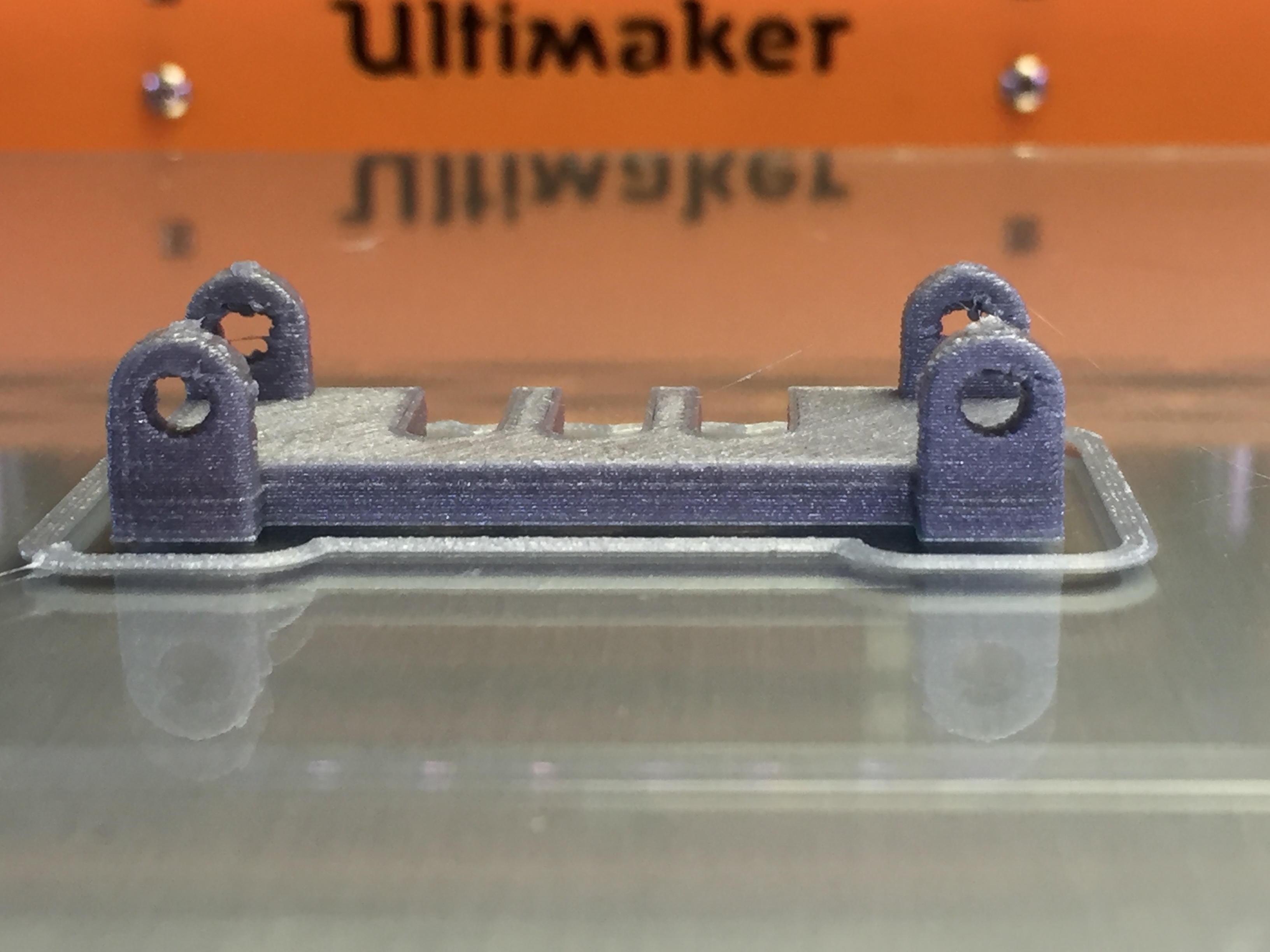

Trying one of Neotko's shroud pieces as a test, since it has mounting holes
Posts: 4063
Re: nGen ?
I'm impressed!
But how can I make those holes a bit cleaner?

I think I found it...Cura 2.1.2 didn't have the right retraction settings (25mm/sec and 3.5mm)
Using the settings from ColorFabb for retraction

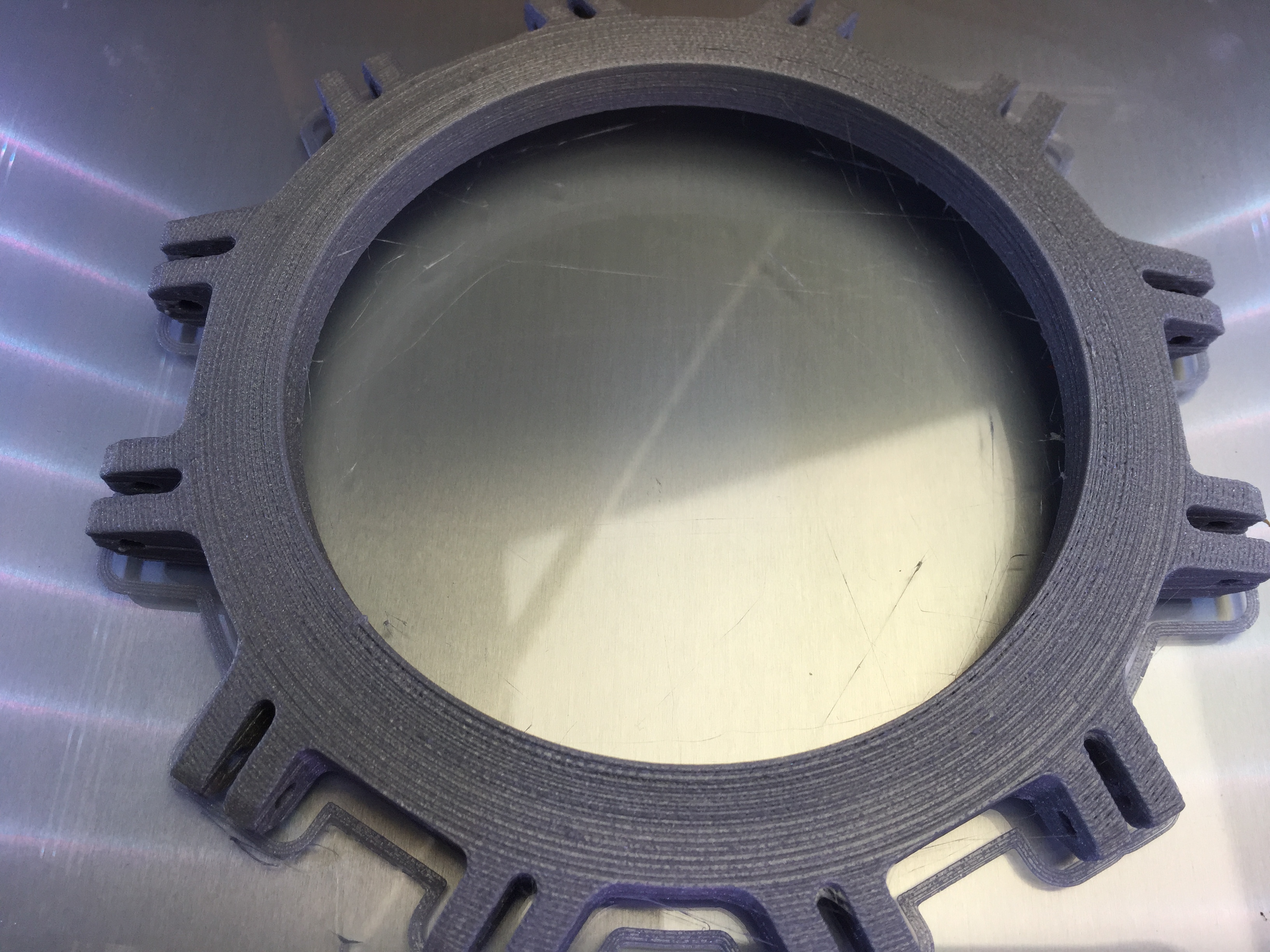

Posts: 4063
Re: nGen ?
Interesting on the first layer. Maybe retraction is too high. It seems to flip the edges up on portions of the layer. A few more layers now flattened it out

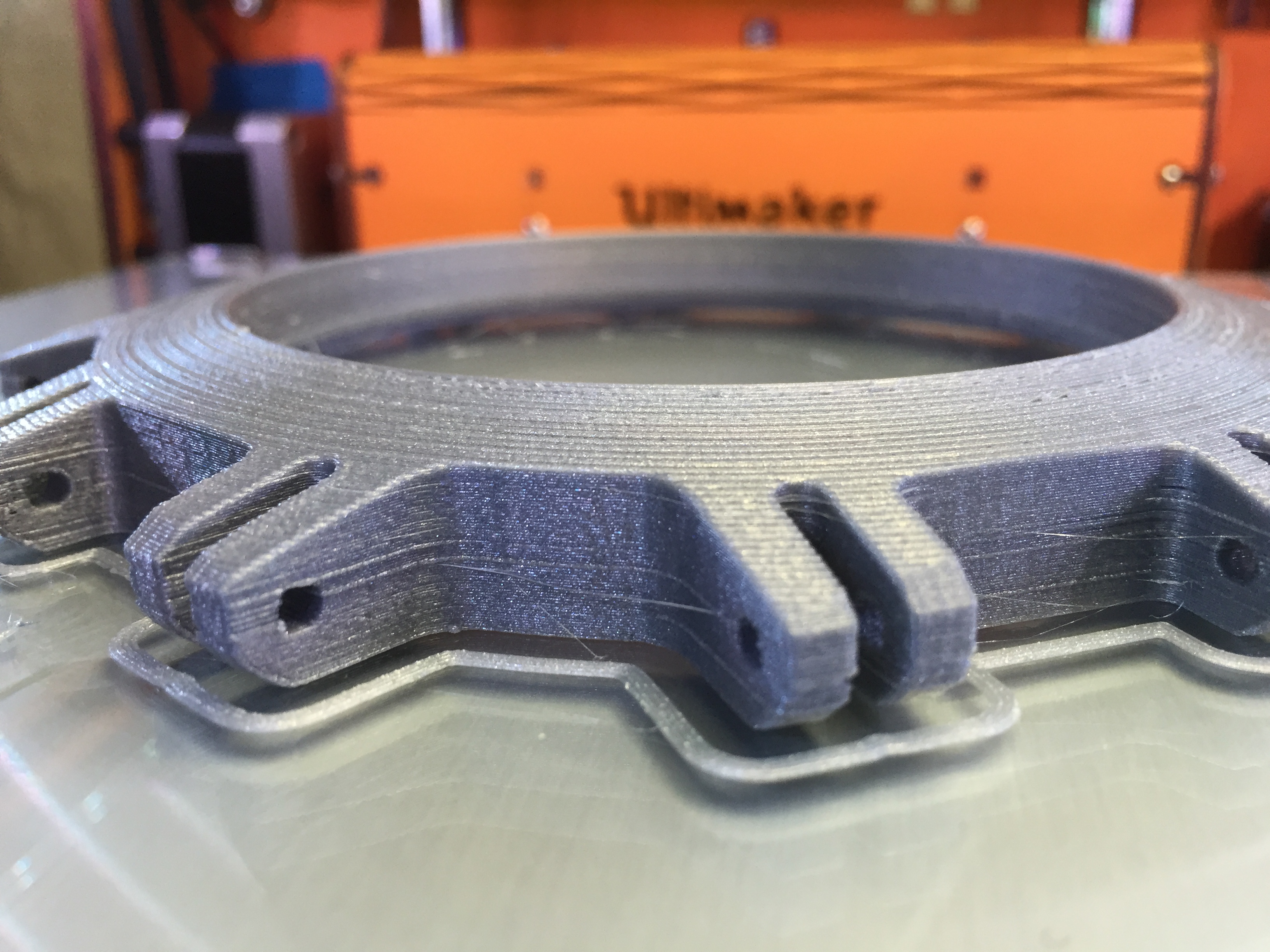

I'm not sure what coasting does but my nGen print was alright , not super. A few gaps. But this stuff bridges well, minimal 'hairs' around the circle. And compared to the PLA prints, the back is a lot nicer
PLA on right
It took a lot longer than the PLA version (4.5 hours while nGen took 5.7)

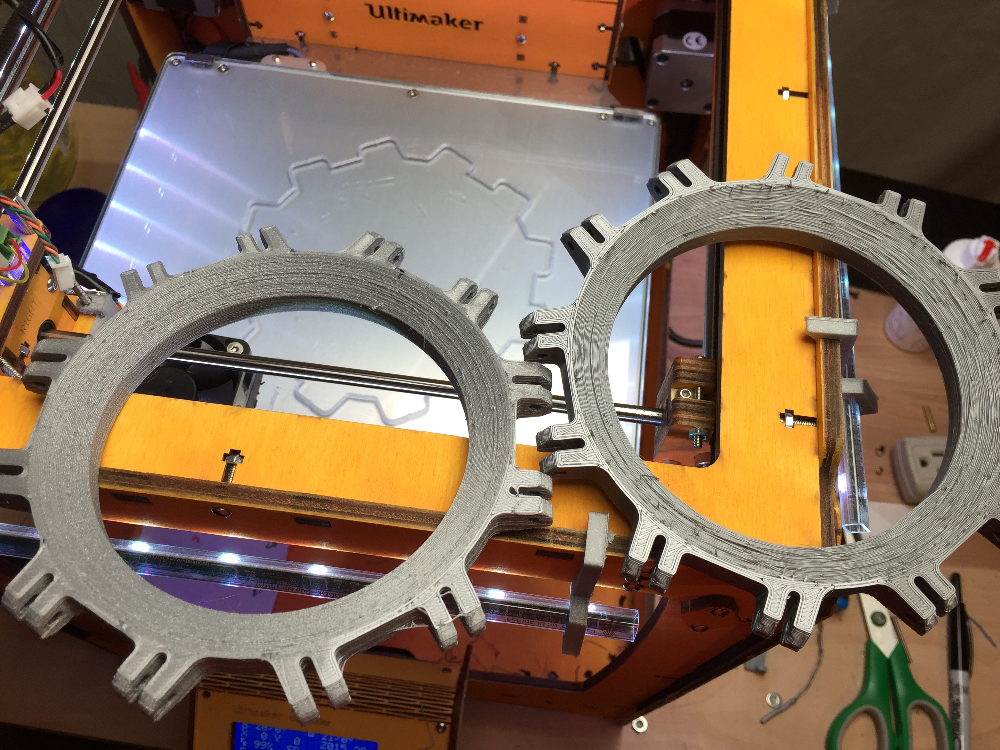

I've done a number of these parts now...and it seems only nGen can eliminate the "hairy" effects that PLA shows on the bottom of this piece.
I originally did 8 with 25% infill with PLA but I decided to make some with 50% infill since the aluminum frame attachment spots could stand to be beefed up. I need to check, I know the temperature tolerance is higher with nGen, but not sure the strength is any better?
