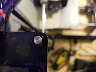

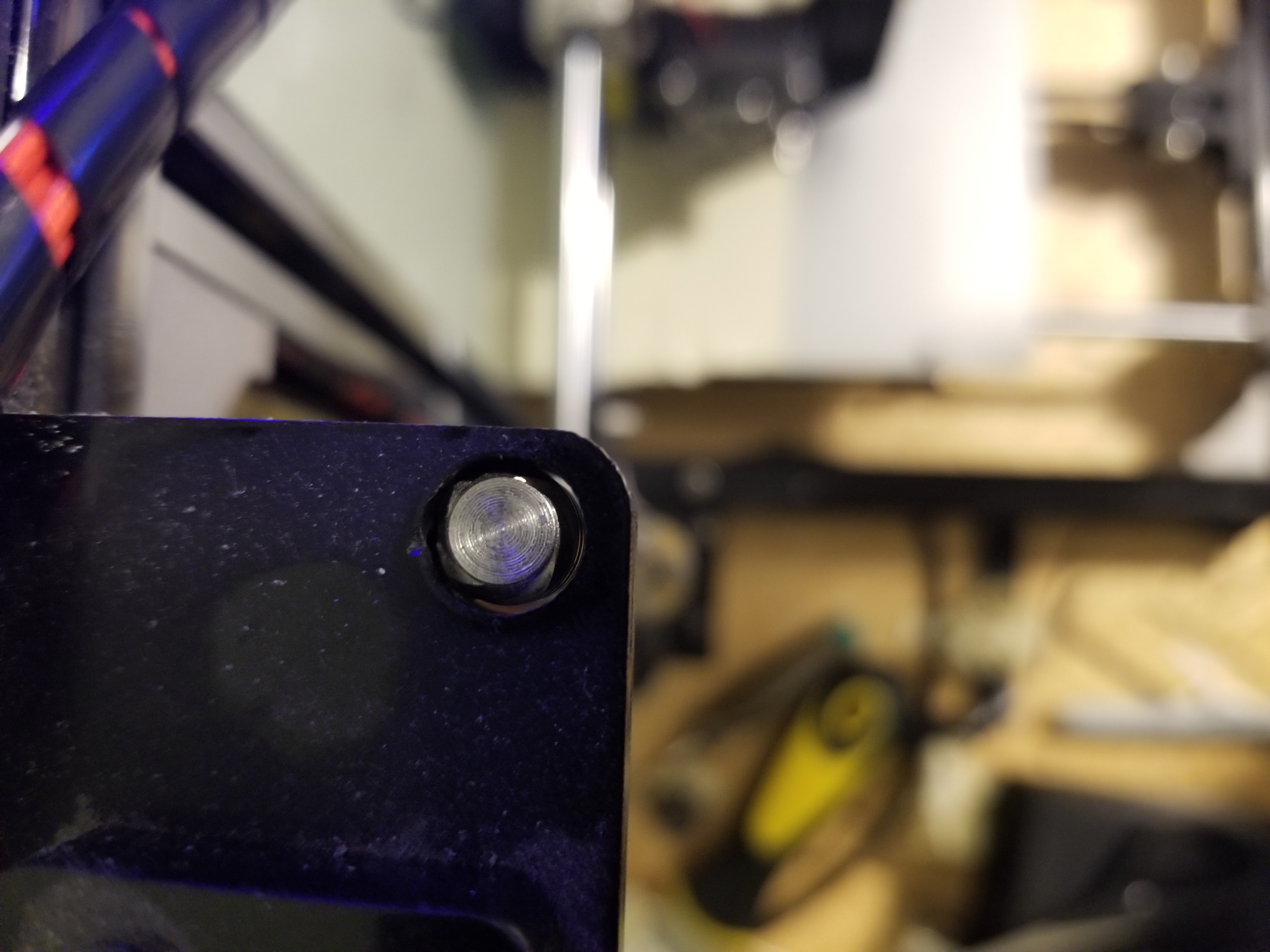

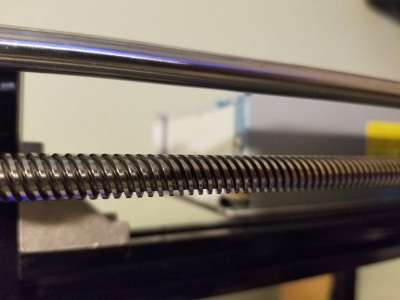

Here are the pictures of the lead screw.

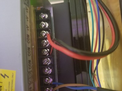

I also checked the voltage from the 12v output from the psu. 9.5 is what it says while the printer is running.

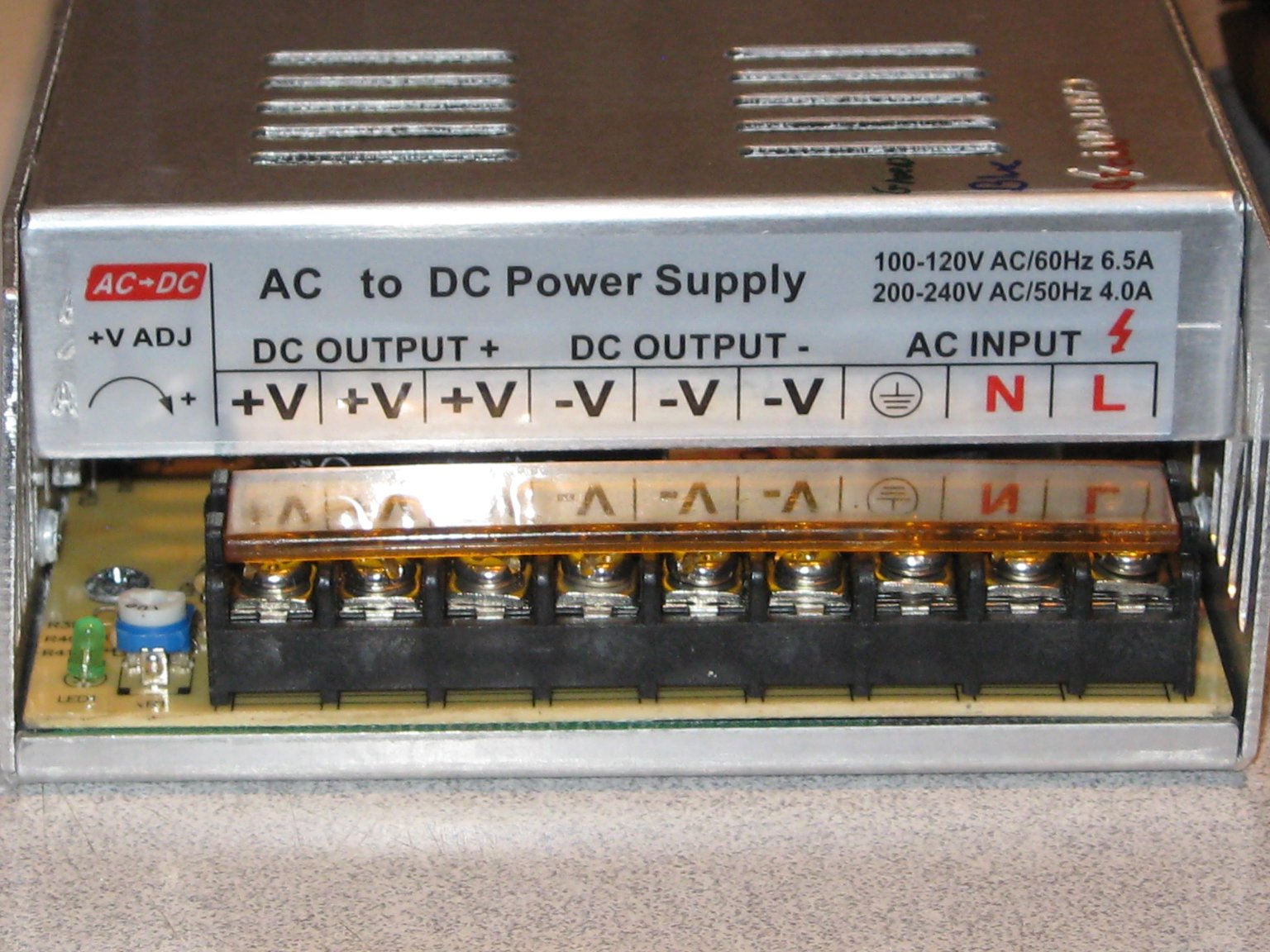

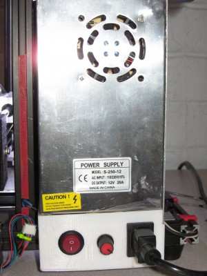

You measured the Voltage on the Power Supply terminals at 9.5 volts.
Your power supply should look like the above photo.
On the Left there is a voltage adjustment, have you tried to adjust to get 12 volts when 3D Printer is running...
Caution do not force the voltage adjustment lightly turn to about 12 .6 volts when running.
Mine sets about mid range the adjustment.

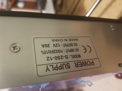

I would also like to know the what is on the power supply label voltage and amps.
I have a 12Volt at 30 amp supply an believe me it take it all.
Oh! another item them running for a while if the Power cord warm or even hot if so need a better power supply cable.
I took an old computer power supply stripped the parts using the power connector and cord on my 3D Printer.

Here are the pictures of my PSU. The screw to adjust voltage for mine was on the right side. I believe I was able to get it up to 11.9 while printer was running. Afterwards prints seemed to come out pretty bad. Bed at 60degrees causing elephant foot and bad layer adhesion. 40 degrees seemed to fix that but my prints are still much worse since changing from stock firmware.

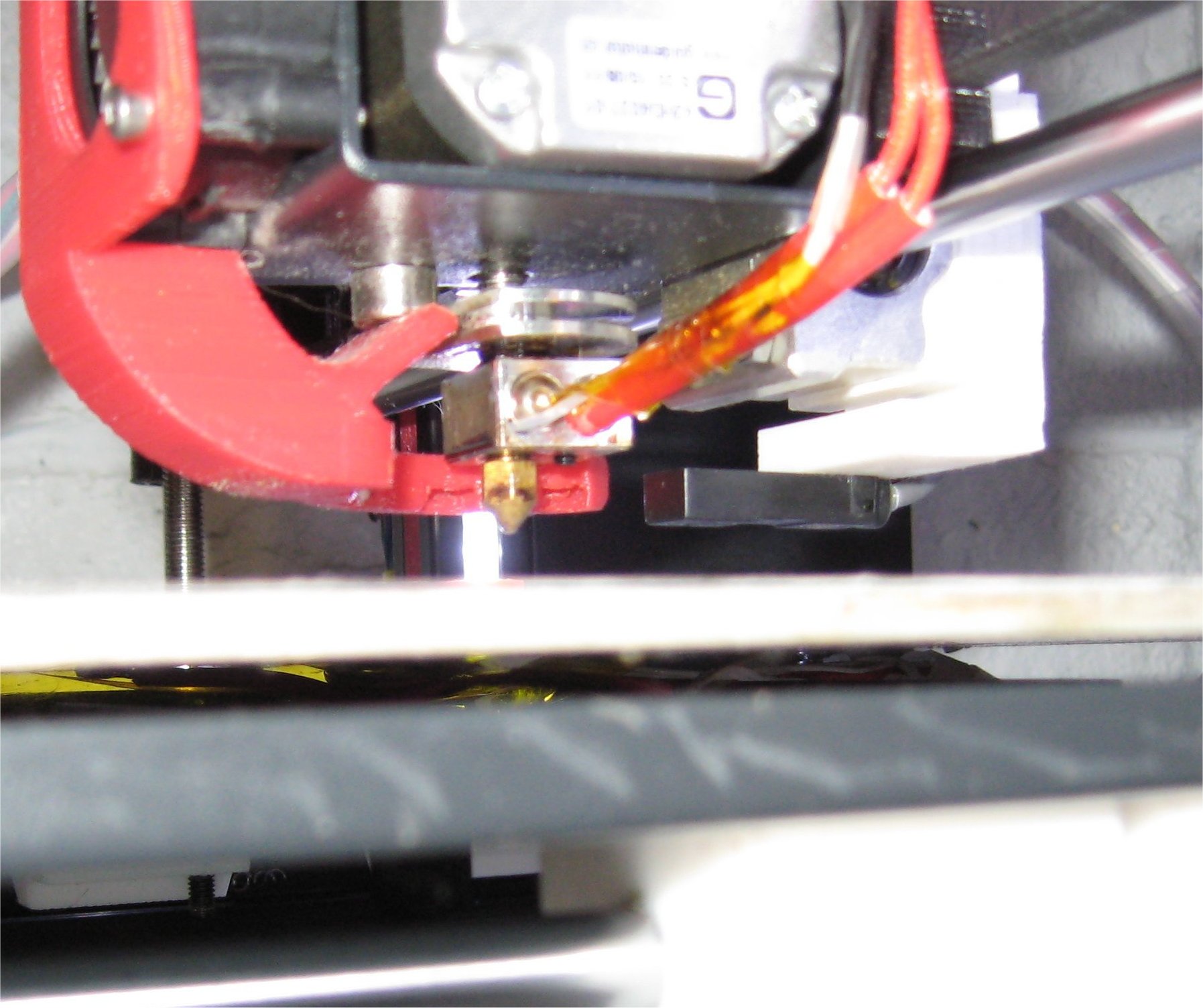

My part cooling duct allows the air to keeping the throat cool giving it a longer life.
It also helps when preforming functions like 3D Printing a bridge.

Alright. I think I'm down to my last big issue. I've printed a couple cooling fans and while they are slightly better then stock they still leave much to be desired. Could you post a link to the fan duct you used? I didn't see it listed. Thanks again.

This is a remake of my re-design
I have posted the information Here
More on this subject below
Fan Duct

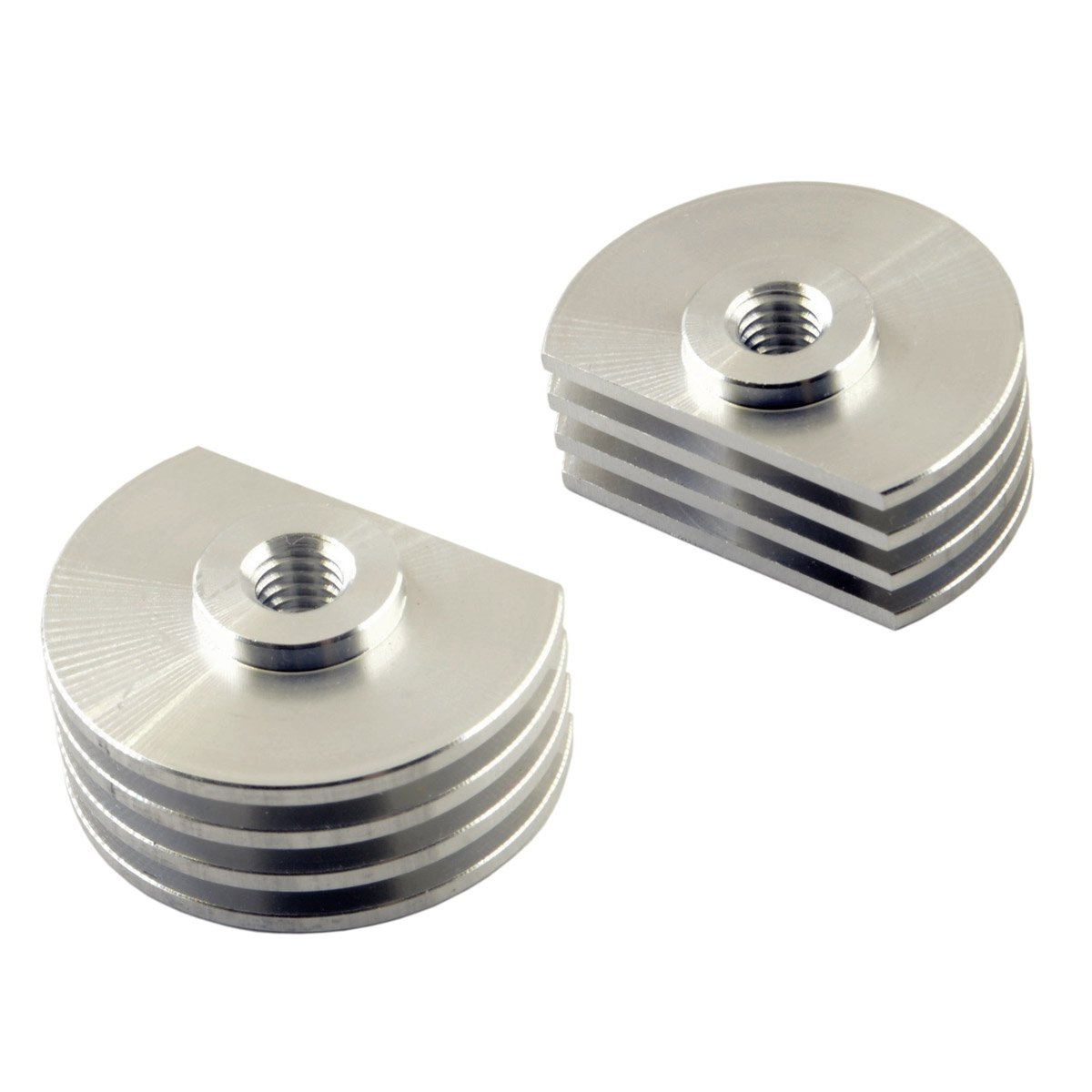

I have not ideal where I got the heat-sink fins
Found some here you could cut to make half round
