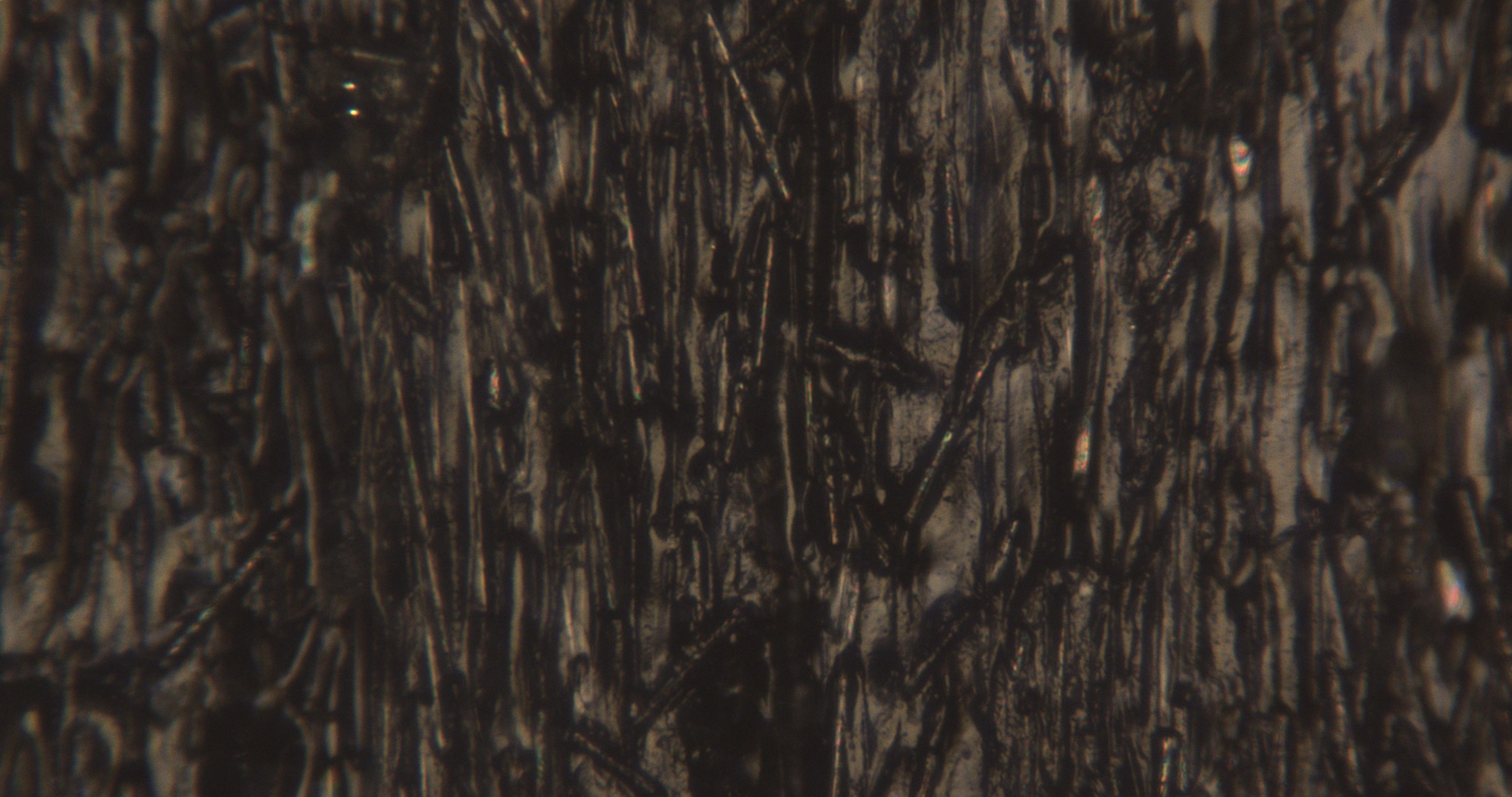

Here is how the fibers look when printed at 0.05 layers with a 0.4 nozzle at 50 mm/s
The fibers appears to be about 5 micrometer in diameter and 50-100 micrometers long.
Next up is to test print "nozzle killer V2" :)

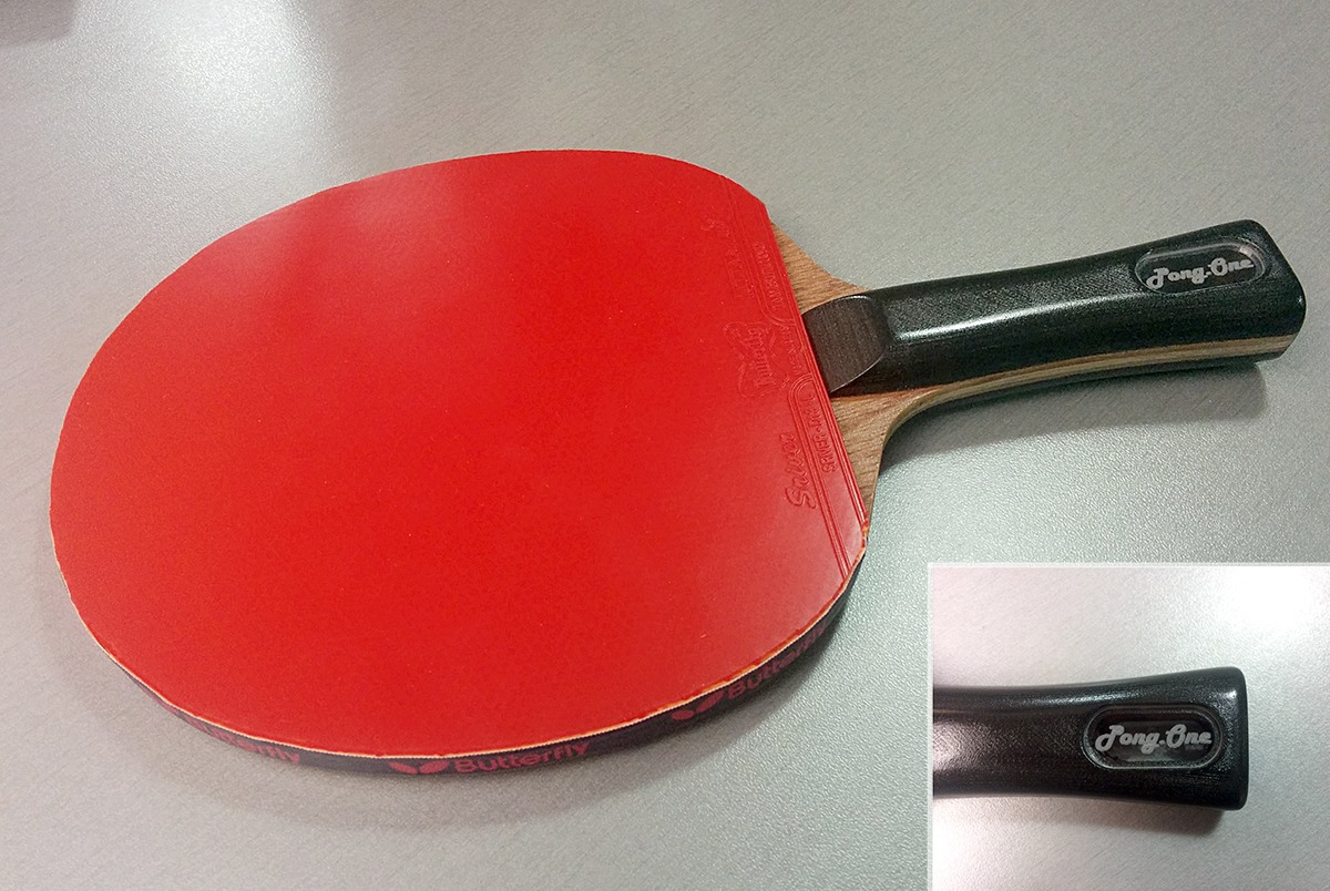

I made this thing last year, lasercut the wood on my laser, and printed the handles in CF20 on my E3D V4. The paddle itself was modeled after an old Joola model which I had when I was a kid. Turned out pretty well, the photo shows the handles after sanding and a coat of lacquer. The thing I like most about the CF20 is how well you can sand it. If you're doing stuff which has big flat surfaces the finish is really amazing.
Re: ColorFabb XT-CF20 Carbon Fiber Filament
Superb

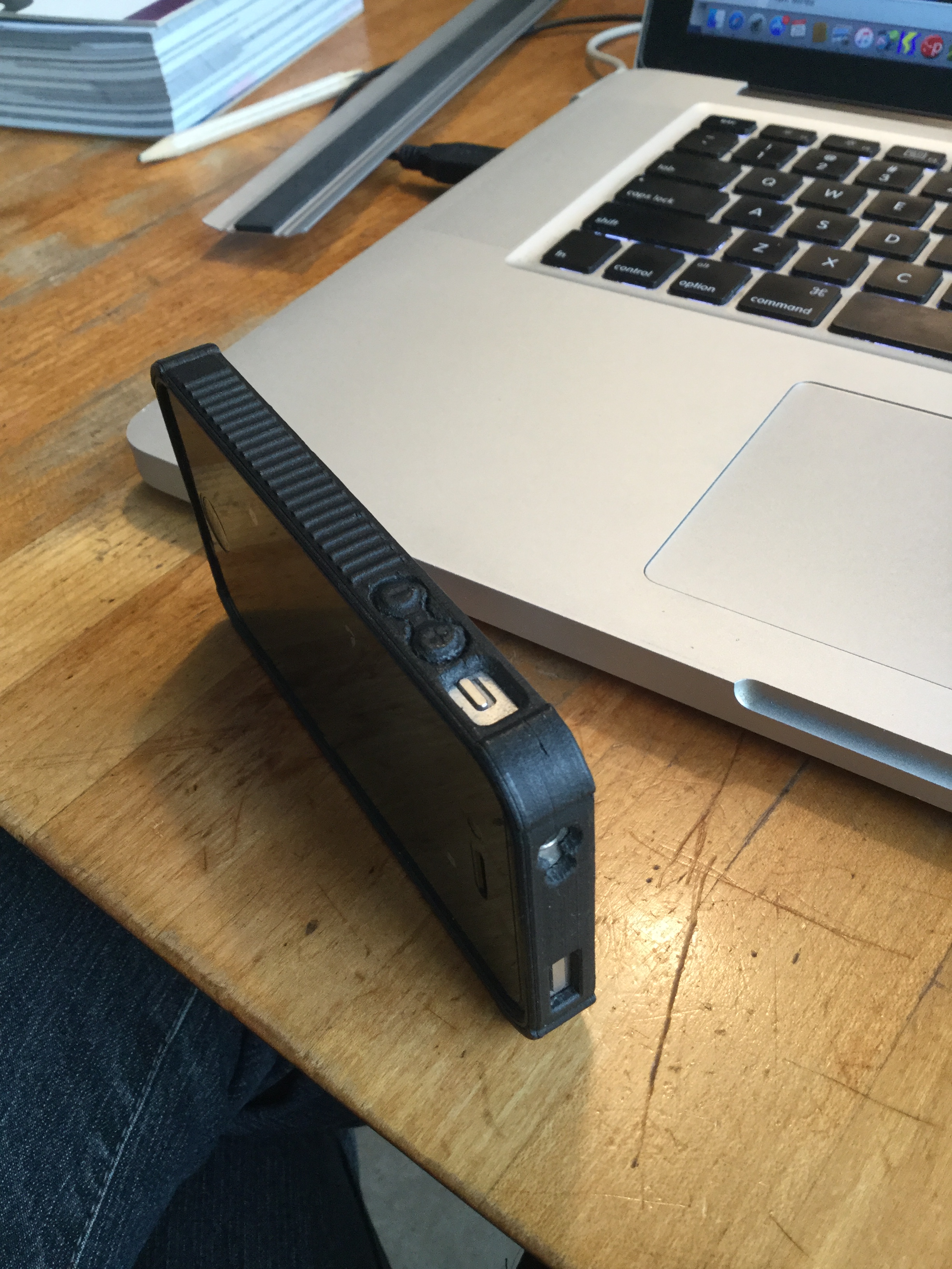

XT-CF20 phone case
XT-CF20 phone case
the print I did, a phone case, with XT-CF20 was pretty amazing! That surface looks and feels real impressive! The best phone case I made so far. All the others would split along the horizontal lines, like flex and woodfill.
Settings:
layer height: 0.16
speed: 30 mm/s
temp: 250
bed: 70
no retractions
no fan
printed on the UMO-HB with normal brass nozzle. I had a few meters of filament as demo, so I guessed that would not ruin my nozzle instantly...
Having no retraction was a precaution for a constant flow of the material, as the strings are really easy to remove afterwards, and to prevent the heat creating up. Do this also with the metal filaments (brass, bronze, copper).

flow was 100%, for the metal filled filaments I use a 105%.
I remember I had some blue tape on the glass (and heated bed), because the touch surface is small, only a few lines wide. Added a little brim to help there, 5 lines, which are also helpful for the leveling at the start. Hardly do any bed leveling, just add a few brim lines and turn the bed screws, if necessary.
A lot of the settings depend on the shape of your model, so going slow here and turning of retraction made a nice even surface.
