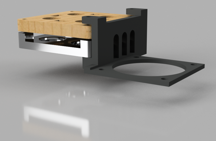

I reprinted the fan holder adding 1mm gap for the 'sandwich' part, I find it better that way.
At the same time I started playing with the new Cura ;)
The design (I like renderings...):
Fan support remix
Fan support remix
The print:

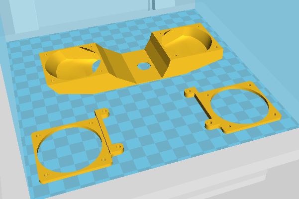

I have a question with the fan left and right pieces....there isn't a top view, I am wondering if I have them mixed up.
I have drill and tapped the holes. Just want to make sure I place what is "left" on the left side, etc. Using Cura to visually explain!
Is this the correct orientation? Or do I have them reversed?

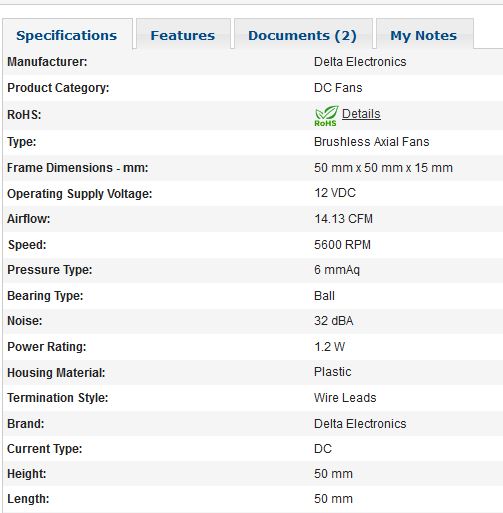

I'm curious about the fans you guys are using. I was testing mine and they move a LOT of air...I wonder if too much?
Here's the specs...
Re: Fan shroud upgrade

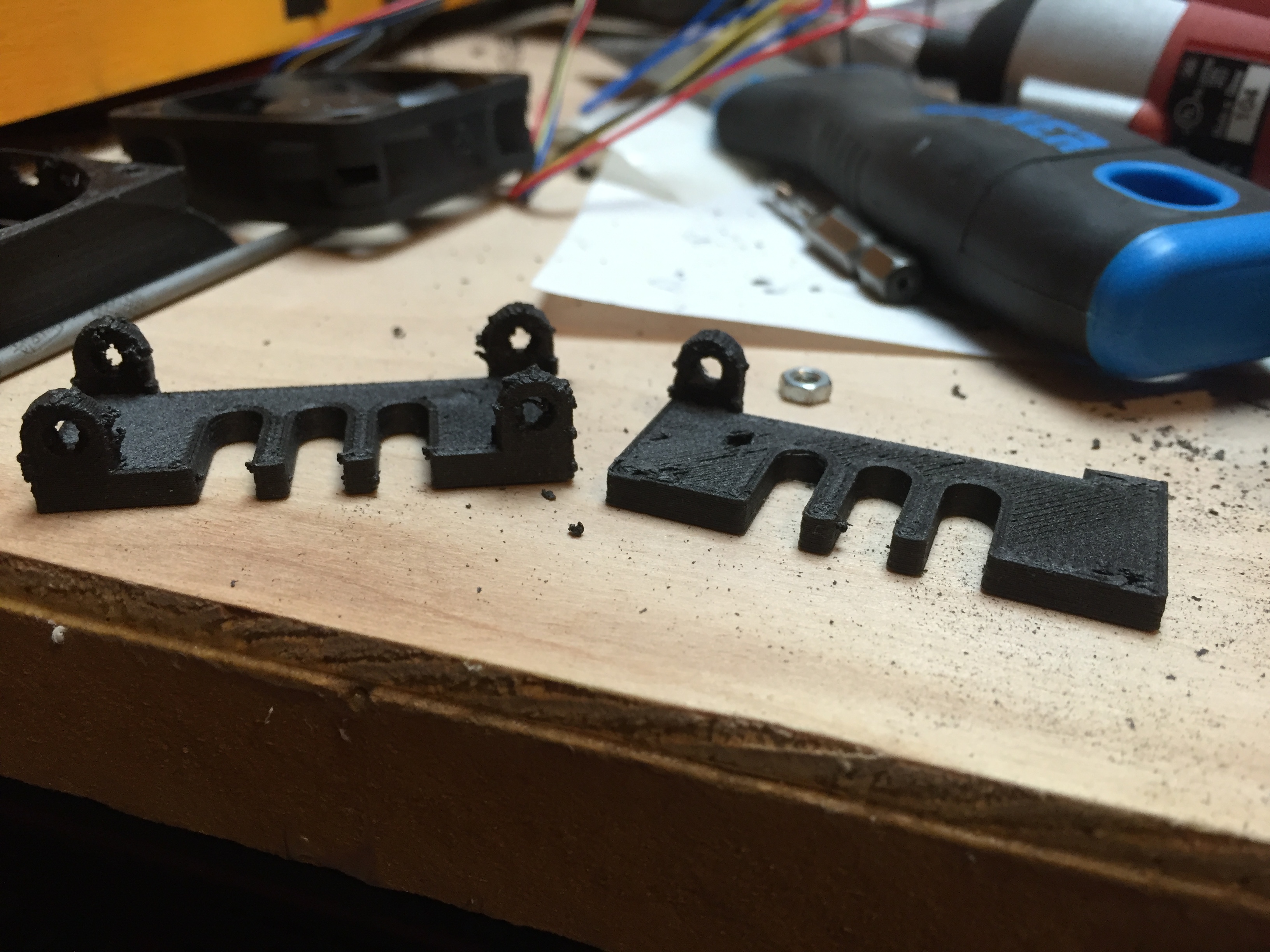

Amedee, tonight I was carefully drilling the holes out of the "fancap top" left and right and the tabs broke off on each :(
XTCF-20 just isn't good for those sorts of loops! I need to either print them again or find a way to wire up and use temp shroud to print in PLA/nGen/something that works!
I don't think it's a filament problem but just a bad print. I have drill 6 of that parts and they can hold a lof of force, never broke one. If the other parts have that bad layer bonding you might have problems with them...

- Re the position, yes it is correct -- the idea is to bring the fans forward to get them centered around the nozzle.
- Re the fan speed, I don't think somebody really knows the specs of the original one, but it is blowing pretty hard... Two of them might be a lot. I went to 24V fans, it looks to me more reasonable in a dual fan setup even on the UMO. Of course you don't have to use yours at 100%
- For the parts, if it breaks so easily there is something basically wrong, XT-CF is supposed to be strong. Also afaik these ones are 3.2mm, so they should fit without drilling. In my print I just go manually with a 3mm drill bit to deburr (but there wasn't really something to deburr)

Well, I can try the print again and just go very slow and steady. XF-CF may be strong but it really, really struggles with any over hang/minor bridge.
Fans...I was looking at the airflow CFM. It does push through a lot of air, so perhaps this is exactly what is needed! Or...my Ultimaker will hover :D
