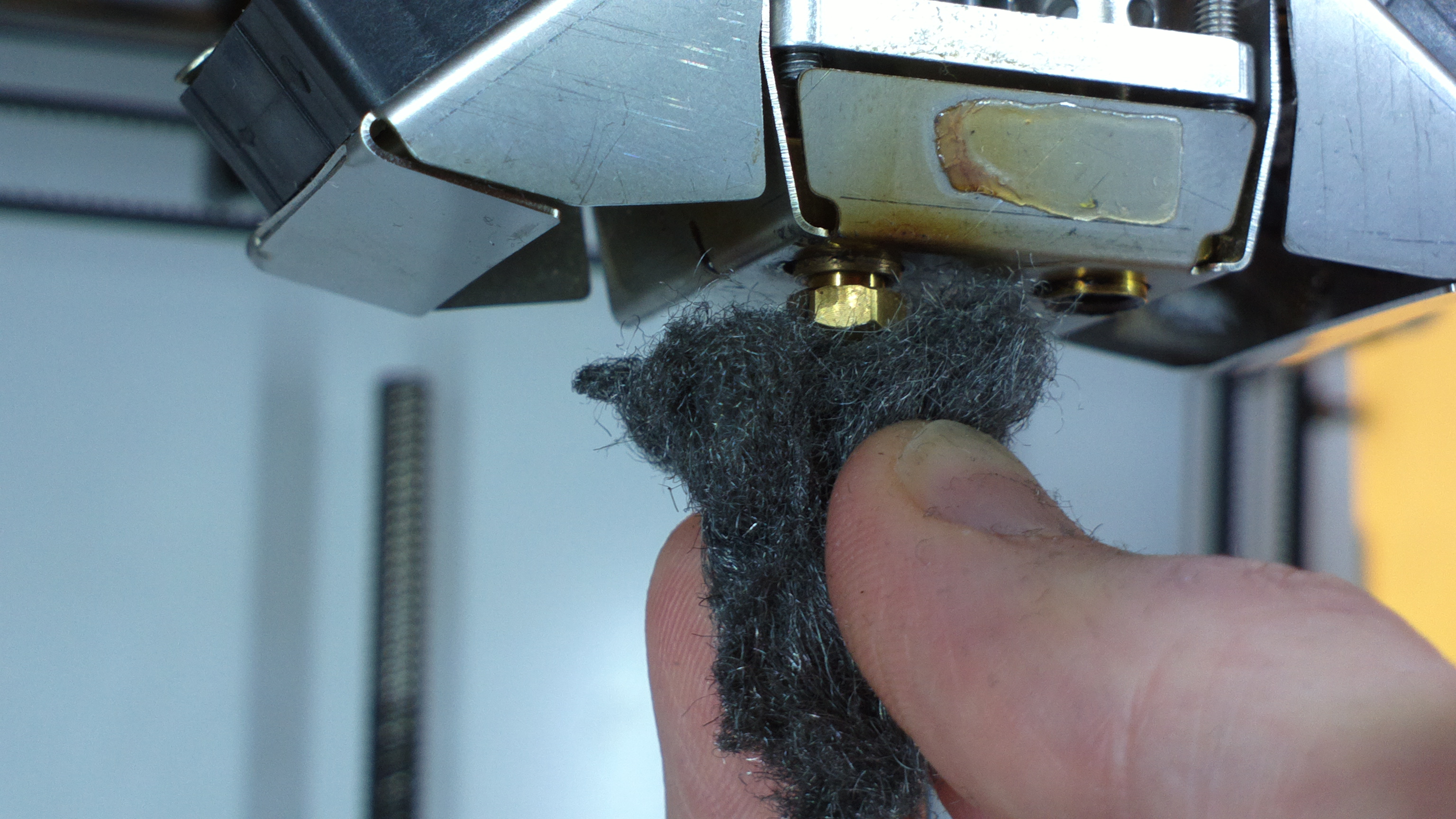

I did some tests on using steel wool to clean the ruby by the way, it seems safe I would say.

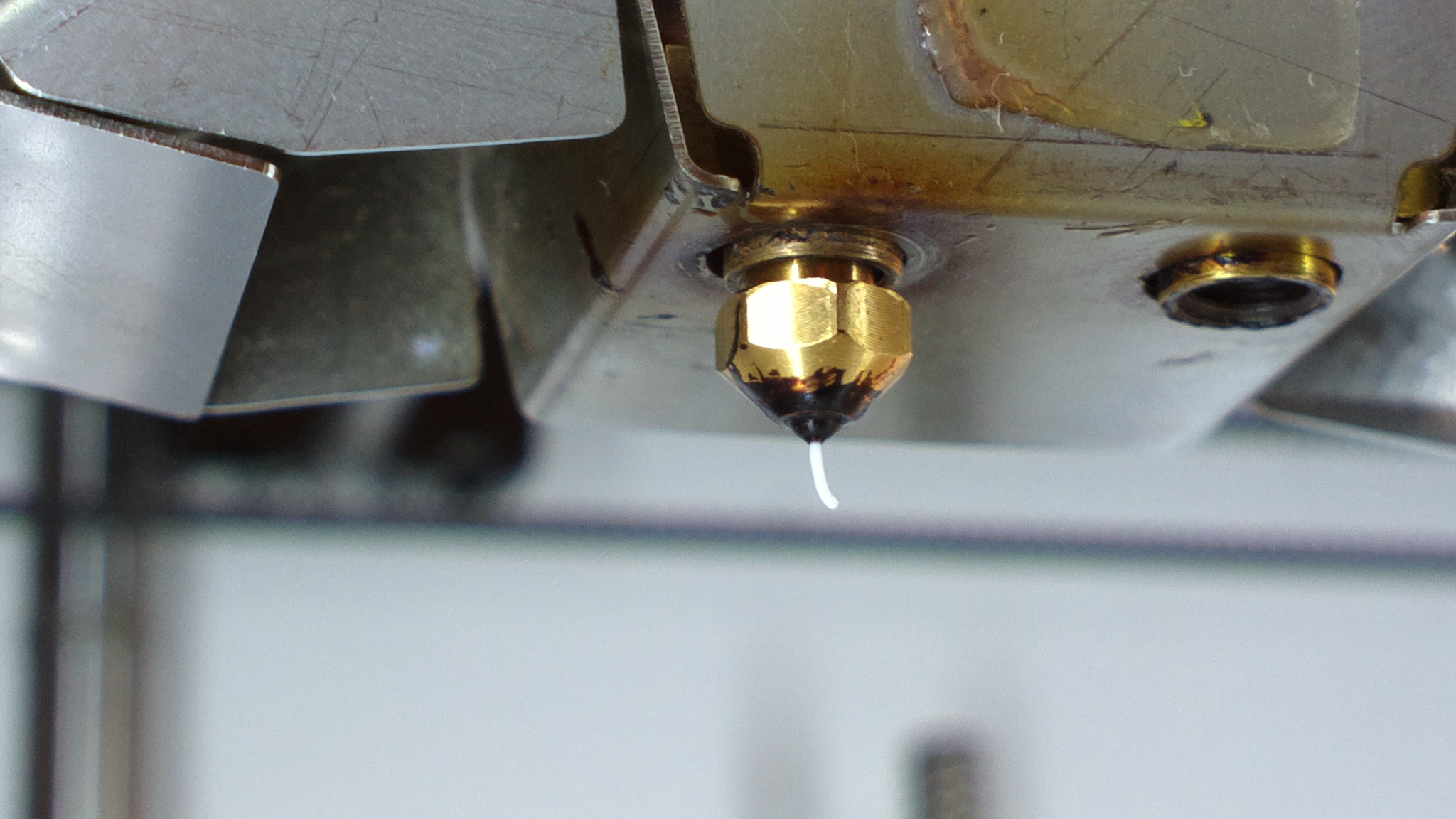

Nozzle after 40 hours of ABS-printing:
Regular steel wool, nozzle heated to printing temperature:

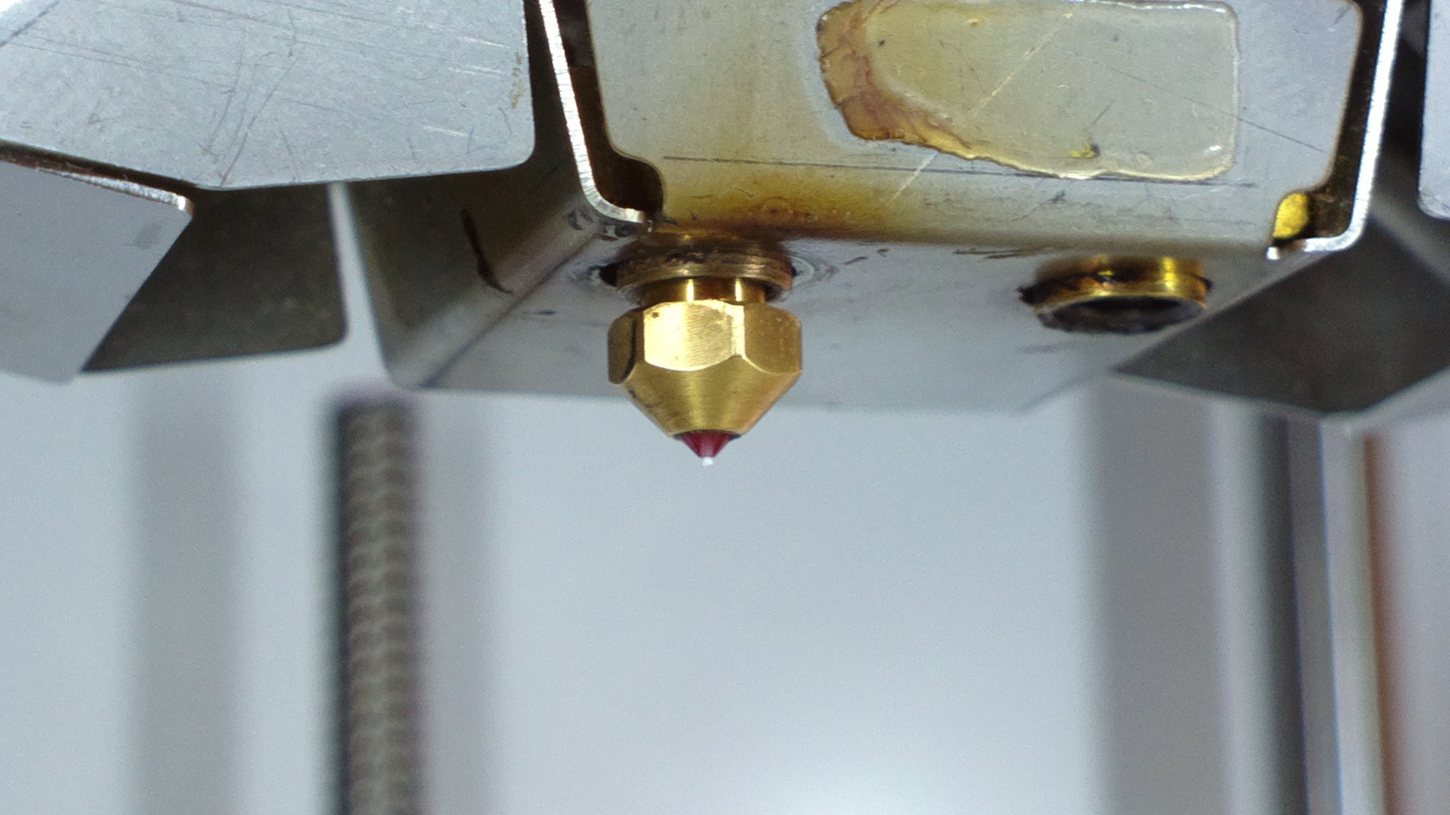

Nozzle after cleaning:

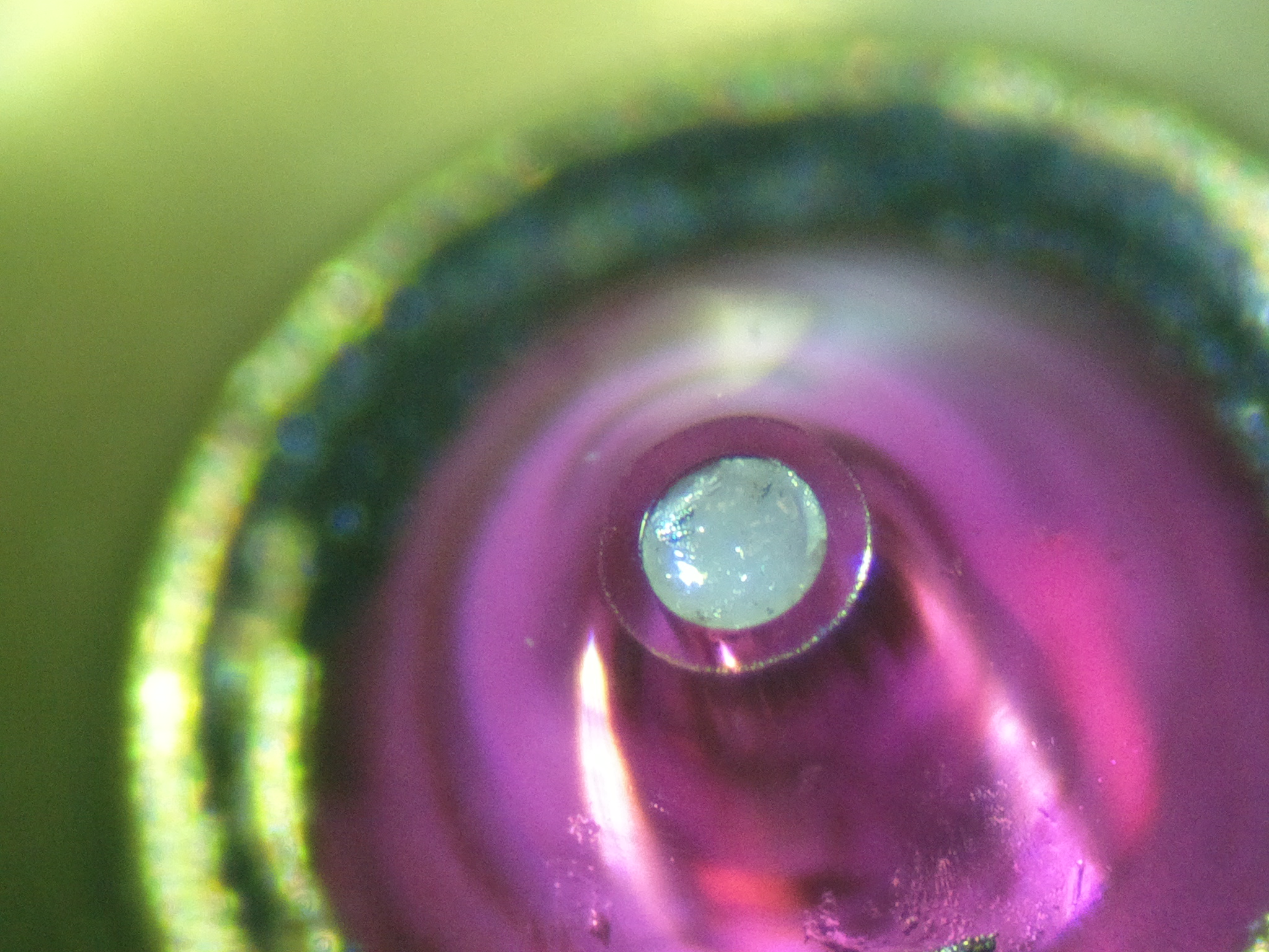

Closeup of ruby:
What appears to be a slight wear of the outer edge of the shoulder is just a reflection I think, will have a look on in a better microscope another day.
