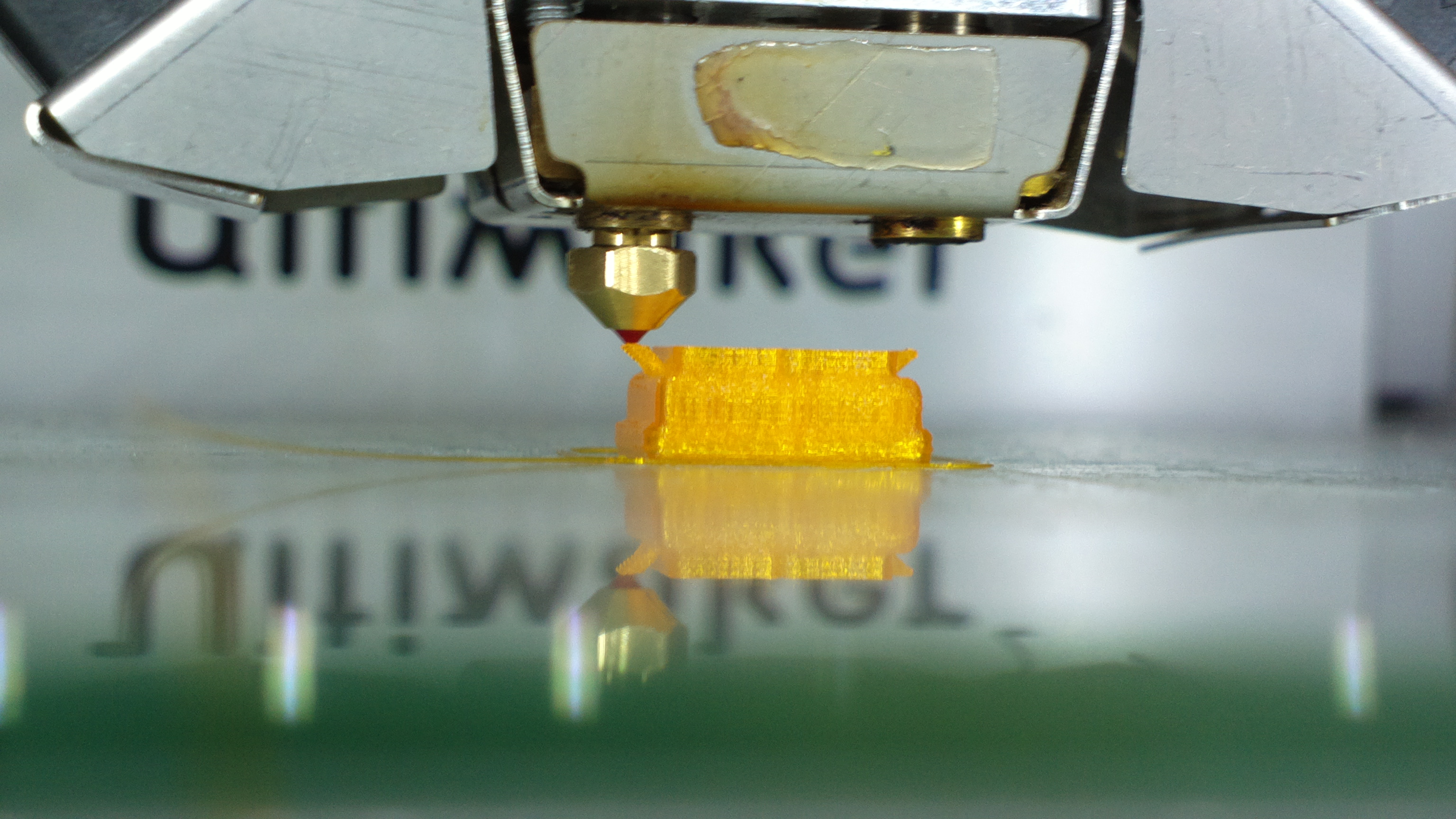

@Anders: Might be of interest: Tungsten nozzle :)
Yesterday installed back the Ruby nozzle and printed some
E3D nozzle
Ruby
But I had to uninstall it, since my alu umo+ block screw died (aluminium suuuuucks) and after trying to fix it now the pt100 it's totally dead (was in bad shape already). So now I'm waiting to assemble a um2 hotend and forget about this umo+ hotend on one machine at least.
The number of thinks that have died on my main umo+ look just like a 'built-in obsolescence' just after 1month of warranty off, heater 1 board controller died, now the hotend goes bye bye with the pt100 on the way, oh and also heater (cable) 1 also died... /sulk
Posts: 4077
Oh sorry to hear that. I haven't touched my printer in a month, so busy with CNC parts
I am trying to see the differences between the two prints, look good on both!
Indeed now that I removed the um2 feeder motor and fixed the error number 21 on my 1.75mm assembly, it prints just like the other with the bonis of overhangs and a much better layer over layer depositions. But ofc to see the difference you need to print the stuff over :D

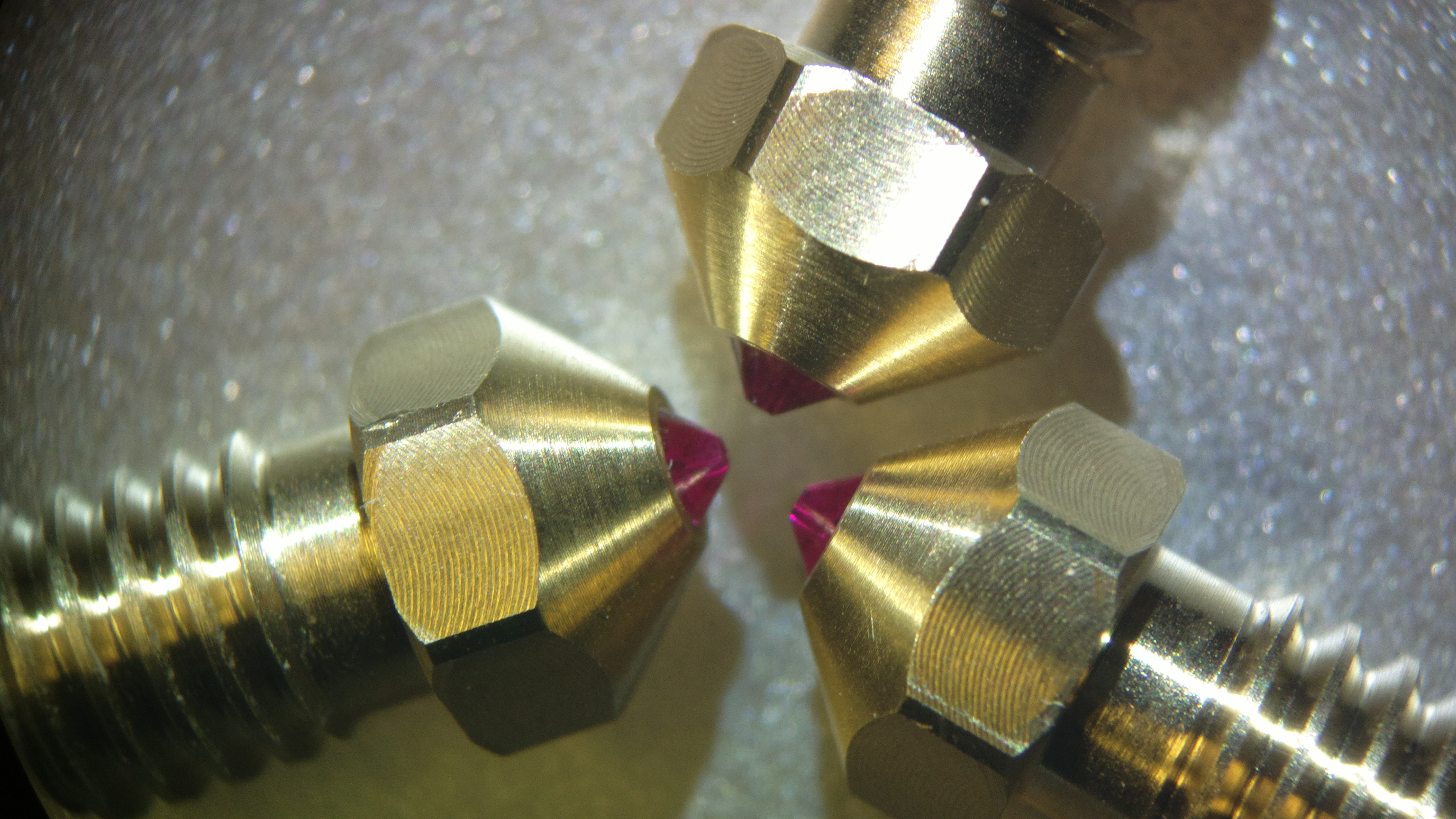

So, things are finally moving again here :-)
I will start collecting addresses shortly of those of you who did not get a ruby nozzle yet.
It has to be mentioned that these are still prototypes, although made in a professional workshop.
I have already made a few changes for the next batch to make assembly easier and make the nozzle more robust.
That does not mean the prototypes are bad in any way, just that you might be slightly more likely to ruin tham then the next batch.
What I would like feedback on for this batch is the fixing of the ruby, potential for leaks and the thermal conductivity (printing at high feed rates).

It looks damn sexy!

Post by Blizz »
Soooo prrrrreeetty :)
