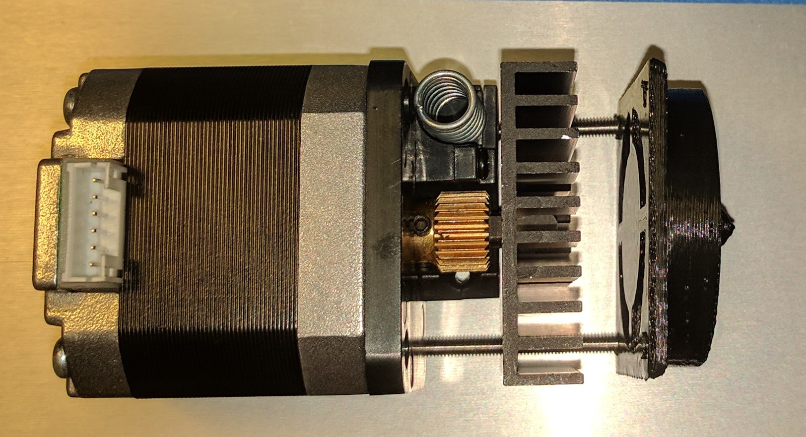

I got everything re-assembled after replacing the bearings and all looked ready to go. I went to print a calibration cube and ran into my old friend "not a damn thing is extruding". Nozzle is at temp (200), filament seems to be seated in the extruder motor and should be making it down to the pipe, but when I hit "Print", nothing comes out. The carriage goes through the motions like it's printing, so at least that works. When I take off the fan/heatsink, I can get it to manually extrude using the console. By the time I get the fan back on, the z-axis back at 0, and hit print...something goes "eff you buddy" and nothing comes out.
I'm genuinely starting to regret buying this thing.
Take you fan off, take a ruler place across the stepper Extruder gear see if it the too far extended and rubbing against the Heatsink.

Preheat the Hotend with everything together extrude 10mm of filament with the LCD controls.
Try to print anything, while holding the filament close to the extruder filament input. Feel if the filament is moving in and not out of the extruder while printing.
It could also be the filament gear is rubbing on the heat sink. Take the fan off, take a ruler place across the stepper Extruder gear see if the gear is too far extended and rubbing against the Heat sink. I had to put the extruder gear on backwards to keep it away form the heat sink.

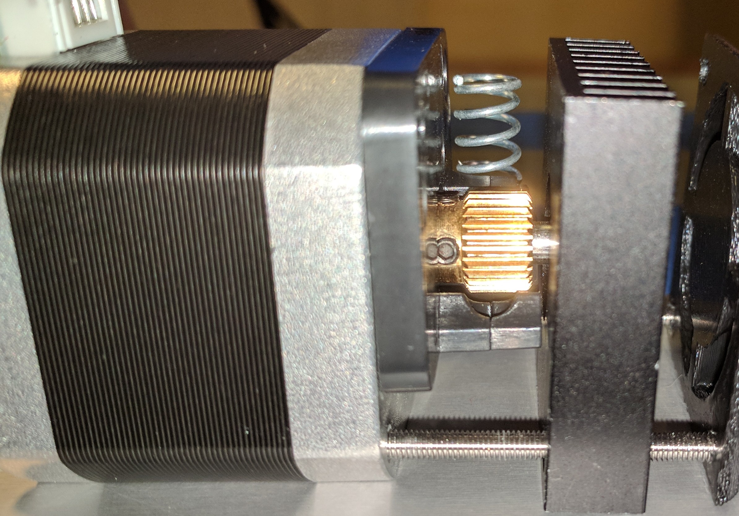

There's nothing for the extruder gear to rub on. It's recessed closer to the motor than the edge of extruder assembly. The heatsink for the fan has a cut out larger than the diameter of the gear (so even if it were sticking out, it wouldn't rub).
Re: So many issues...
Does the gear rotate freely? From the pics, it looks like the gear may be too close to the motor (enough for the set screw to bind). I could be wrong though.

GrueMaster wrote: September 14th, 2017, 10:34 pm Does the gear rotate freely? From the pics, it looks like the gear may be too close to the motor (enough for the set screw to bind). I could be wrong though.
Seems to spin just fine.

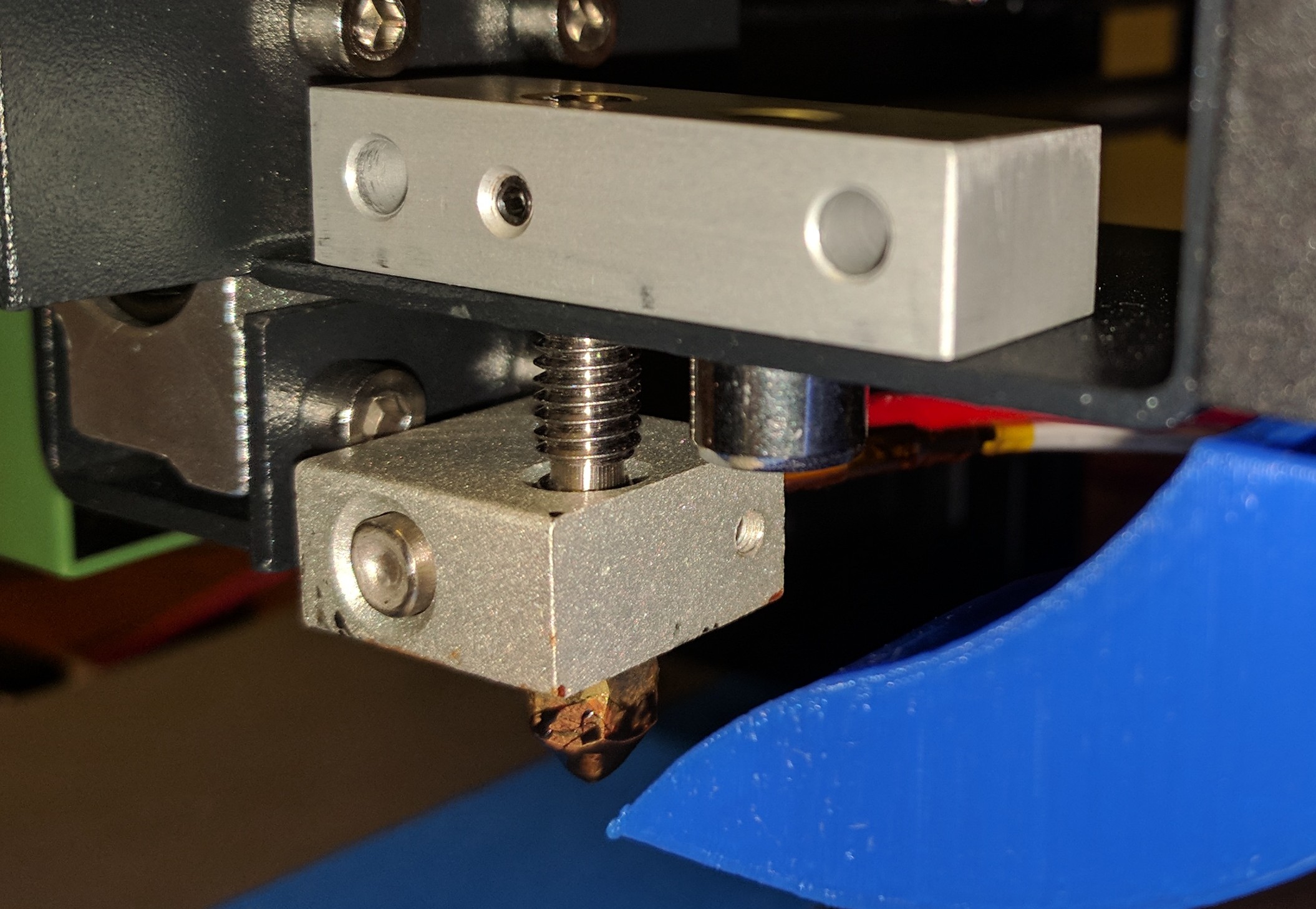

Before assembling check the PTFE lining in the throat for distortion, this can be done by pushing filament thru with it when dissembled.
When assembling the PTFE goes to the Bottom, screw the Nozzle into the heater block until two threads are exposed. then screw the throat into the Heater block and and tighten you should still see 1 thread on the Nozzle when tight.
When Assembled, I leave the throat a just below the the surface of the stepper Heat sink block.
I know what they said but it works better if it is a little lower. Before assembling I feed the Filament down into the Throat to help Aline the pieces.
When I insert filament I estimate 60mm of filament to make sure filament is feed to the Bottom and resting at the nozzle.
Now preheat the nozzle to 200 degrees using the LCD extract some filament.

I noticed the thermistor was loosely in the heating block, so I tightened the set screw. Once I powered up the machine, I got temp errors - I assume because the set screw was causing a short. How tight is that screw supposed to be? I've ordered new throats, nozzles, and heat blocks...maybe I should order a new heater/thermistor set, too.

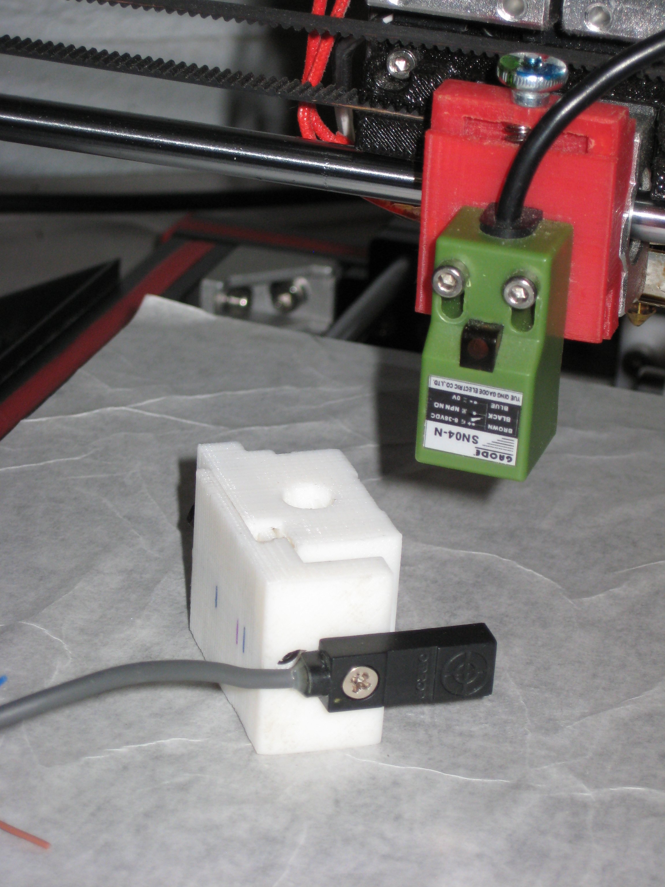

4. Home Nozzle, lower the Z-Axis to its lowest height. Is the nozzle at the height of a sheet of paper. If not adjust until it is. Now start a print.
Using an adjustable Proximity sensor mount. I can set the height of the Sensor thereby adjusting the height of the nozzle to micro millimeters.
I have determined that Marlin 1.1.5 CRC error is not an Error it is merely a checksum of the data, and have Flashed on both my 3D Printers.
I can modify My version Configuration files to work for your version of Hardware if you want it.
I have a different Sensor and A filament run-out sensor installed on mine. I am using the Low Profile sensor on a different slide mount than shown.

I've also replaced the entire hot end assembly: throat, heat block, and nozzle. (though initial tests were not encouraging) Same heater and thermistor though, for now. I do have several replacement thermistors I can swap out.
