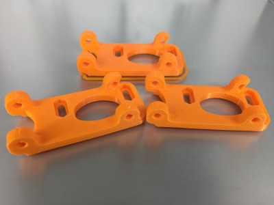

Re: Tweak this?
Tried a different small part
Back, with 25%. Right with 20%
Left is Cura default
Posts: 4062
Re: Tweak this?
If you click the photo and zoom in, note the S3D pieces (back and right)....note the sides of the part, especially where the hole mounts are
