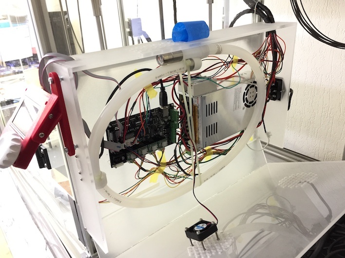

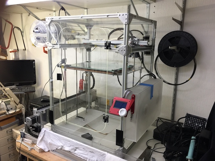

Almost there…
need to finish some details, but my FT5+ is done,
encased in 3mm acrylic and custom acrylic electronics box with a Blaze-Cut system.
and workspace now 400x300x500mm
the only problems I have is the print quality :), even after PID and E-step tuning, I still need to bring the flow back to 80% and temp much lower then I am used to, or otherwise it looks terrible.
Behold the mighty FT5+
