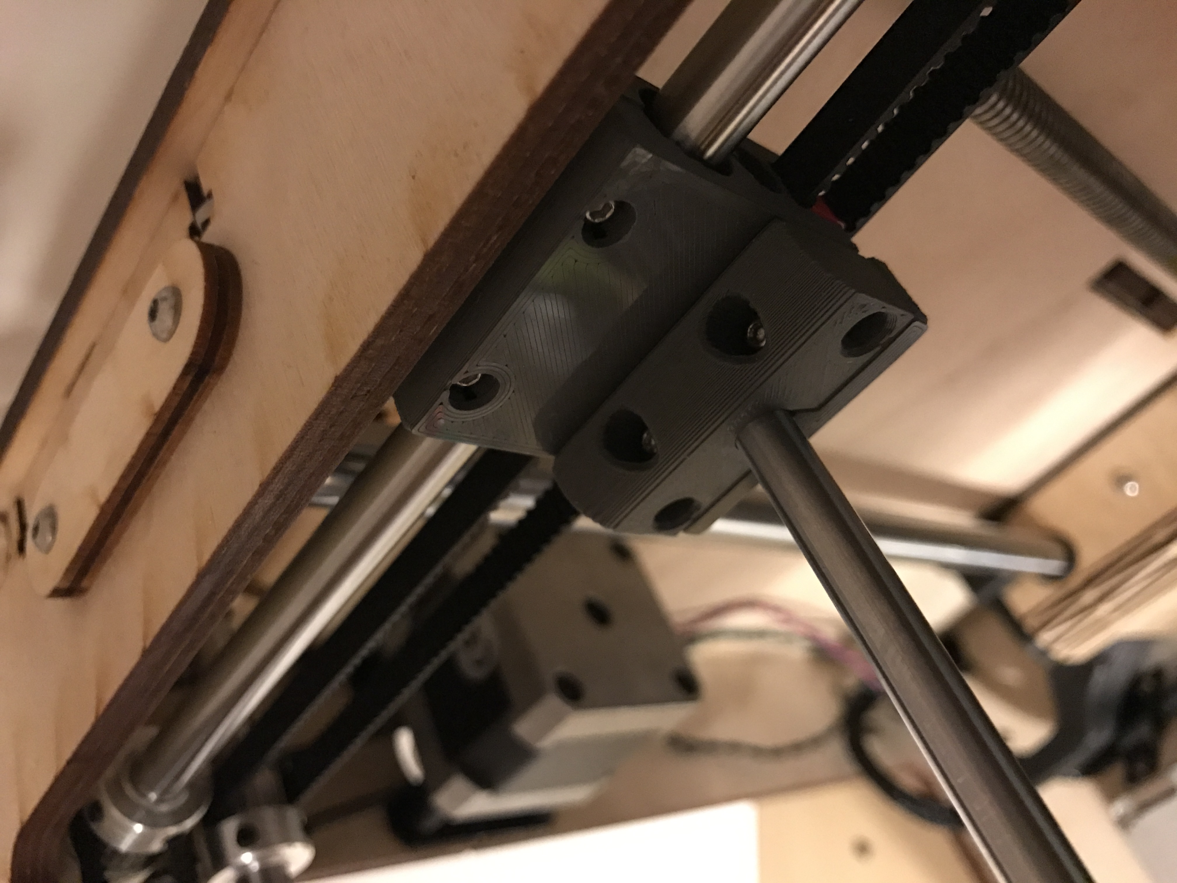

Well made an adapter for your slideblocks a-la beyondblocks. Will test tomorrow when I get some time.
I would change a bit the printed parts to have 0.10 margin of error, I did use horizontal expansion -0.10 for some parts on some reprints, specially the belt grips.
Will post after setting all up. Btw omg m2.5 screws are really tinnyyyy
If I'm right with some drilling on the box it should be possible to gain 1cm (or close to) in both directions on an umo... That should be... I think.. Ahrgg to much todobedobedo
Re: Adjustable belt tension UM2 sliding blocks
My evil plan to gain print area failed, but I did win almost 5mm on x/y, not bad XD
Gudo-neotko-beyond slideblocks. For umo adapters
After printing all -0.10 works flawlessly. Edited the step and changed the inner area like talked to gudo so there's less friction translating to the slideblocks when the bushings spin.

The change should be very easy, but you would have to 'cut' the belts. I did that, first 3 prints did look superb, very fast print and precise. (Ofc also with ZGE)drayson wrote:Yes, MXL - of course...
would be great to have this option.
Ringing is clearly less, at this speed it should be too much but is hard to notice (but ofc is there). At 70mm/s is almost impossible not to have it with this printers.

Great design
..but just a small observation, there seems to be a slight angle difference in the belts with this tensioning setup, the upper belt are not parallel to the lower belt (i hope you get what I mean, same belt around 2 pulleys)
I know i've seen comments on this before (i cant find the link) but when the belts are not parallel to eachother around a pulley, the distance traveled differs from the distance the step motor is set to do.
