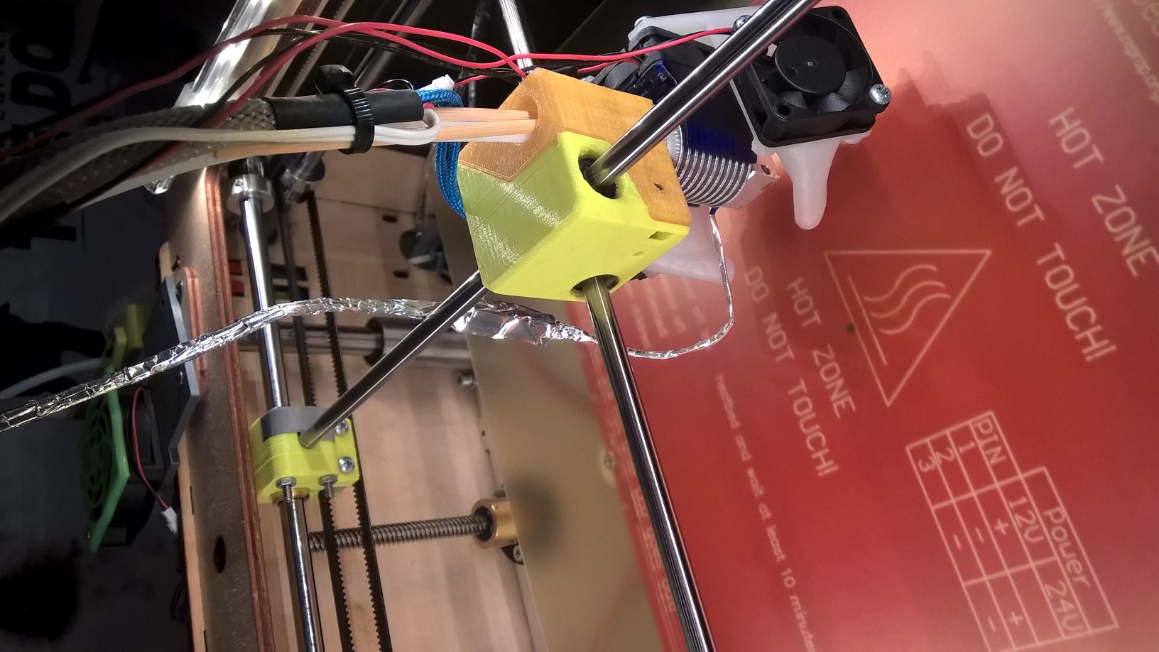

Print head and filament size
The print head doesn't look any-longer like the previous pictures.
I now switched to 1.75mm filament using an E3D universal 24v hot end with PT100 upgrade kit.

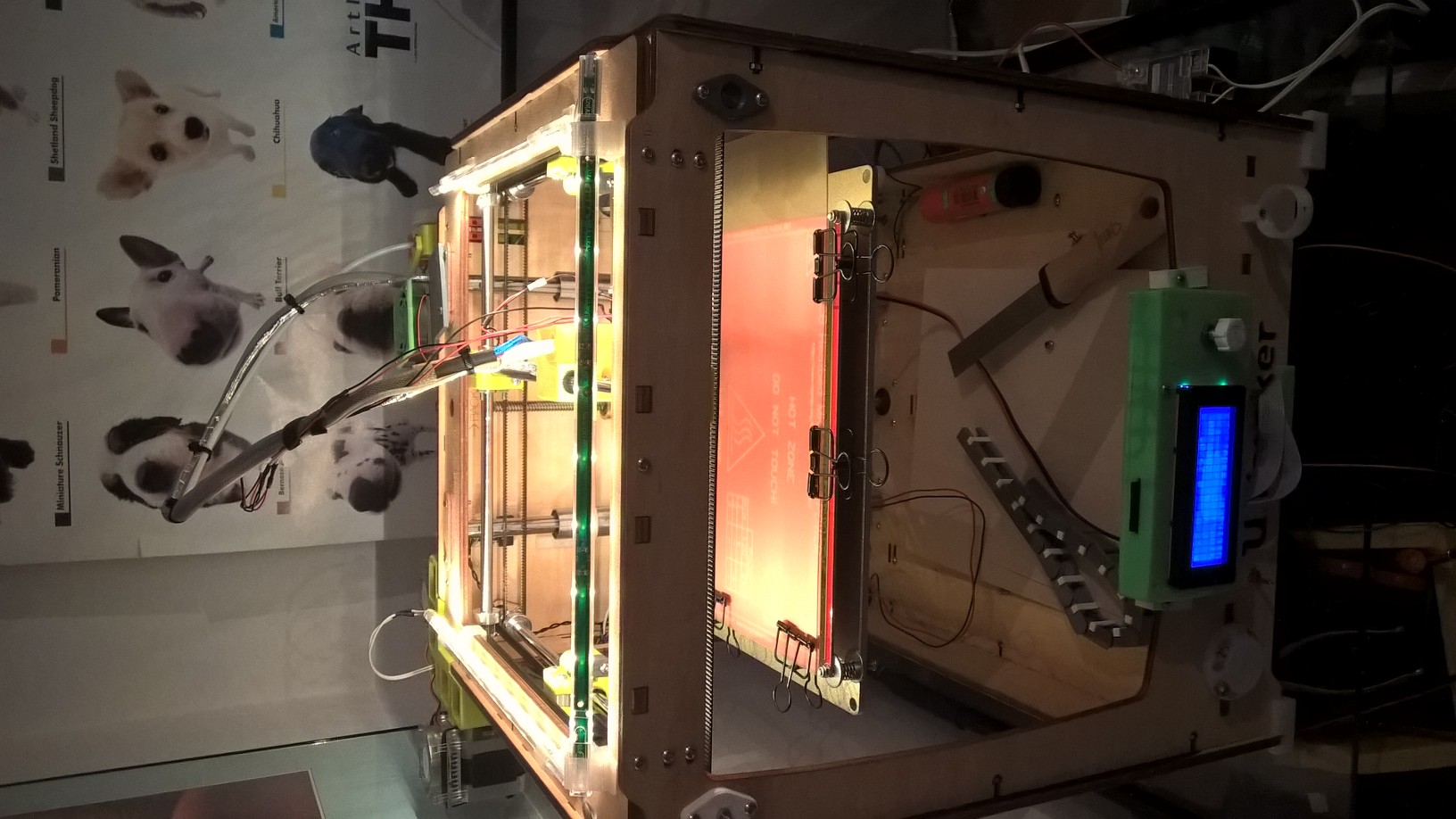

Here's some pictures of how the printer looks like now

Just updated my UMO again.
It now has a UMO2 hot bed with a PEI sheet attached to it and a piece of glass underneath to prevent the aluminum from bending.
I also updated my laser-head with the following design, so it now has a fan too: https://www.youmagine.com/designs/fan-s ... -umo-laser
It looks like this: I'm currently using a 20x20x1.6 cm MDF piece that I add on top of the PEI when I want to user the laser to cut stuff.
I'm currently using Inkscape with the Jphotonics laser plugin.
The instructions can be found at this link: https://jtechphotonics.com/?page_id=2012
I've configured to use M42 P13 to action the laser, but I'm considering to switch to P10 as per Drayson's suggestion on the matter.
I'm still evaluating this point as I'm also tempted to upgrade my electronics to a Rambo Mini v.1.3a
I did modify Marlin to add some extra functions to set the machine in some specific positions when using the laser.
Here's the link: https://github.com/Antiklesys/Marlin-1
This is a fork of Amedee's firmware that is also posted on this forum.
Next to come: display upgrade, extruder upgrade, PINDA probe for auto bed leveling, firmware update

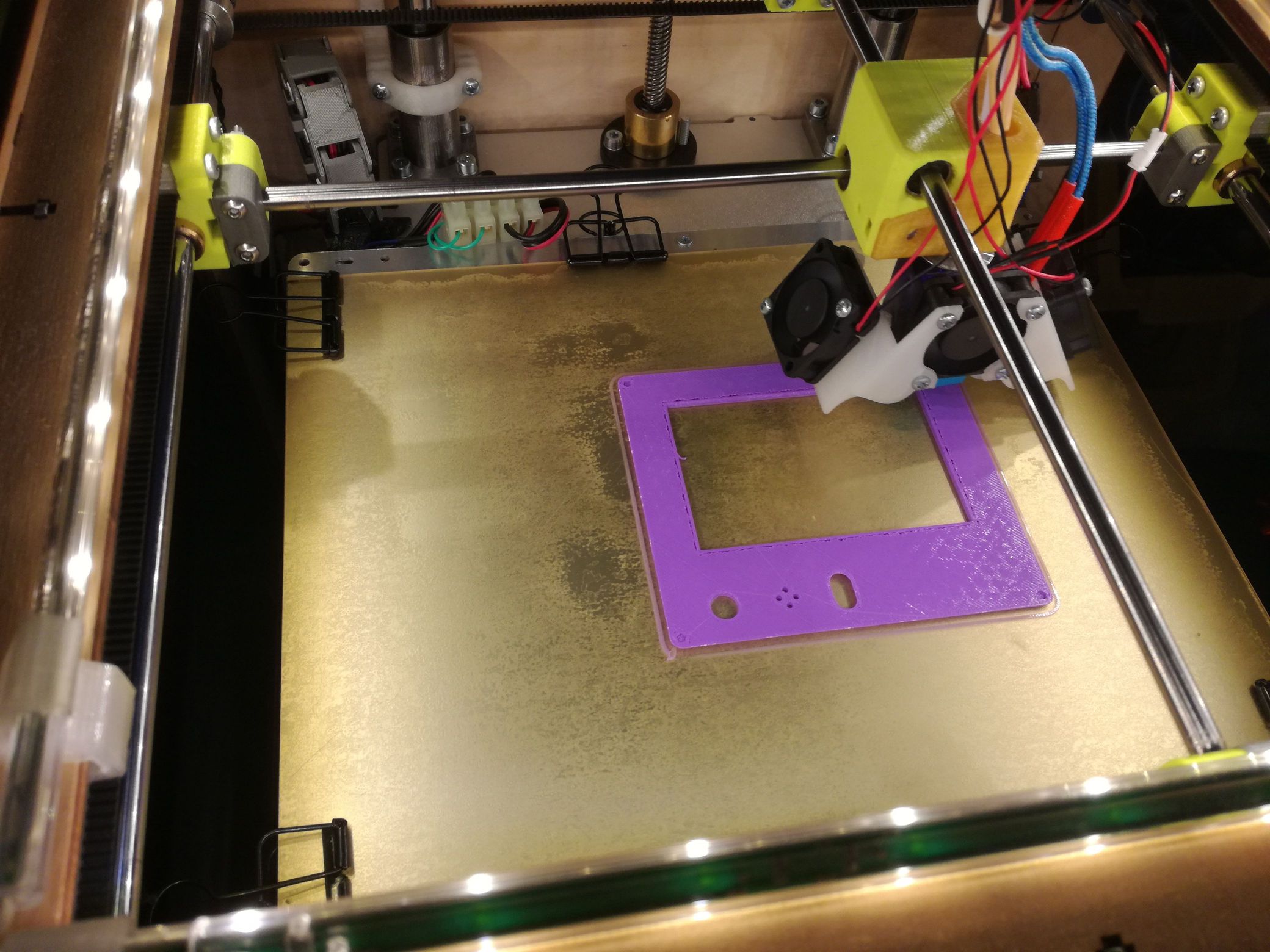

Thought I'd share a picture of the new printer's bed while printing the socket for the new display.
I just purchased this on Amazon:
I believe this was quite a good deal as it was priced 64 USD on it's site and I got it for roughly 17€ instead.

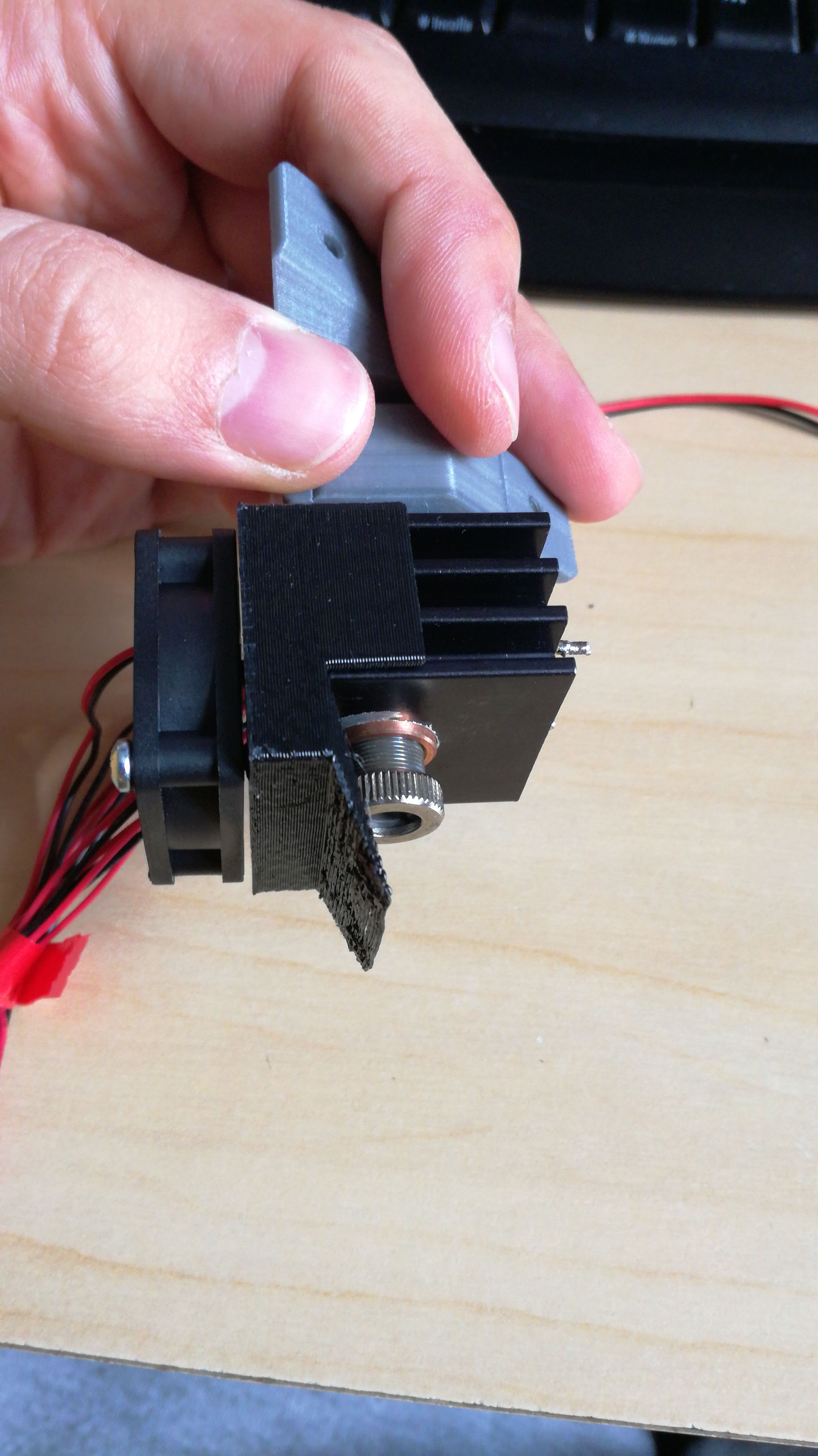

As per thread: http://3dprintingforum.us/viewtopic.php ... 7198#p7198
I replaced this: https://www.youmagine.com/designs/ultim ... ronics-fan
with this: https://www.youmagine.com/designs/mount ... iginal-umo
It is slightly quieter now, but those small heatsink are in the way.
I may be removing them at some point when replacing to:
