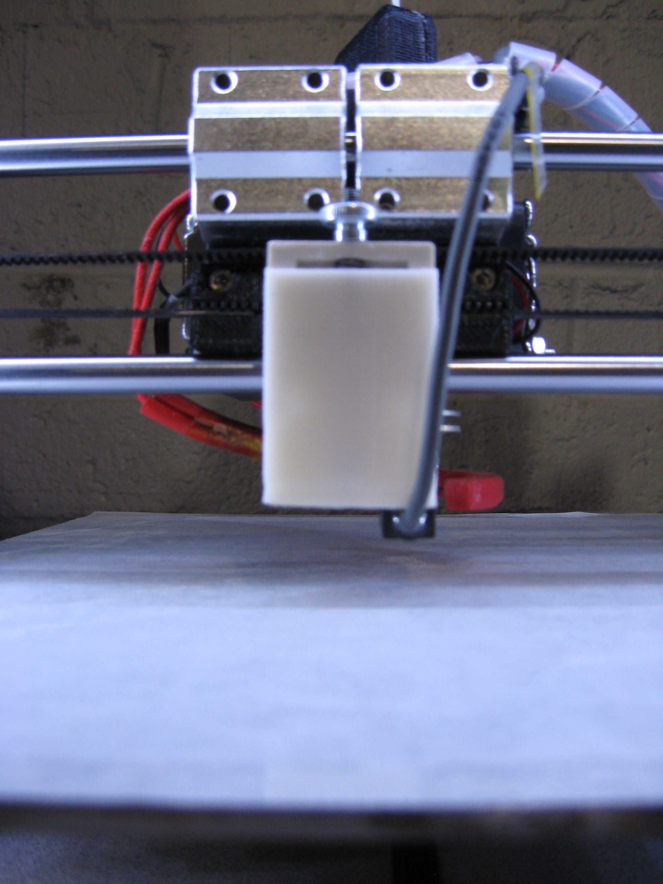

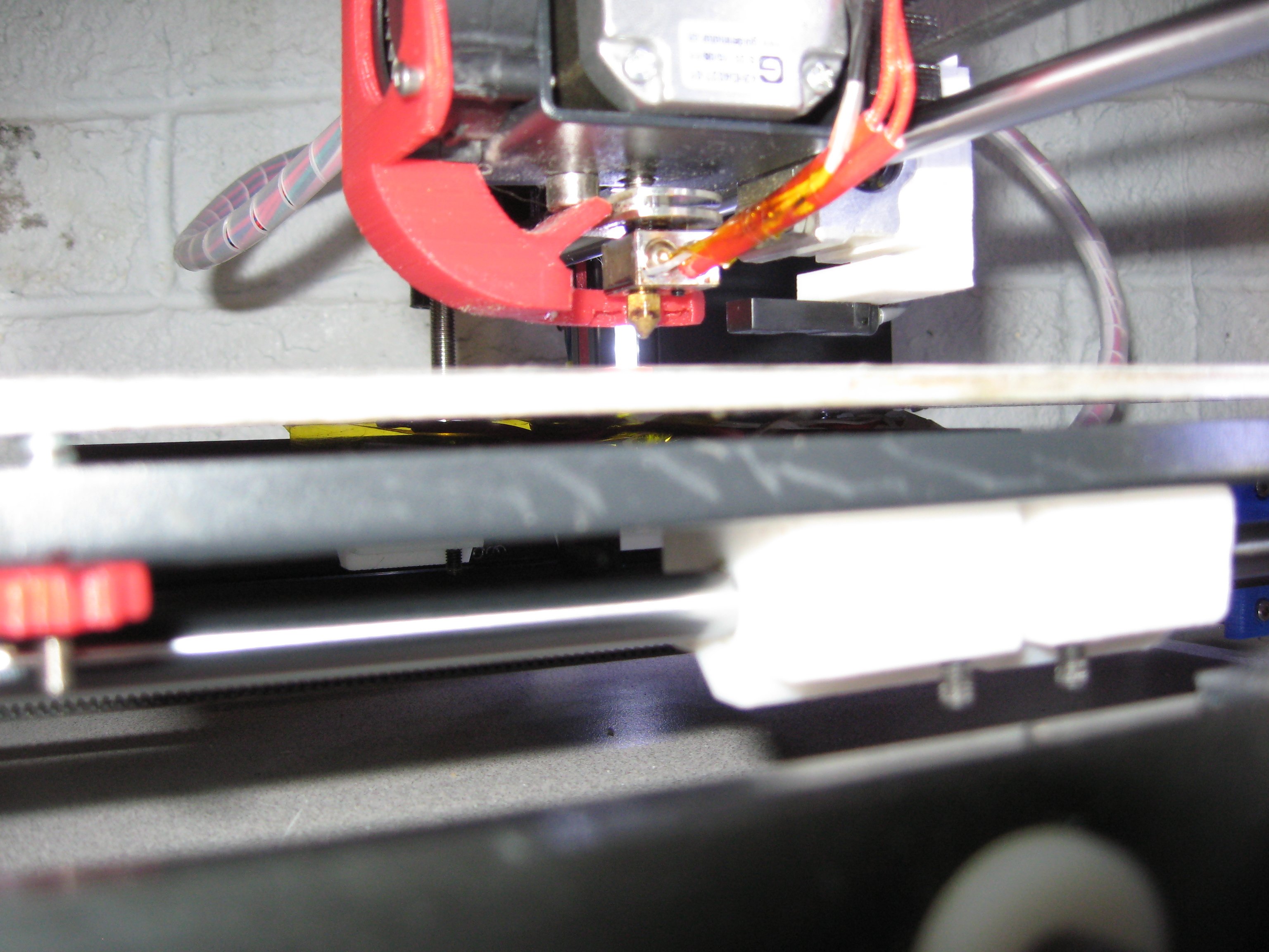

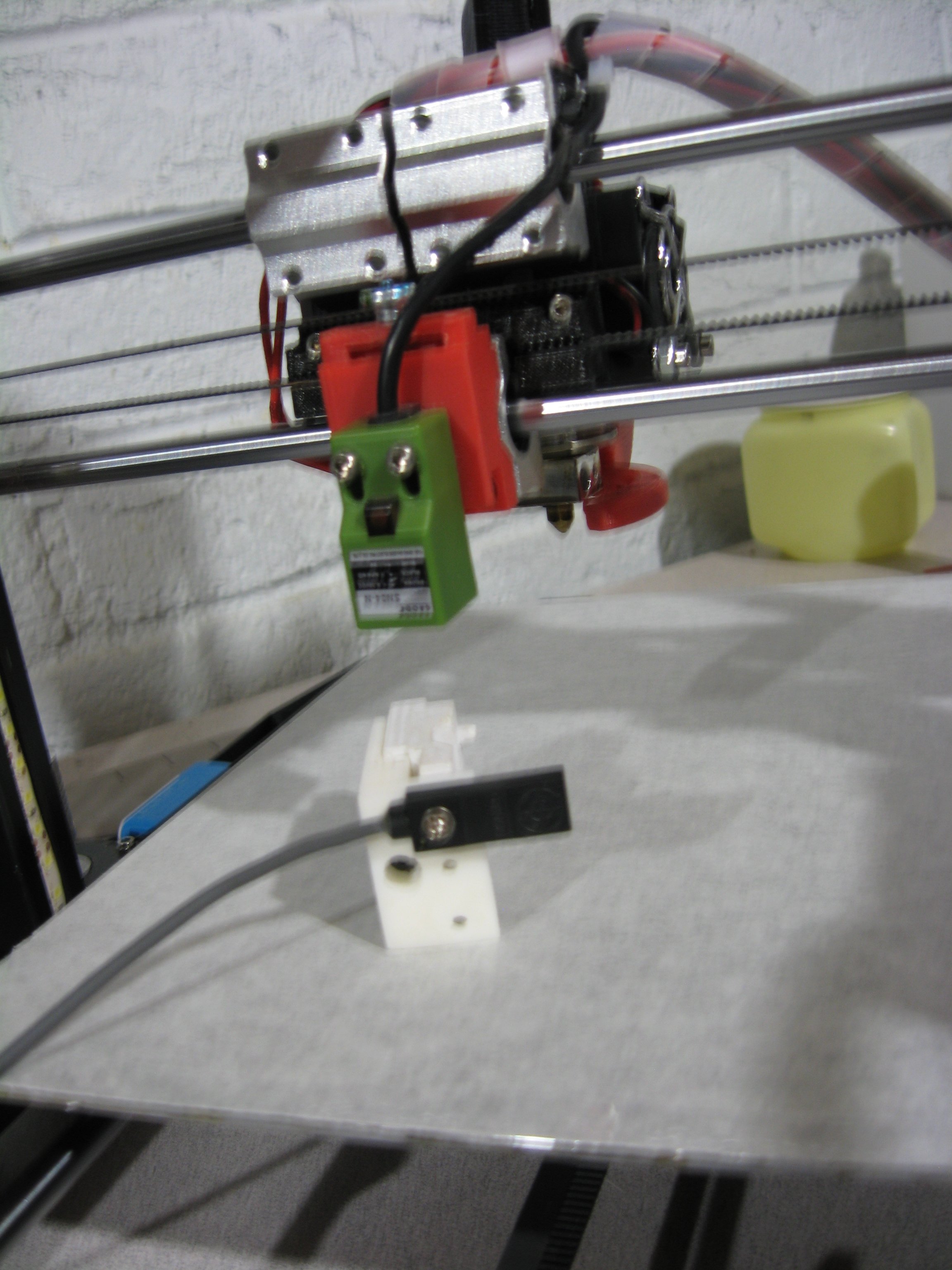

I have install the New Bottom Bearing mount sensor, At this time I did not install with the X-Axis PLA Bearings.
you may have noticed the sensor was moved to the side of the Mount directly behind the nozzle, the Distance is 25mm.
Attaching to bottom bearing mount with 2 - 3mm X 30mm screws and 3mm nut.
A 3mm x 51mm - and a thumb screw as an adjuster. I found a spring in my junk box. a little big but filed the mount until it fit.
When I install the Bearing incorporated sensor Mount the sensor Distance will be 15mm behind the Nozzle.
You can see in the middle image I have PLA Bearings that work Extremely well.
Other than a manually re-leveling the bed it went quite smoothly.
Added STL for Newest Mount design see below.
For TL-W3M sensors NOTE: This is a thingiverse Mount I modified by henryarnold
HicTop Prusa i3 Auto Bed Leveling Sensor Mount
