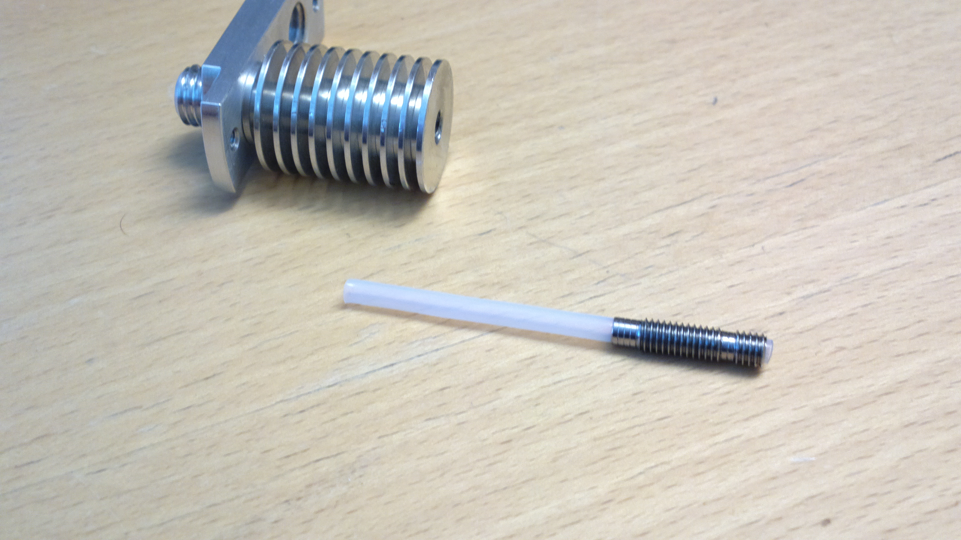

Meduza wrote:I have heard of so much problems with all-metal designs and PLA, so i am a little reluctant to use that for a printer that is going to be used for PLA prints...
Exactly, I don't know how E3D are thinking when they are selling the all metal 3 mm hotend as suitable for PLA.
I mean, it might work if you have exactly the right amount of retraction, a powerful direct feeder, feedrate within certain intervals and so on.
But we had endless trouble with the E3D V5 (or maybe it is V4?) on the Delta Tower before I modified it.
Luckily, making a stainless heatbreak tube with suitable dimensions for teflon lining was a piece of cake for the university workshop :)
I use this PTFE tube: https://www.elfa.se/sv/isolerslang-ptfe ... p/15509963
And drilled though the heatsink with a 4.0 or 4.1 mm drill, can't remember what size I used.
Since then we haven't had a single issue with filament jamming in the hotend.
If you have issues printing 3 mm PLA with E3D hotends I really recommend this mod.
Maybe one should start selling that heatbreak tube, a suitable drill for the heatsink and some PTFE tube in a kit.. :)

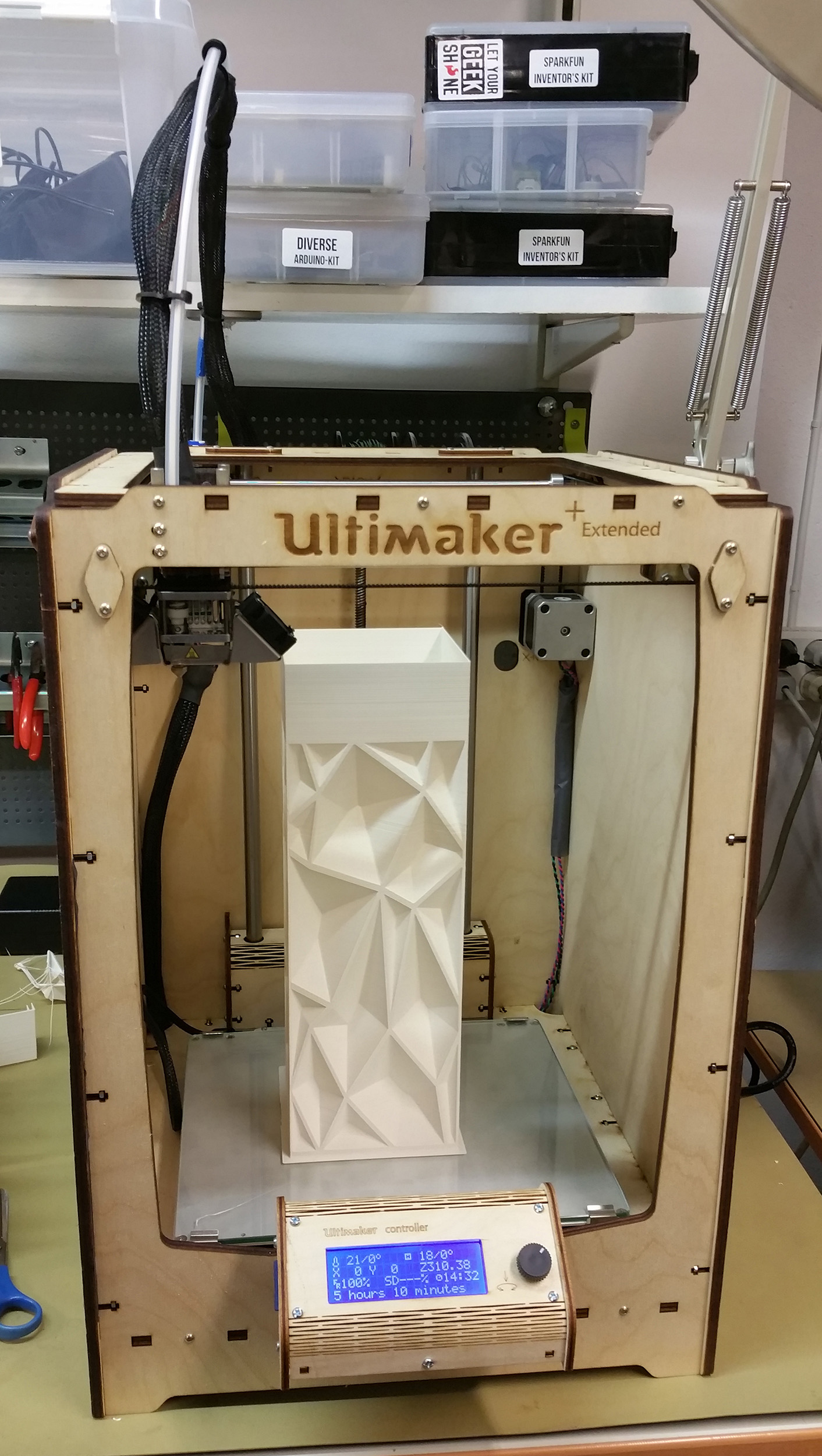

So, it is now alive and printing since a few days ago and it has found its new home in the Stockholm Makerspace 3D Printing room :-)
One thing is still missing, LED Strips, so i have ordered some 24V ones on eBay.

Great looking printer, well done... only 5 h 10 min for this print? Must be a bigger nozzle?

martin-bienz wrote:Great looking printer, well done... only 5 h 10 min for this print? Must be a bigger nozzle?
Maybe a 0.8mm or even a 1mm. You want one? ;-)

@martin-bienz: Yep, a.0.8mm nozzle.
