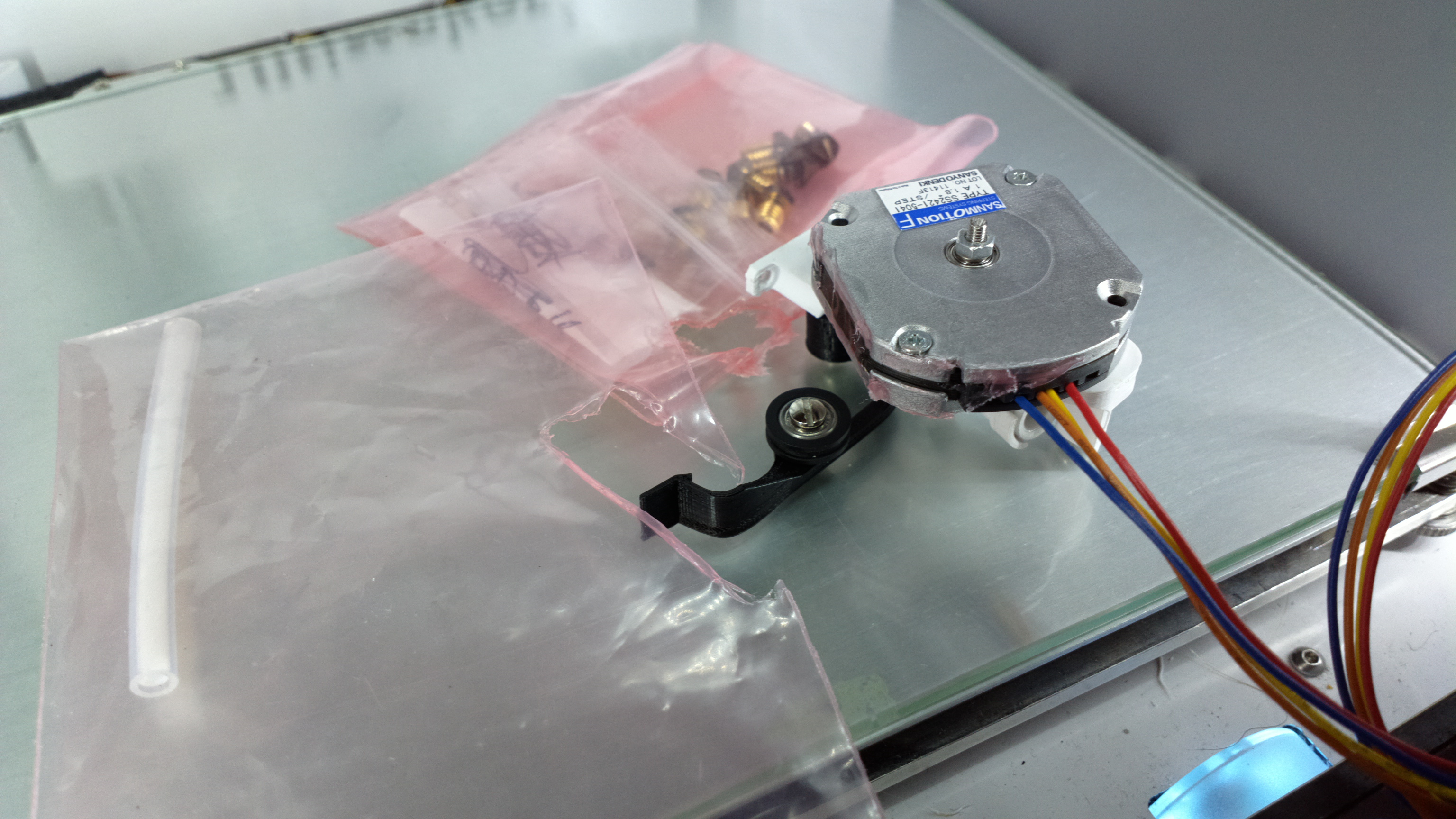

Yeah, the pancake stepper without a form of transmission won't make a reliable extruder IMHO, and personally I'd always go with an adjustable spring-loaded idler. It can be a pain to stuff into a miniature design but I think it's worth it.
I've also been making small extruders in my spare time for quite a while now. Experimented with all sorts of stuff, my current extruder is ridiculously small and light (NEMA8) but it has problems with 3mm filament - I think it would work as is with 1.75 though but I don't have a hotend for that. Currently I'm going with a NEMA14 pancake, just working out the gears for a new prototype. Although the latest one is worm-gear driven I've done successful runs with printed and laser cut gears as well.

A larger knurled wheel is what I was aiming for too, but it requires a gear because the torque of the stepper is too low at 600 mA to support more than about 4 mm diameter of the knurled wheel.antiklesys wrote:Anders, you have access to a CNC lab. I would recommend you to have a larger knurled wheel CNC'ed.
It will act as a larger contact surface with the filament and should help reducing the skips.
If you can machine something like this, but not in the format of a knurled bolt but as drive gear, I'm sure you'll be able to increase the performance of your stepper: https://thingiverse-production-new.s3.a ... el20mm.PDF
So a geared version really is the way to go I believe, even thought my prototype was working surprisingly well.
Another thing that I have been thinking about lately is if one should consider a two motor setup, where there is an extra motor that feeds the filament of the spool and into the bowden. If the pancake stepper always had to use about the same force pulling the filament one would have much less slipping issues I believe.
