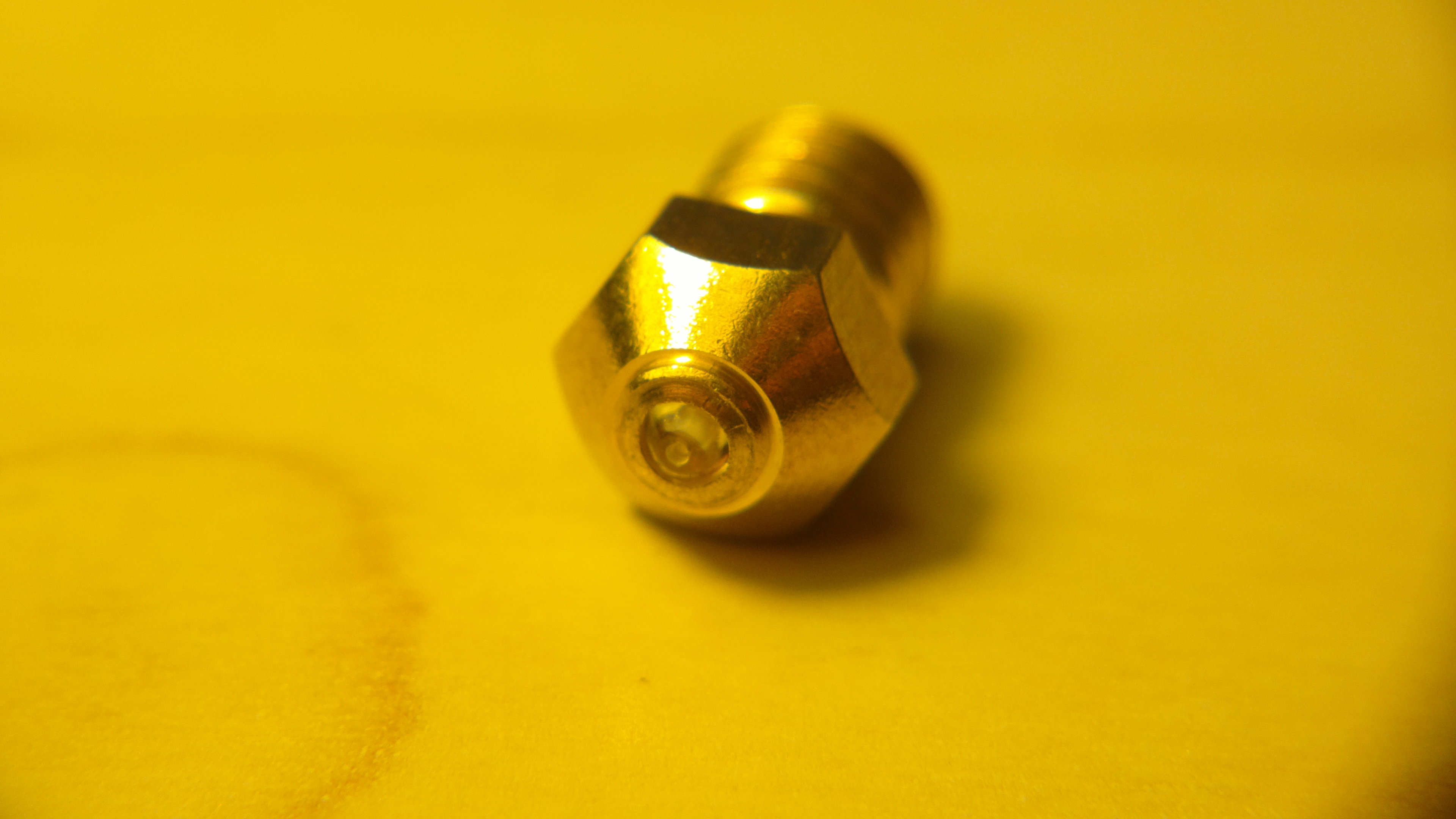

Nozzles has been sent out for testing, but most of them were 0.5 mm sapphires, looking like this one:
For various reasons that design was not optimal, so I focused on the 0.4 mm version seen in the first post.

The prototypes I have sent or will send are made at my jewelers lathe, which means the precision is not what it should be.
My intention is to further test this concept of assembly and the performance in general, which is normally best done by the users.
It means you get a rather expensive nozzle before everyone else and for free in return for some feedback :)
The current nozzles might for various reasons have a bit lower performance than the final product, like lower maximum printing speed, but they are all tested by me before delivery and should perform as expected under normal conditions.

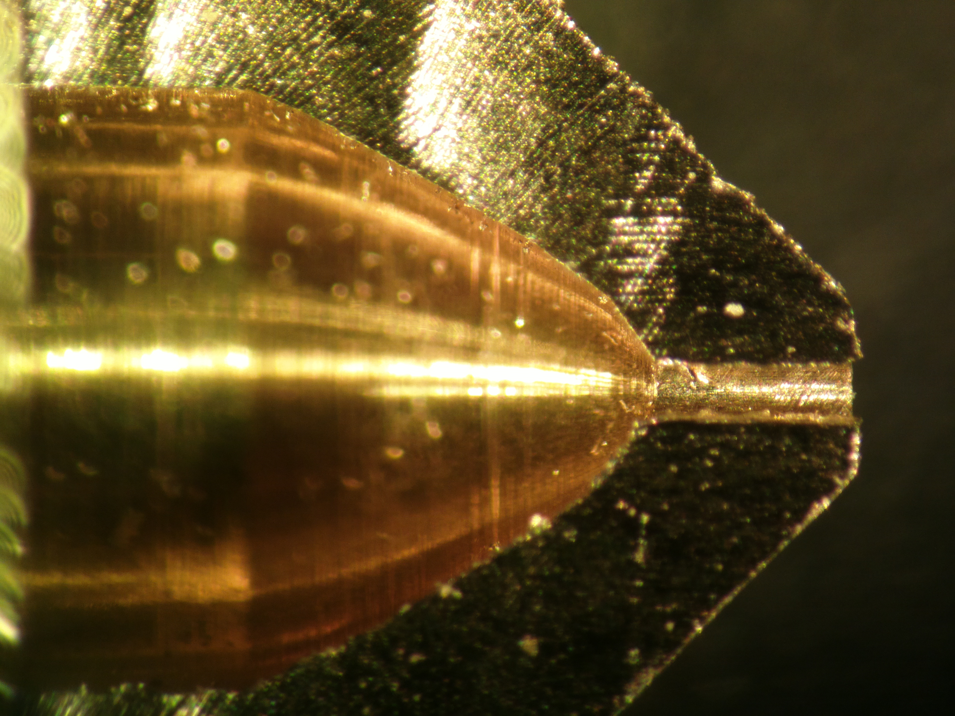

Anders, what method do you use for the diagnostics of the channel of the nozzle? X-ray, microscope, or some other method of inspection? I agreed on Monday with the Department of metallurgy at the local University, they promise to help with the analysis. Given the fact that not all the nozzles came out perfectly (at yesterday's photo you will notice the offset of the outlet relative to the Central axis) I think, possible artifacts of the surface of the output channel.

ivan.akapulko wrote:Anders, what method do you use for the diagnostics of the channel of the nozzle? X-ray, microscope, or some other method of inspection? I agreed on Monday with the Department of metallurgy at the local University, they promise to help with the analysis. Given the fact that not all the nozzles came out perfectly (at yesterday's photo you will notice the offset of the outlet relative to the Central axis) I think, possible artifacts of the surface of the output channel.
I have only used microscope for the ruby nozzles.
For brass nozzles we have cut a few nozzle in half in a milling machine to inspect the internal shape, like this:
The internal shape of the nozzle in the picture is not exactly according to specifications by the way.
