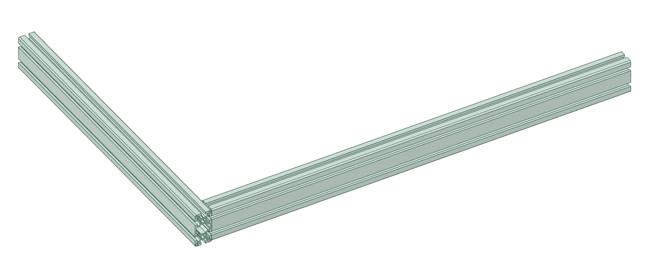

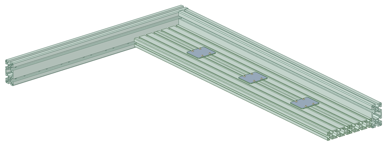

I start off with two beams. These are 40x80 mm Misumi HFS8 alu extrusions. They are strong like a tank, and completely impossible to deform with human strength. I put these together, but not tightened 100% yet.
View rotated horizontally by 90° clockwise

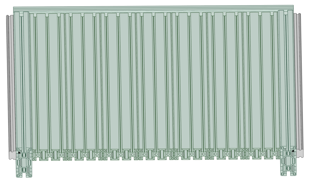

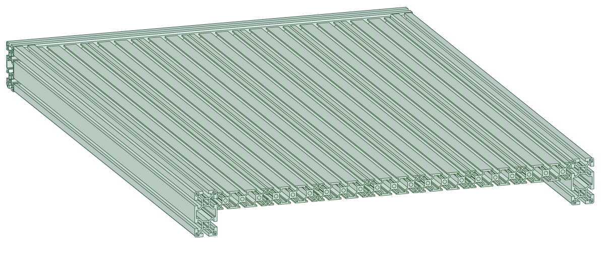

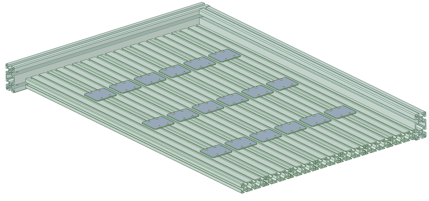

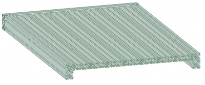

Now I add the build platform piece by piece (30x90 mm extrusions) into the frame.
Part flipped around 180°

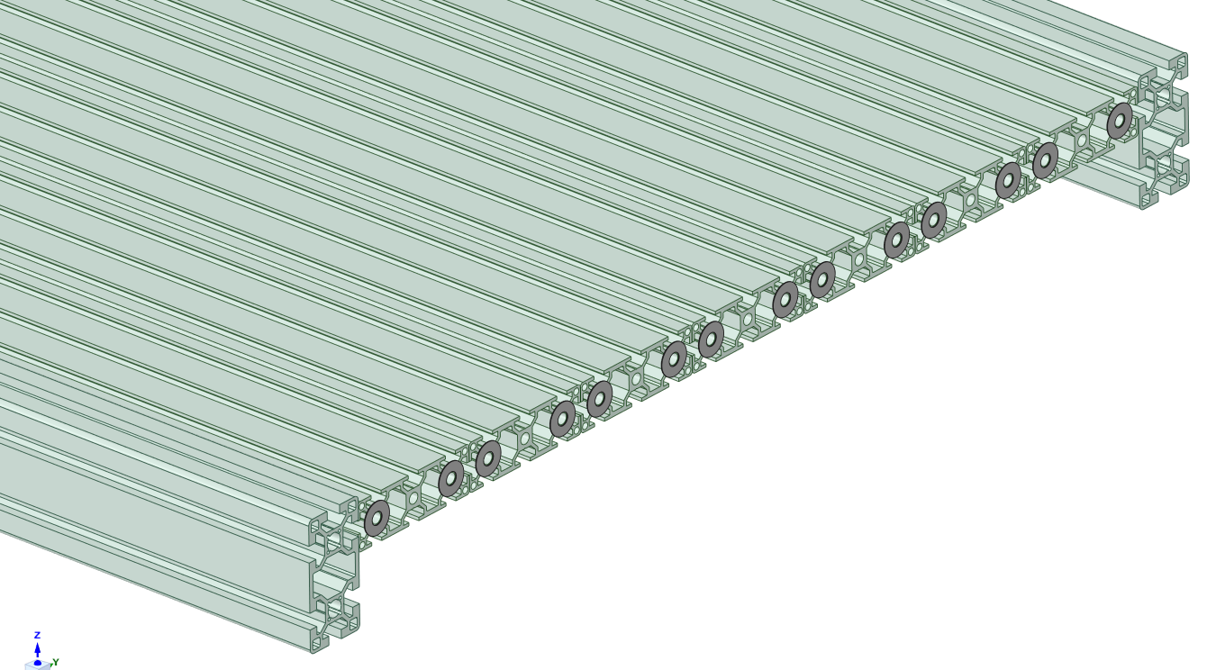

The build platform parts are linked together using these 2.5mm steel brackets to ensure that they do not bend upwards or downwards.
Add all the platform beams and links, and then tighten everything down, making sure that the angle between the 40x80 mm beams is 90° and the frame is not warped in it's horizontal plane.
Part flipped back 180°

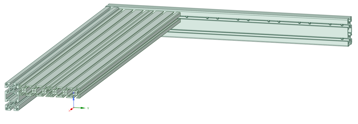

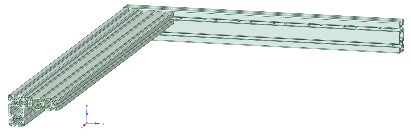

And then add the next 40x80 mm beam (not tightened 100% yet)
Now, these two 40x80 mm beams will hold the X axis rails (added as an illustration). So they need to be aligned perfectly parallel to each other, or my portal will get stuck or be hard to move on one or the other end of the machine.
What I plan to do here is to fix the left 40x80 mm beam and build platform to the rear 40x80 mm beam in a good 90° angle. Then adjust the right 40x80 mm beam (later when fixing it to the frame) until the two opposing beams are perfectly aligned.

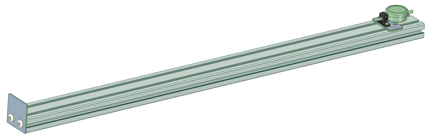

I will measure that using a dial gauge (0.002 mm resolution) mounted on an aluminum extrusion beam: But first I need to add the last 40x80 mm beam, in order to be able to fix the previous one.
Now, the problem about these extrusions is, they are cut with 0.5mm length tolerance (which is already pretty good, but it's not perfect).
Because of this, I made the 30x90 mm extrusions 0.5mm shorter than the 40x80 mm ones. I will then add 0.1mm thick shims to get them within 0.1mm of the 40x80 mm beams.

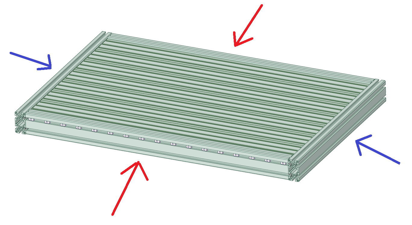

Then add the final beam. The right side (in this view it's actually the rear side) is still not fixed 100%, because now it's time to do that alignment and secure the frame in place.
Now, the sides marked with red arrows have to be aligned perfectly. The other sides marked blue do not. The shims I added earlier are not needed to make the frame parallel, but to prevent the beam from deforming by more than 0.1mm when tightening down all the screws.
And of course the whole frame can't be warped in its horizontal plane, which is why all of this has to be done on a perfectly flat surface. I know, my reference plate is a bit too small for that, but I have to make do with it. I will also try using a water bubble to check the levelling.
All in all, the plan is not perfect and it will be difficult to do it. But I hope this will work...

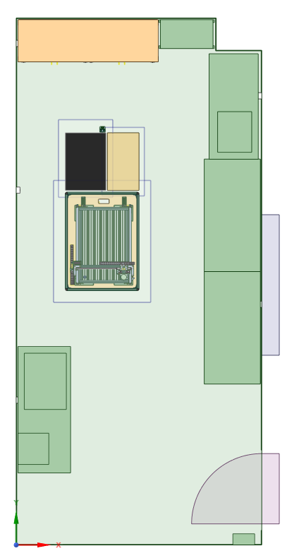

/edit:

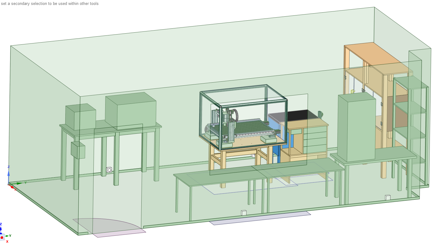

The table in the rear left is for manual woodworking. There's a disc grinder and a miter saw.
In the middle of the room there's the CNC and table with storage and controlling PC next to it. And there's the black reference plate.
The large rack in the rear right holds 2 3D printers in enclosed compartments and lots of storage for filament and stuff. In the front there's 3 tables, one is a massive workbench with my BF30 manual mill.

/edit:

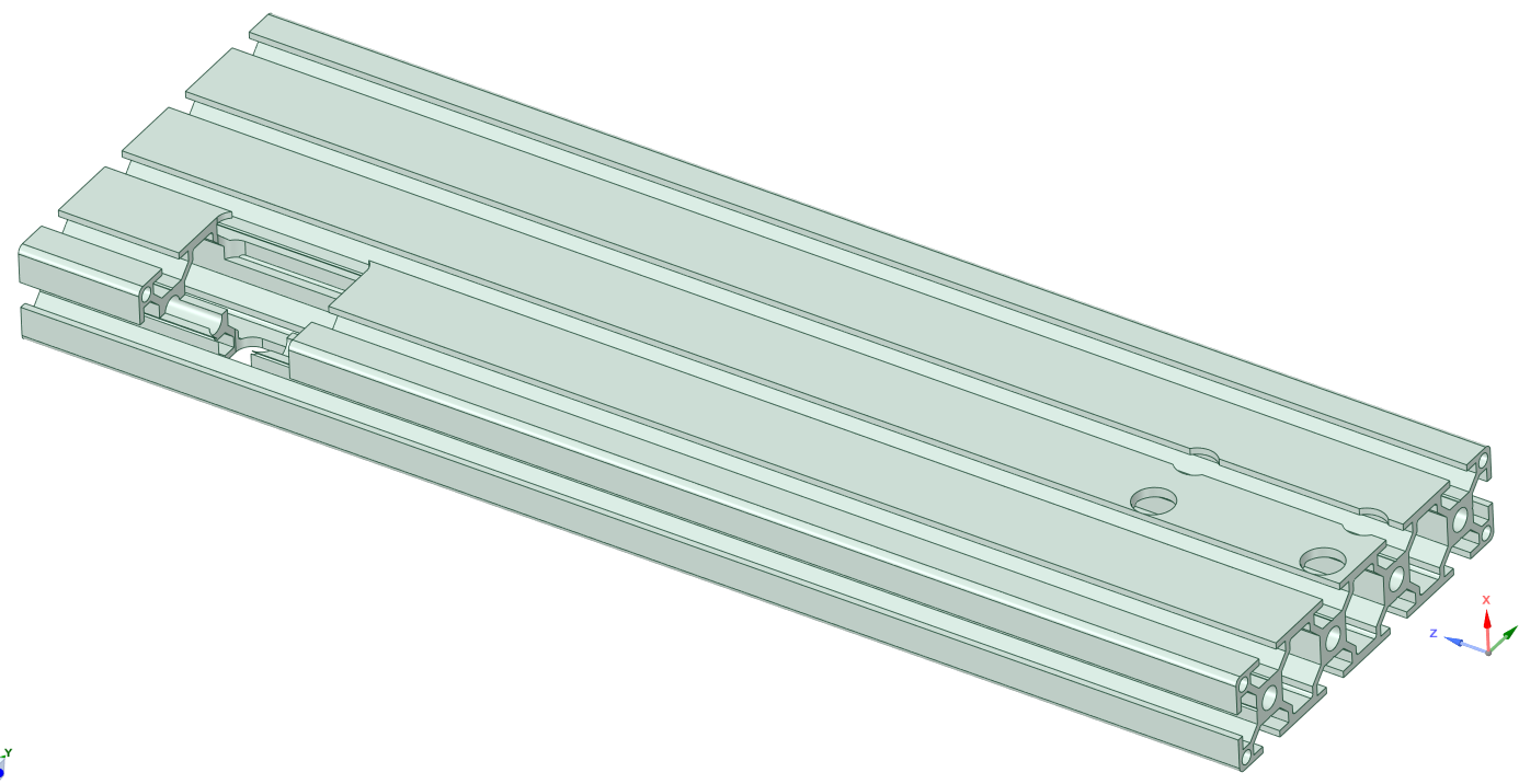

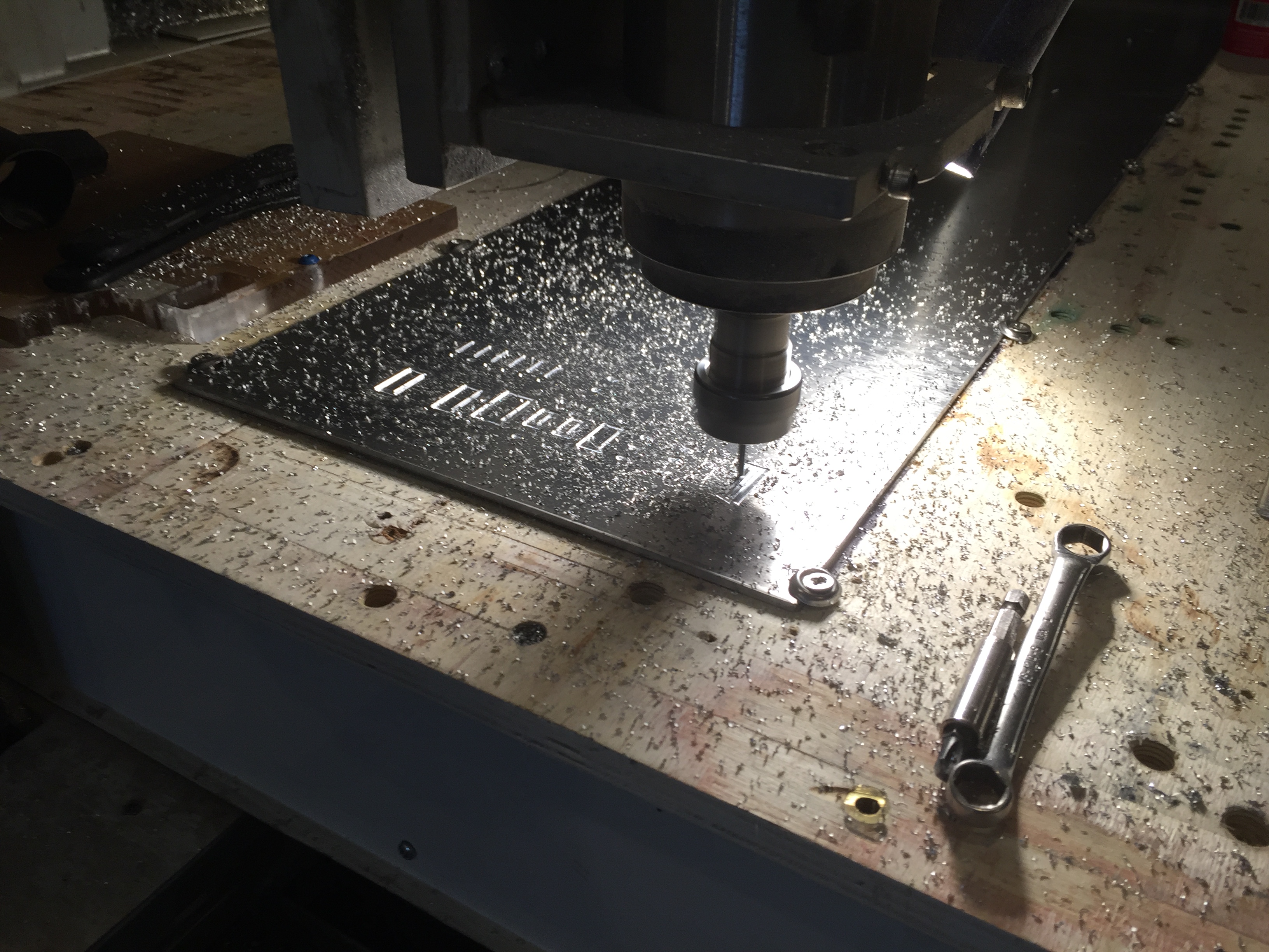

And I also didn't tell you yet that you also need a manual mill in order to prepare the alu extrusions. I did add some complexity into these extrusions so that I wouldn't have to make actual CNC milled parts. These modifications are simple and don't need to be super accurate, but you will need a mill with an XY table. A mere drill press won't suffice.
Example: It's simpler than it looks. I just cut out a square hole with a 10mm mill. There's 0.5mm error tolerance to this so it's really hard to do it wrong.
And of course there's lots and lots of drilled holes (they are all just key holes for screwdrivers, so no need for pinpoint accuracy again) and tapping of these alu extrusion center holes.

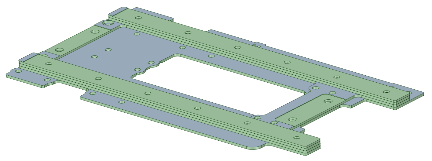

And another part where manual mill work is needed. The Y slider with the Z axis rail mounts. I decided to just slap these together using epoxy glue, then putting them on my mill and make those precise reference faces (green) where the Z axis rails and the ballscrew are mounted on. This is a small part that fits on my mill, and it's the best way to do it. Don't forget that a lasercut 2.5mm steel part will not be 2.500 mm thick but actually have some variance in the 0.1 or even 0.2mm range.
It's really difficult to keep track of where parts are accurate, and where you have to be careful with tolerances...

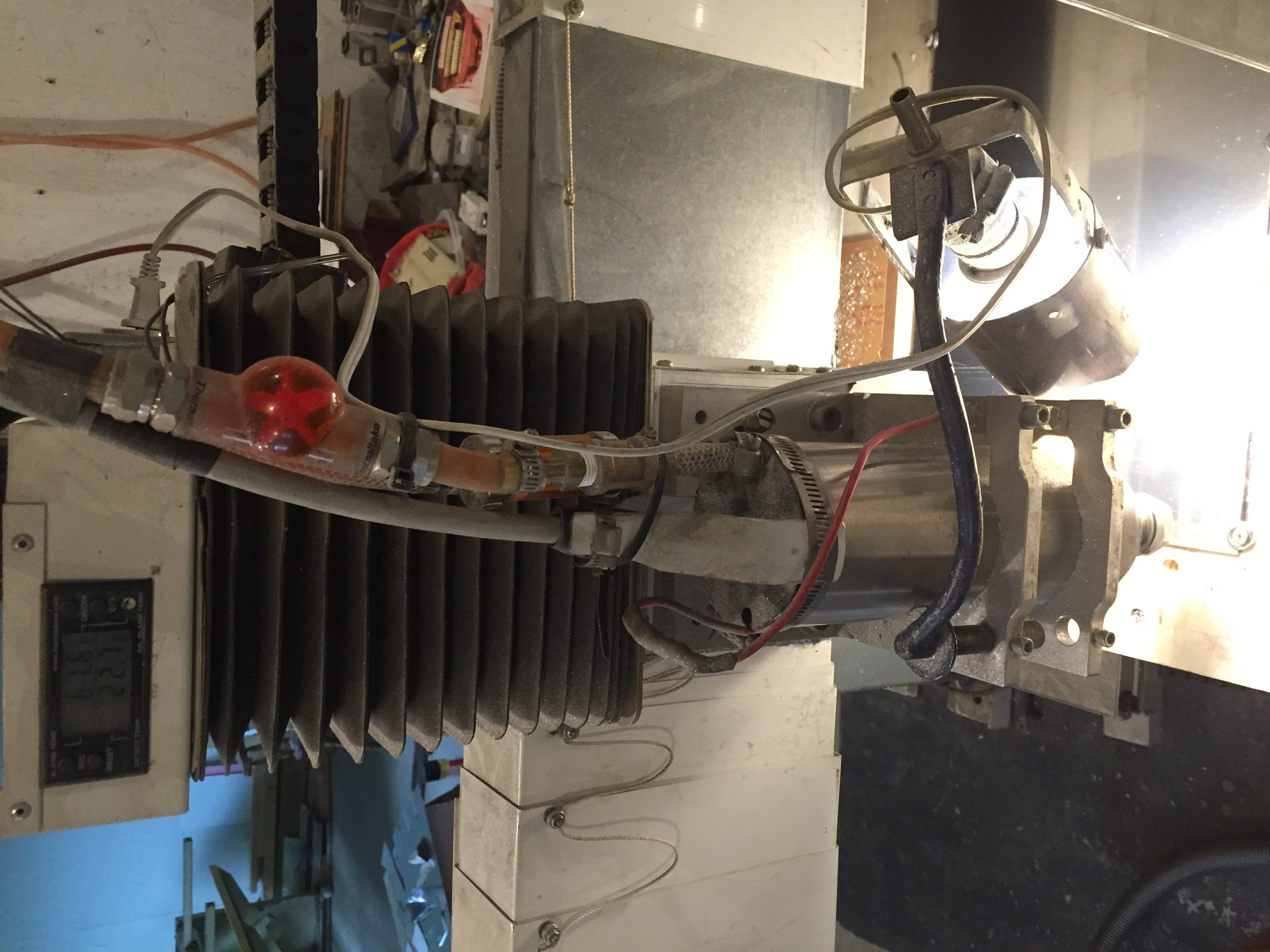

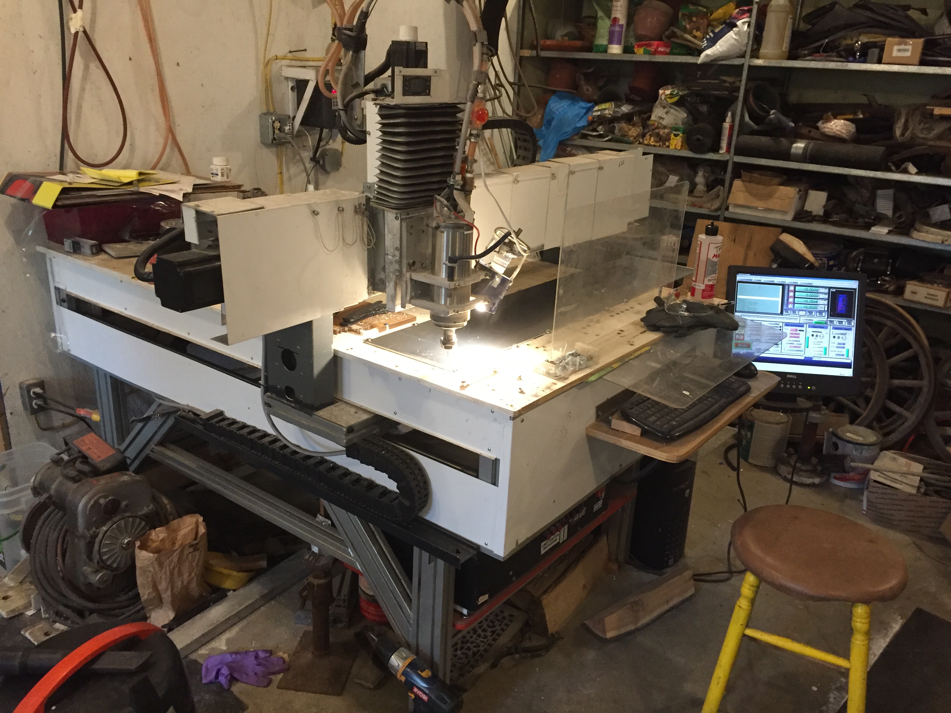

It looks like you're doing everything right
I was using my friend's CNC machine he built and snapped a few photos for you. You can see the water cooling around the spindle and of course the R2-D2 data panel pieces I made.

@LePaul, that is a nice looking machine there
Good ideas on the dust protection, I think I might borrow something from that
The spindle holder seems a bit minimalistic to me. Does that hold up well? I on the other hand might have gone a bit overkill using 2x 80mm high holders that pretty much cover up the whole spindle...
I will most likely use an MDF plate on the build platform as well. Very easy to handle and you can just mill away any scratches or holes in the surface.

- Posts: 3981
Re: Jonny's CNC portal mill
The dust protection across the top works great. It's just like Venetian Blinds with some overlap...string ties them together so they slide around as the spindle moves across the X axis.
We have a LOT of time on that spindle and it has held up extremely well. Honestly, we are amazed it has. We've checked for replacement spindles just in case the day comes it fails
My friend also has a huge industrial size CNC machine but the spindle only goes to 3000 rpm. Great for really hard metals, not so great for aluminum
