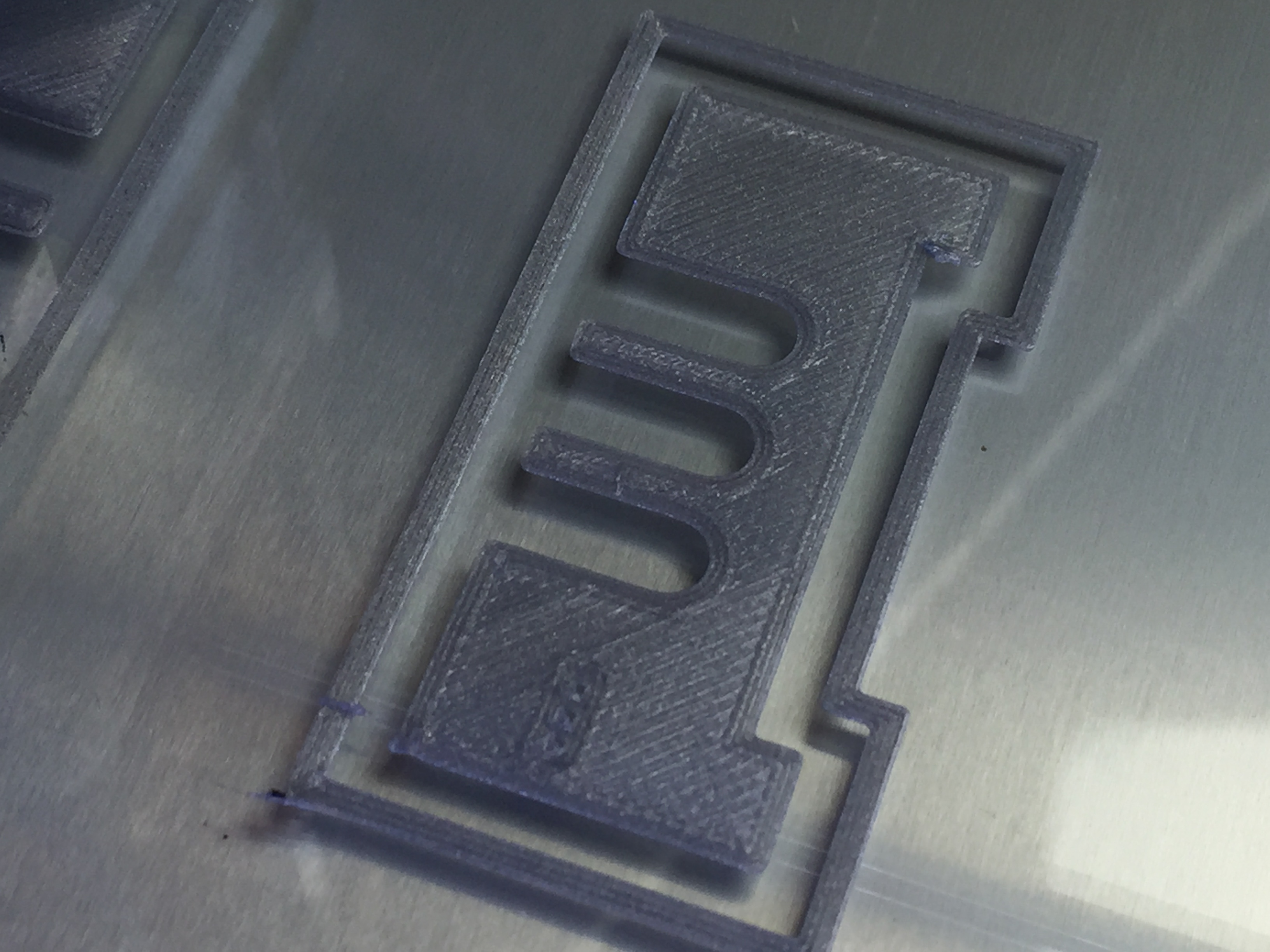

I haven't found the sweet spot yet.
I started with How to print with nGen, averaging the values. It gives a nice print but layer bonding is crap.
So I increased the temperature (235-240°C range) and dropped the fan. That gives me a strong print.
I also have enable coasting (Cura 2.1) and it ls looking quite good.
I need to see how far I can re-introduce the fan, but I don't want to spend time on that before I actually get my super-duper-neotko fan shroud mounted.

Ha ha! I'm in the same situation! I am thinking it would be good to print the side pieces with...but wasn't sure it would like no fan!
p.s. Good link...50% fan is what they say...well, perhaps none works even better!

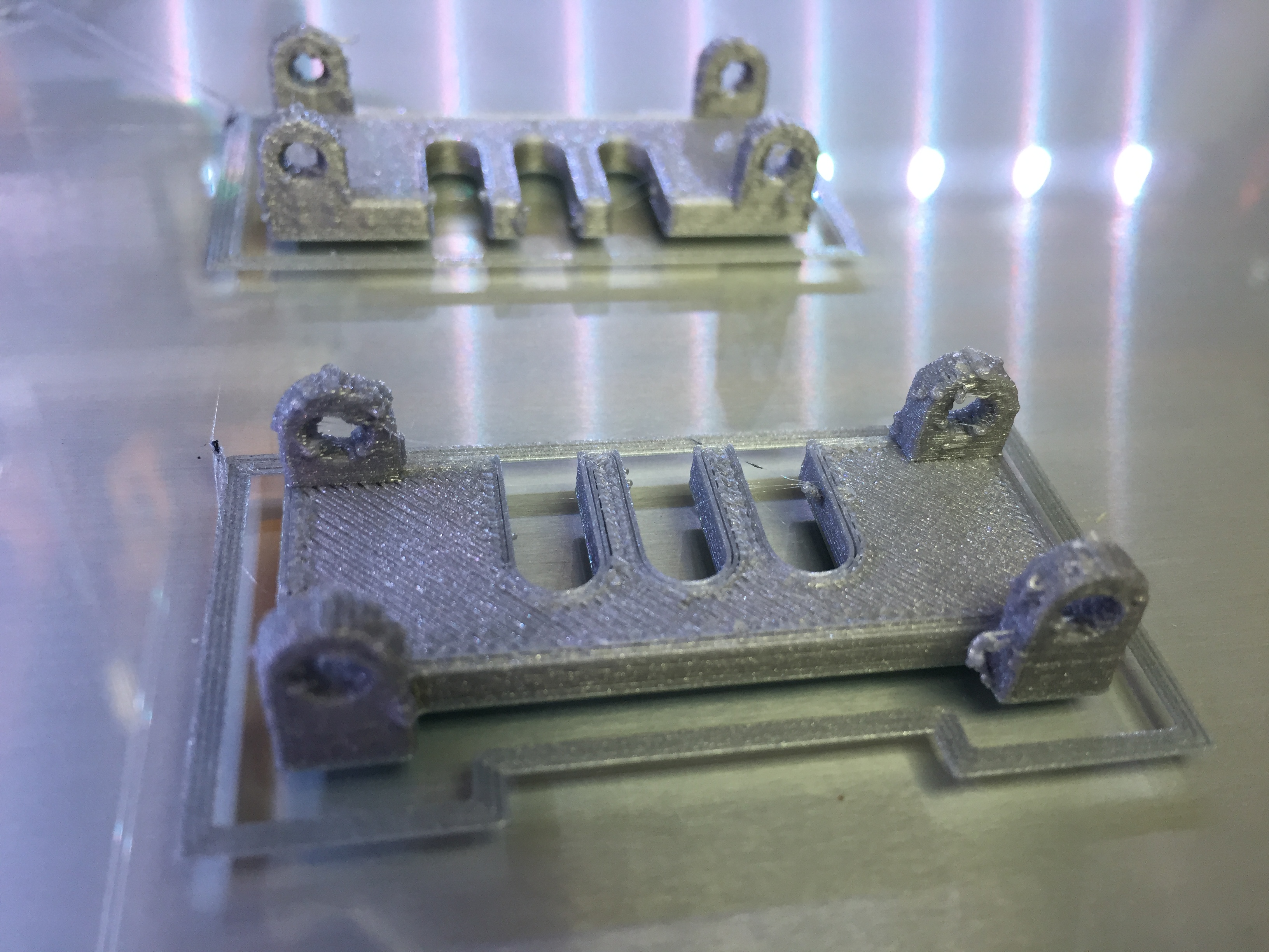

Well my second try at the top pieces for the shroud mount came out lousy in CF. I cooked the printer to 150 and tried to gently slide it out of the print head. I heard a snap...the filament snapped in the teflon. Ah fun
I put the nGen in and heated to 230. Thankfully the CF started to ooze out and the pressure from the nGen made its way thru. Wow. This stuff has some really nice flow!
Since I have no fan I decided to print the two parts at the same time. My thinking was maybe the pause between layers would allow enough cooling.
I went with the Cura settings from ColorFabb. I also went with 235 since you mentioned that was a good range for your printer.
Layer wise (and with the ruby's help), it looks good. I wonder if my vertical structures are due to no fan or too hot?

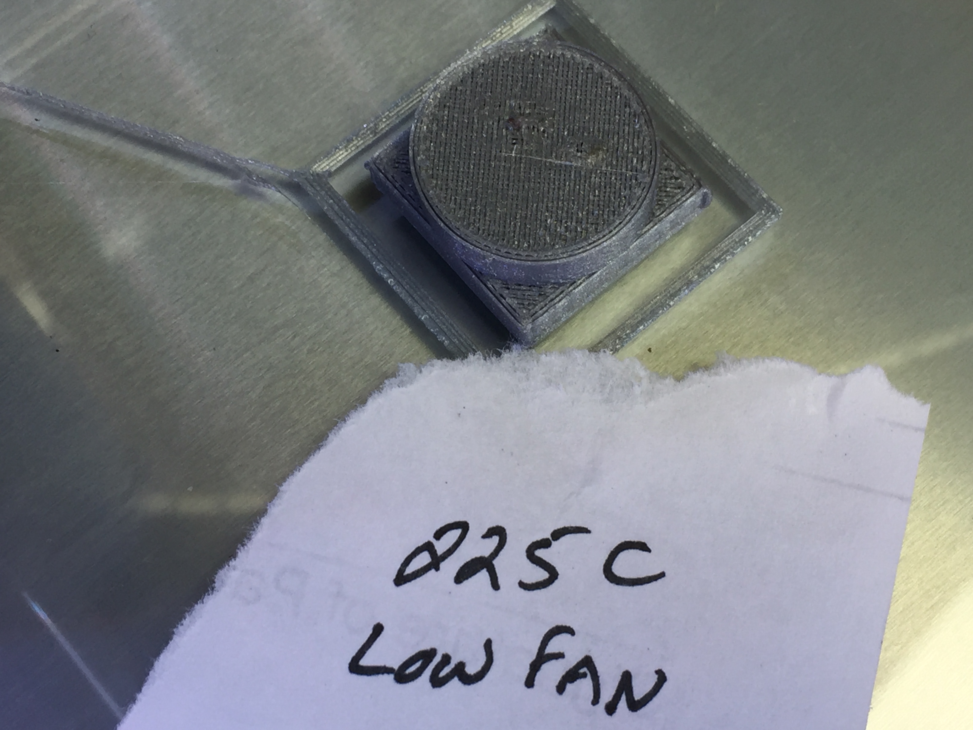

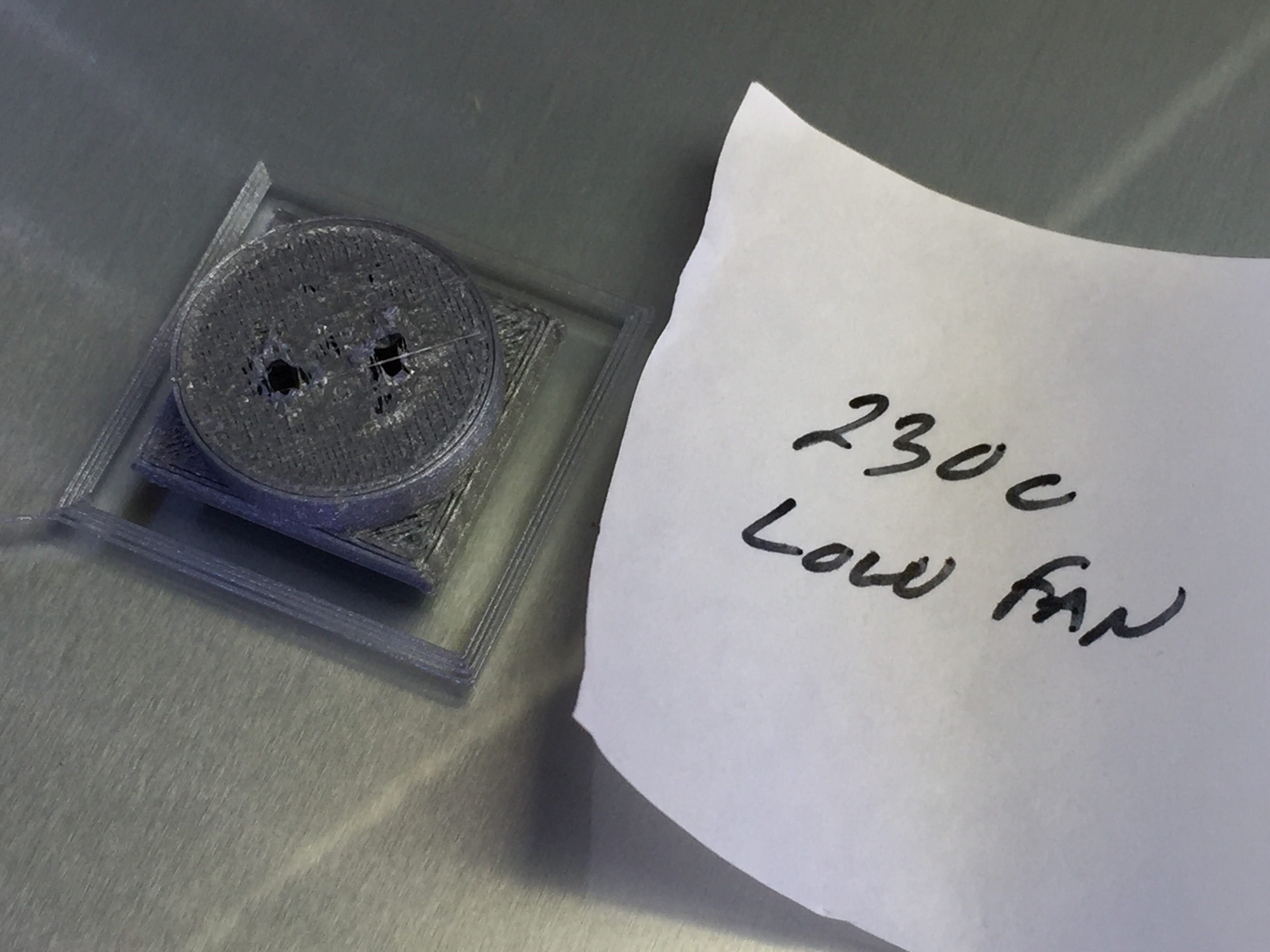

I did some searches on nGen and some guys reported best luck printing much cooler. I tried 220 and it wouldn't come out the nozzles.
225 seemed better. Fans on low (as best I can gauge them) 40 mm sec
Then 230, again low fan. Decided to try printing at 45mm for this
I know 235 worked ok but wow this stringing is frustrating
