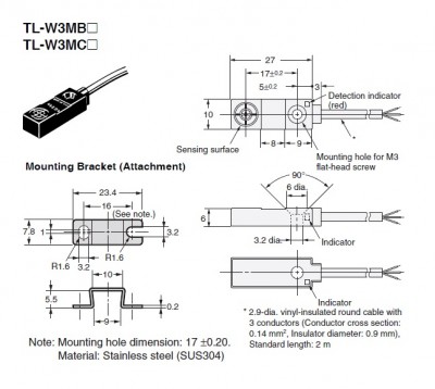

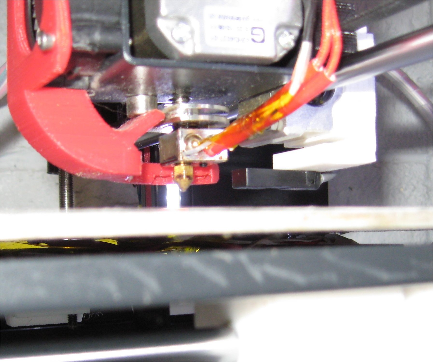

In link above have a picture where changed the SN04 sensor to a TL-W3MC2 you look in the Image on the white Mount you can see the spring.
The newer White mount allowed me to get the sensor with 20mm of the nozzle.
Oh!! Also added a Heat Shield as seen in image above. With a new duct work to cool the throat.

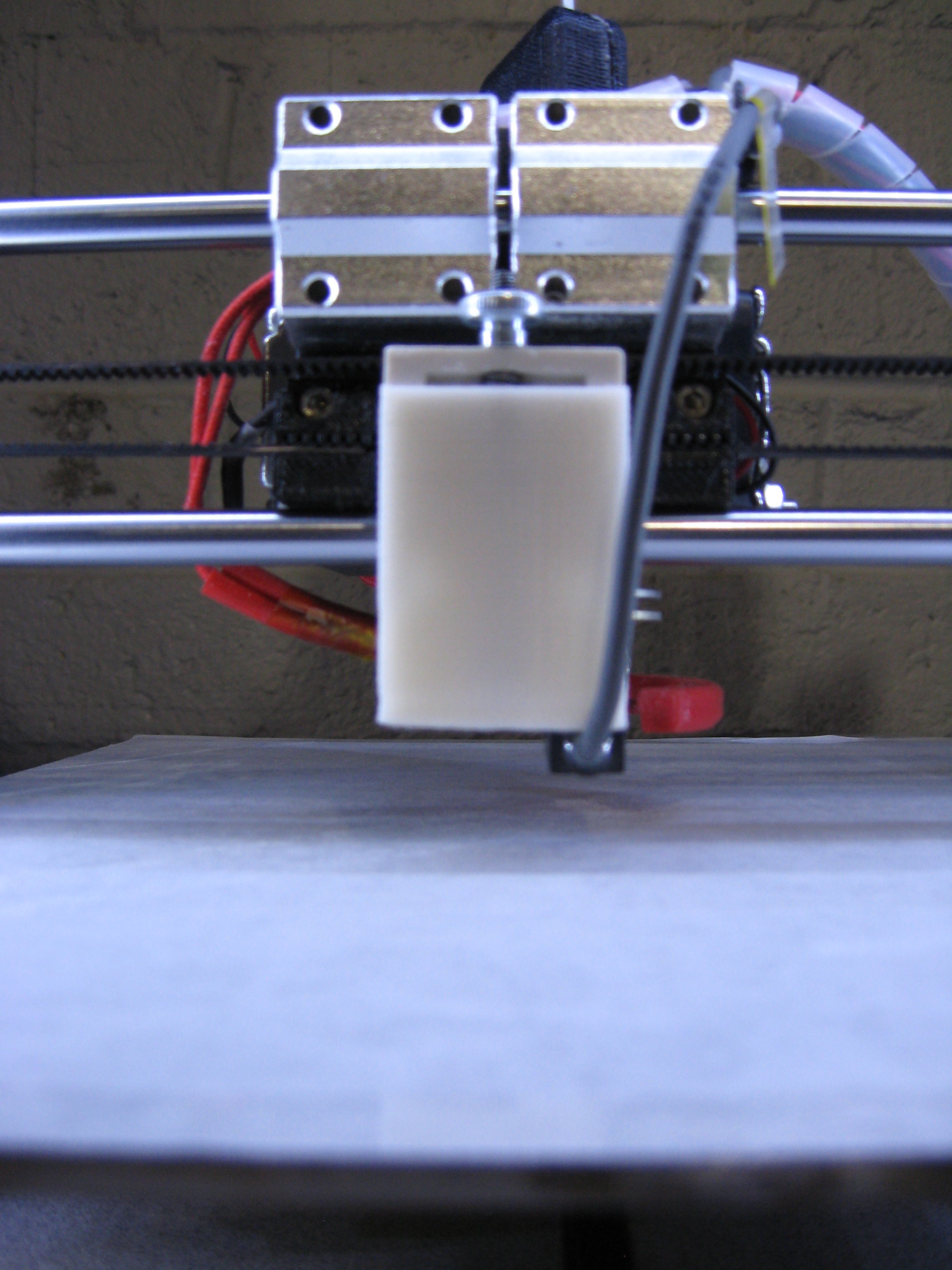

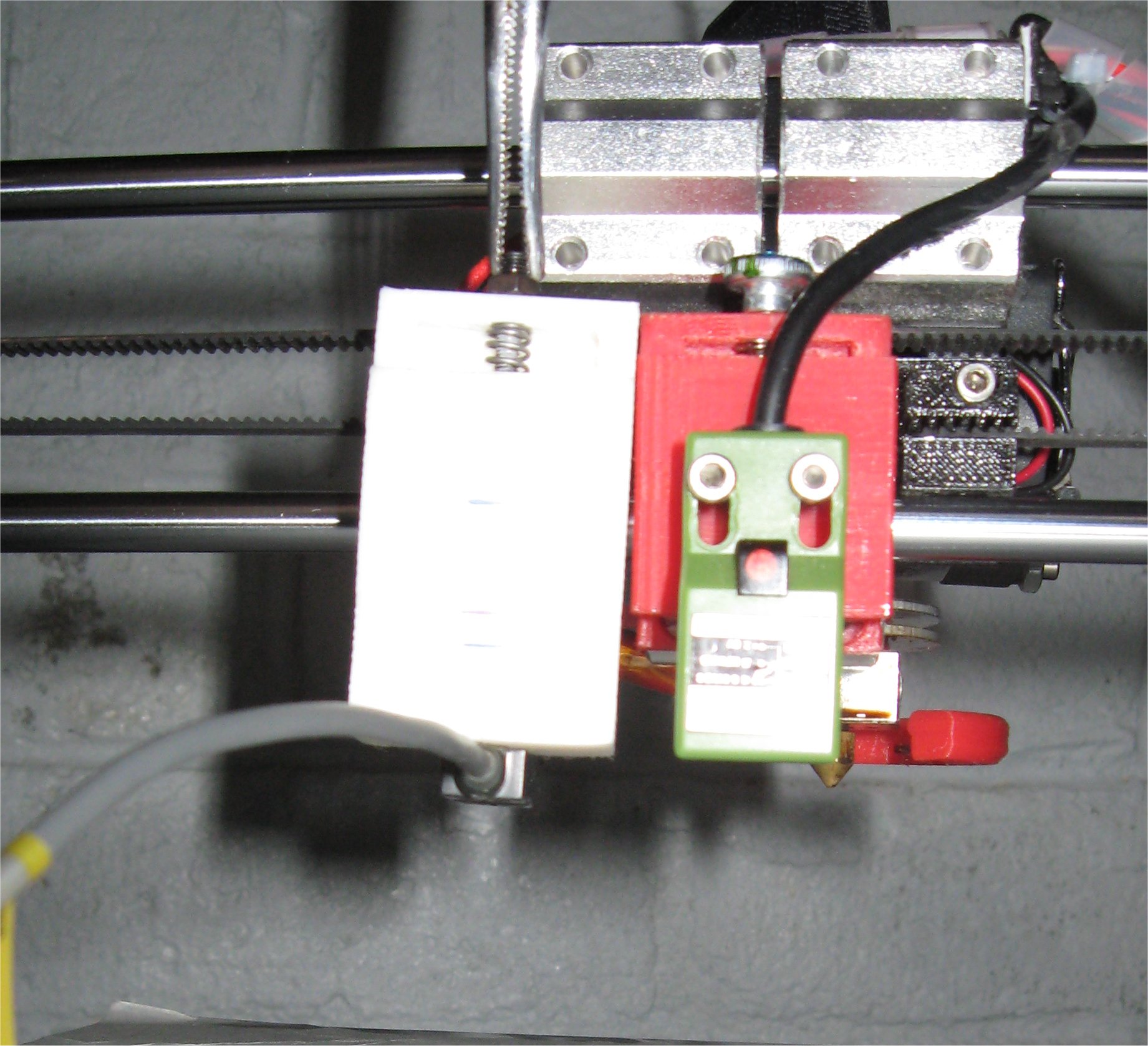

There is nothing wrong with the Stock SN04-N Proximity sensor. Just 3D Print a manual thumb screw mount for the Sensor.
I hated it also that is the only reason I changed to the TL-W3MC2, you may not like this setup either though.
Note moved the Sensor to the side to be directly behind the nozzle.
An the Thumb screw adjustment for fast calibration.

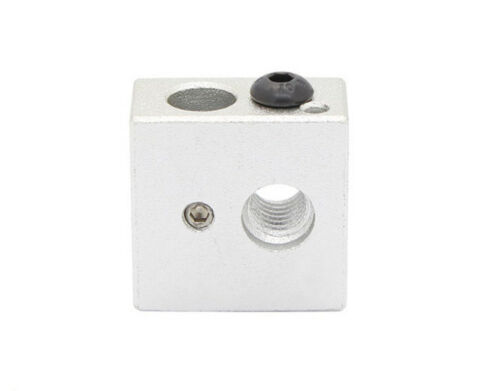

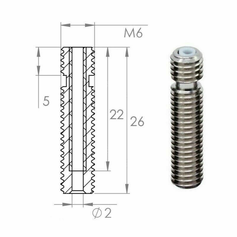

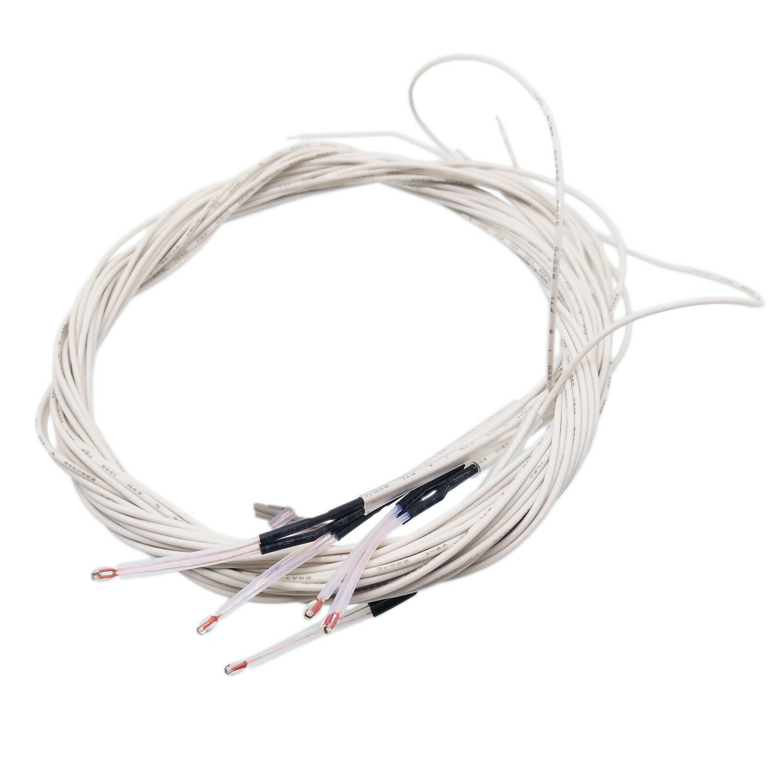

Do you have any of these consumables for your Hictop 3D Printer.
Throats, Nozzles, Heaters, heat blocks and Thermisters
Heater Block.jpg (8.64 KiB) Viewed 24711 times

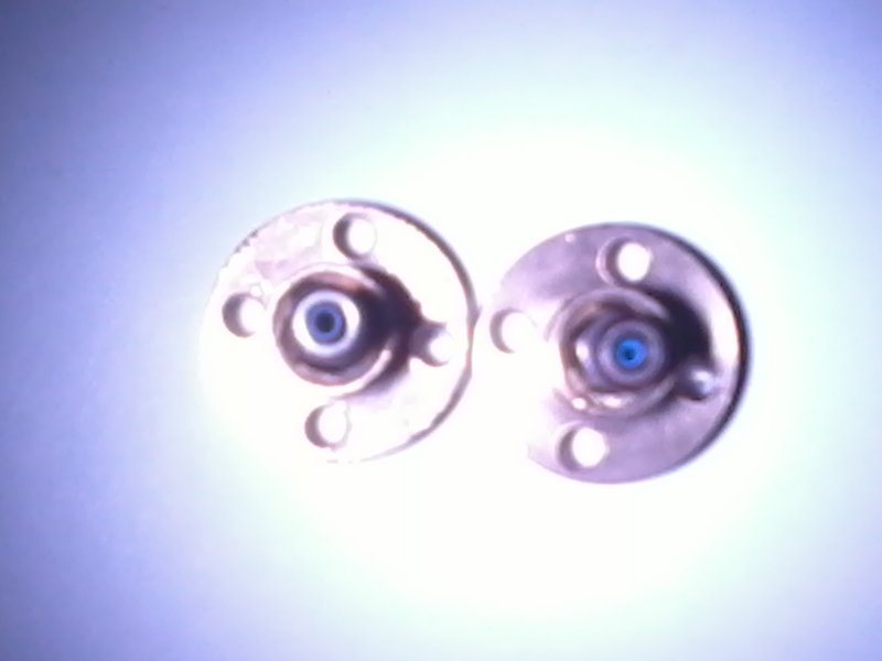

The photo below showing throat PTFE shrinkage needing replacement In an aerial view of two Throats.
The Left is new and as you can see a perfect opening
The right is showing shrinkage and partial clogged is the old one.
Note they a standing is a Lead Screw Nut.
