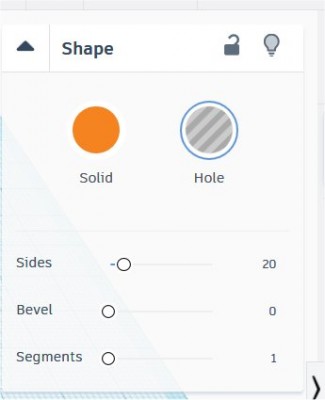

First Create the 20mm cube, then create the 15mm cylinder 18mm in depth.
Using the Align tool Raise to the Height to the Top of Cube then center models.
While the two are still selected group models
Test 1.jpg (14.25 KiB) Viewed 11328 times
Can also adjust shape characteristics

I have managed to do a cube with a whole in it so going to print now. I will let you know how it goes
Re: Printing as a solid when it should have an open top
Posted: April 28th, 2020, 3:16 pm
by Roberts_Clif
RodB wrote: April 28th, 2020, 12:34 pm I have managed to do a cube with a whole in it so going to print now. I will let you know how it goes
How many sides did you give the hole.
