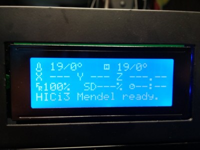

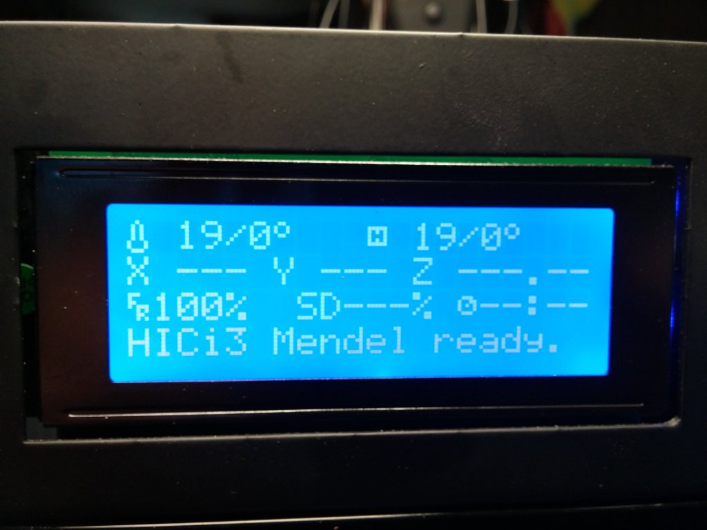

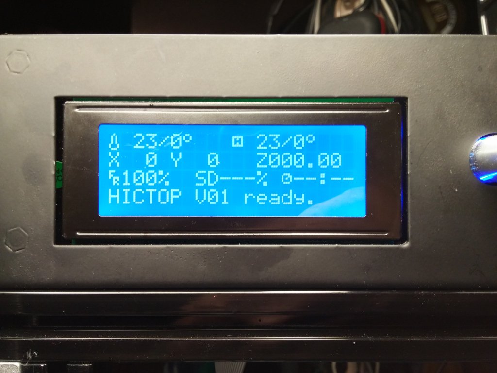

Re: HICTOP - Software : Merlin re-complie = success!
A Mile Stone has been set!
This morning I received the 'most recent' HICTOP source code from the manufacturer. After that I spent 4 hours fixing someones syntax and obvious errors in source and re-compiling some very basic errors until the firmware was clean:
o change 6 lines of code in temperature.cpp from: ( #ifdef AAA && BBB >= 0 ) to ( #if AAA && BBB >=0 )
o few left over 'debug' defines that were not supposed to be there in Marlinmain.cpp and Configuration.h
o setup configuration.h parameters, et. all for the HICTOP Pruas i3 3DP11(12)
o it works great!
Hey, it's all from China!
Anyway, ready to run this thing. EEPROM can be written, default settings are no problem now:
New Home screen on LCD:
Now to finalize settings. At least will not have to re-enter defaults every-time the thing is powered on! God thank the maker...

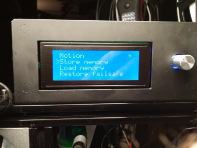

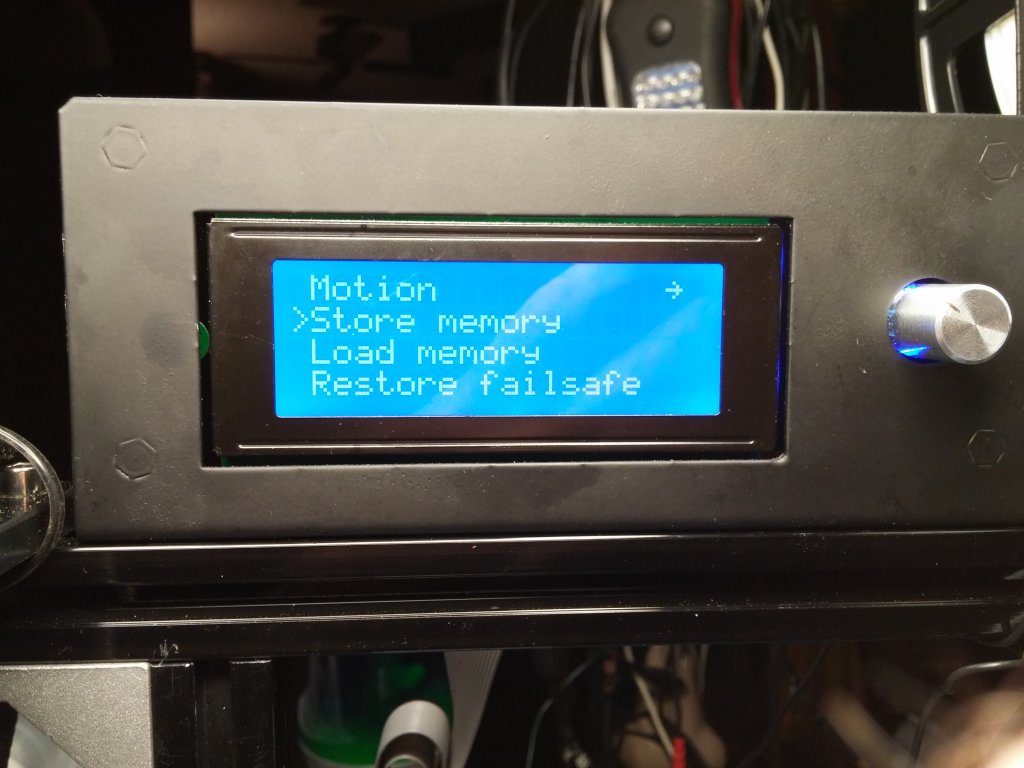

Done and working. THANK YOU...martin-bienz wrote:I think in this case I would try to re-flash with the latest version of Marlin, with a configuration.h that makes sense for your printer... (I hope the manufacturer could give you a "preconfigured" version)?
I quickly checked that guys config.h that I found yesterday (https://maggiemcfee.com/2015/11/29/hic- ... or-marlin/), and he has eeprom settings disabled (as shown below). You could theoretically take his other settings, transform that into a fresh Marlin copy and then change those paramters:
You can see that EEPROM_SETTINGS and also CHITCHAT are commented out, those should be enabled.Code: Select all
// EEPROM // the microcontroller can store settings in the EEPROM, e.g. max velocity... // M500 - stores paramters in EEPROM // M501 - reads parameters from EEPROM (if you need reset them after you changed them temporarily). // M502 - reverts to the default "factory settings". You still need to store them in EEPROM afterwards if you want to. //define this to enable eeprom support //#define EEPROM_SETTINGS //to disable EEPROM Serial responses and decrease program space by ~1700 byte: comment this out: // please keep turned on if you can. //#define EEPROM_CHITCHAT
I would do that for you but am scared that I destroy your 3D - Printer...

You are very welcome.Chip Luck wrote: Done and working. THANK YOU...
Well done! Feels good to have flashed your first marlin, right

[edit] 03.20.2016 : happy camper! Merlin 1.1.0-RC3 on HICTOP i3 now working wonderful! See latest in thread...

Re: HICTOP - Software : Merlin 1.1.0-RC3 completed!
Finally, after a few days of review, research and coding my HIC i3 is performing wonderfully!
Made a re-start after trying to debug the 'China' supplied source code for the HICTOP i3 printer. Decided to go with the official version of Marlin from Github. Used the latest stable release of Marlin 1.1.0-RC3 as the base source code to edit the configuration.h and other header files, also tweaked a few settings in other source files to bring this printer to life.
So far:

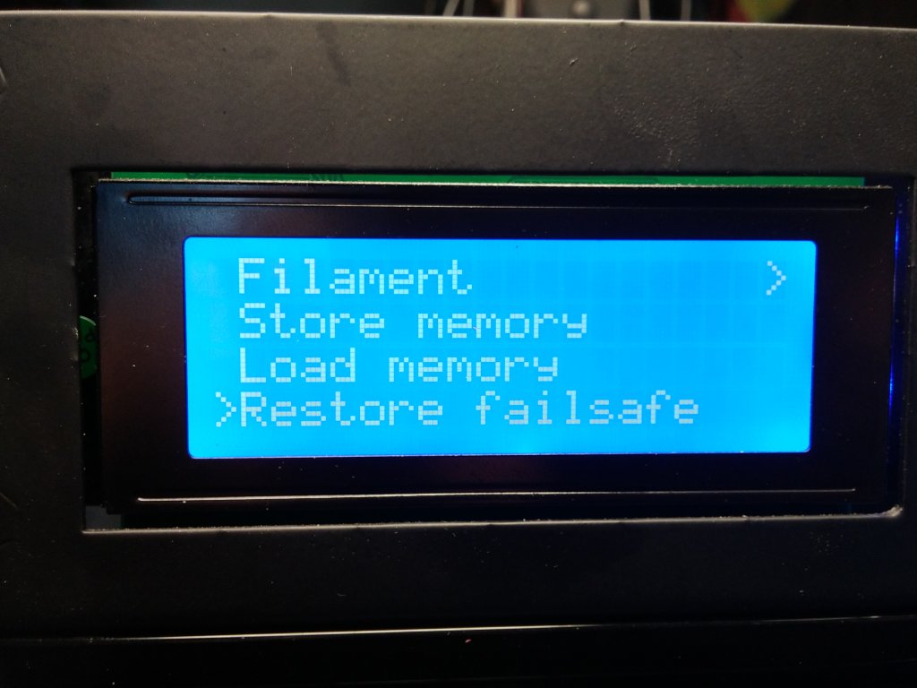

o SD card support is 100%, you can now remove/insert the card at anytime and all files on SD card are now accessible. No more need to power off the printer, insert the card and power the printer on to be able to read it. =FIXED
o LCD rotary control has been improved, the steps with the rotary dial have been fixed, you now have better fine control over the settings, before it was about 5 steps in software per 1 step on the control, made it difficult to fine tune speeds, accel, or temps. =FIXED.
o USB communication with IDE or HOST software no longer 'drops data', nor has any more issues with lag, port issues, etc. =FIXED
o EEPROM write function enabled, now can store parameters into the EEPROM with HOST software or the LCD panel. This is a big time saver! =FIXED
o Defualt HIC i3 default settings on boot now stored. Another time saver. =FIXED
