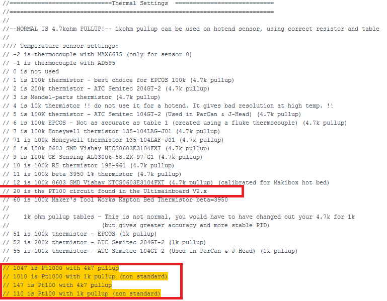

One small note: the amount of PT100 selections at the end (in the builder) is a bit confusing.
The parameter in Marlin changes, but in the tool it's not that obvious.
Any ways to fix that?
Re: UMO / UMO+ Firmware

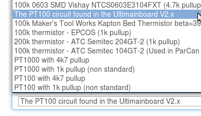

Post by Amedee »
You mean the wording for the 3 different PT100 entries?
pt100's
pt100's
The labels are what I found in the comments in the firmware -- for most of them I don't have any clue on what they are :roll:
We can put whatever we want, I am open to any suggestion if somebody have a better wording.
Alternatively, we can give a hint under the combo box: 'For the E3d adapter you need to select the "pt100 as on UM2 boards"' or something like that.
antiklesys
Posts: 183
Post by antiklesys »

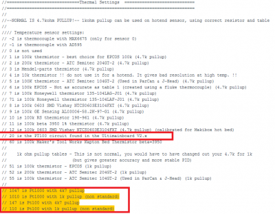

I agree with you, it's hard to understand the difference, BUT by testing it out...there is a difference.
My advice here would be to put the codes next to the names:
So you would have 20 for the UM2 (or PT100 with E3D on UMO), 1047, 1010, 147 and 110 next to the others just to differentiate.

antiklesys
Posts: 183
Well that's true and false at the same time.
For instance: when following E3D's guide for PT100 installation they mention to set the temperature sensor to 20 in Marlin, so for similar situations it "may" help
